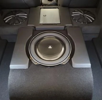

Don't own a supra yet but will by the end of the year. Some of the first things on the list to upgrade is the subwoofers.. looks like it's 2 10's stock? I'm guessing no one has made custom boxes for a single 12?
I don’t think you could fit a 12” in the deck space as is. The box dimensions would likely have to increase and you have to modify or dance around the rear floor panel that you need to leave access to for the battery. If you put a box in place of the existing woofer deck, the height will likely need to increase or you will have to remove and relocate some ECUs under the existing deck.
The 8’s play to around 200-220Hz and the crossover is pretty steep as best I can tell (not very well). So you will either need to run the sub with the mid-bass or do dedicated drivers for that range.
They're 8's not 10's... @JasonO has a custom box in this thread... perhaps you missed it? ;)
You made any decisions yet or still waiting on a few more guinea pigs to iron out all the issues? :D
Not a 12 but I made one for a 13...

Interesting, I was hoping it'd be able to replace the current one somehow but didn't know they were 8s. How much trunk space do you have left over with that 13?
I would say the box took about 1/3 of the space under that flexible cargo shelf.
