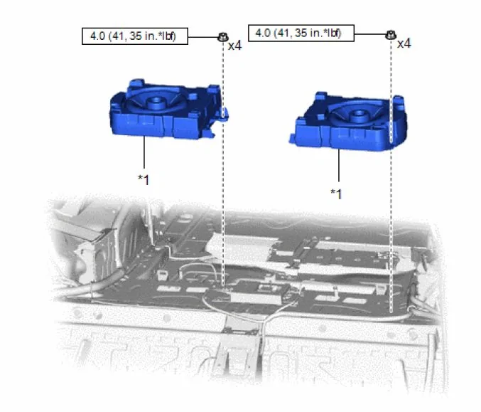

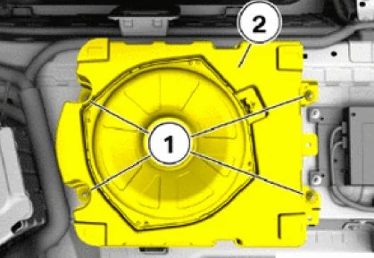

For those that have removed the rear woofers do you happen to have pics of the underside of the enclosure? Is this enclosure sealed?
