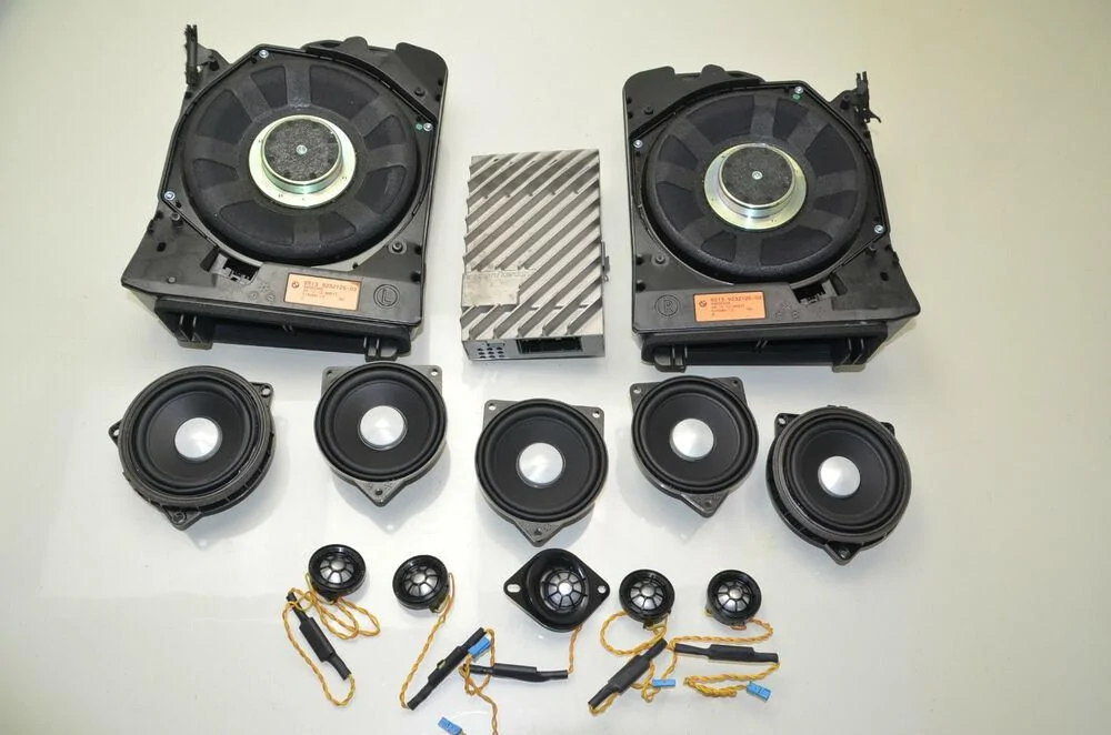

you will be surprised...not hard at all.. just time consuming...ā€¦bellow is basically what you have in the supra!!!!!

Looks like I'll be waiting for this, but I imagine replacing those stock subs will not be an easy task lol especially getting them out of that box.
Buy a trim tool kit, a few rolls of TESA tape, and some foam tape before you do this. Most of the rattles I had came from the panels you will have to pull to do this.
Insulation coverage is terrible back there as well. So if road noise bothers you, this would be a good time to address this area.

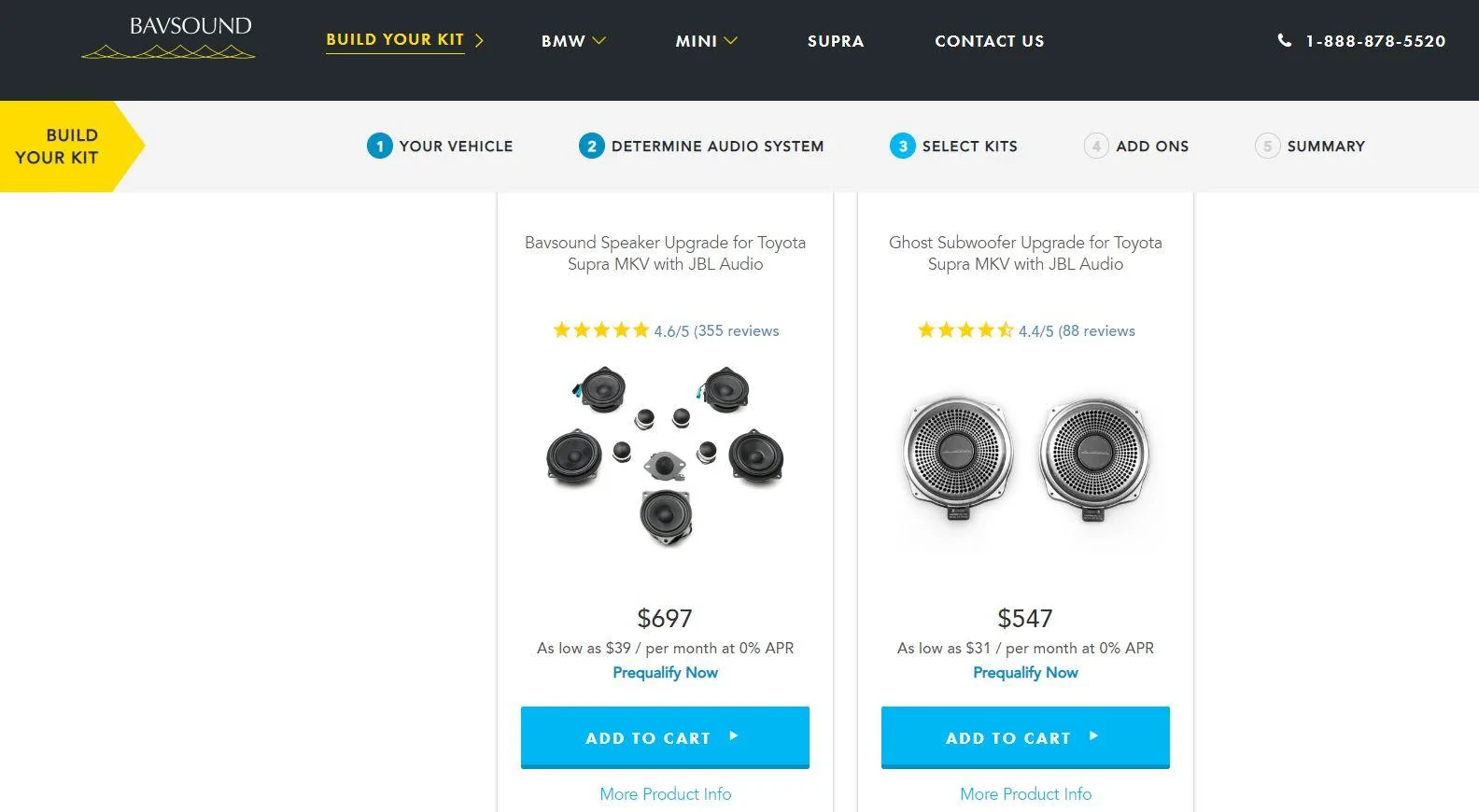

Bavsound speaker replacements along with subwoofers for the Supra are now available to order on their website..
Bavsound

been there done that! over a month ago, just need the rcorrect amp kit!!!!
Yes..we know...ha!
So you also replaced the OE rear subs with the Bavsound "ghost" subs as well? How well do they sound with the OE amp?
I'm thinking I may just replace the OE rear woofers and upgrade the amp when it's available...
