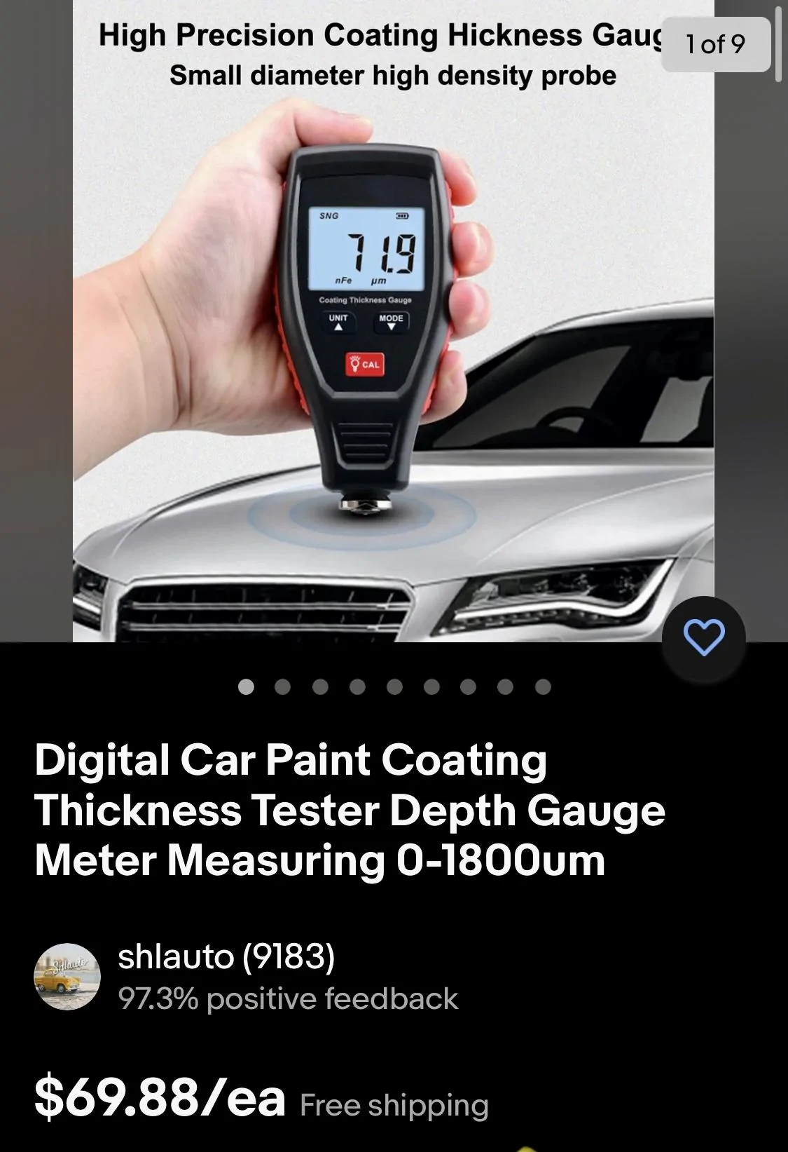

Spend $99 on an electronic paint gauge… they don’t lie if paintwork or an accident has taken place prior. Even happens to new cars. I passed on the first one. Even more important on a used example.

The paint gauge is a huge tell if work has been done. Look at panels for the gap and if they line up right. Confirm if any mods have been done that may cause a state inspection issue or warranty issues. Carfax results(not 100% accurate but help tell a story)drive it
