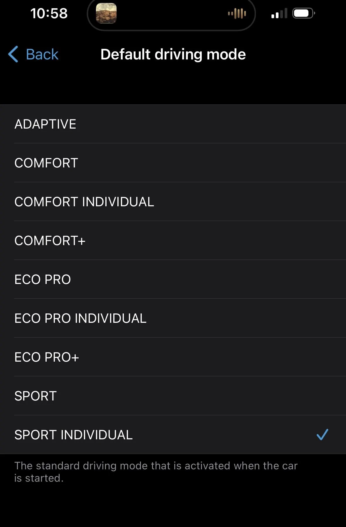

sdavidson0316
Shannon
Nov 13, 2023
Charlotte, NC / Lake Wateree, SC
ā€˜20 3.0 Premium
st00pid n00b question, please:
I just bought my car and it always starts in sport mode; I’d rather select that for myself. Where are these settings (start mode, tranny mode, steering mode) you are all referring to, or is that in the tuning?
Mine is tuned by Visconti on EcuTek and I haven’t yet learned what all is in there vs elsewhere.
Thanks for tolerance!
bushido
Oct 31, 2022
941
1,722
Miami
yes
https://bimmercode.app/
https://www.amazon.com/OBDLink-Bluetooth-Professional-Grade-Diagnostic-Performance/dp/B07JFRFJG6
choose Z4 as selected vehicle. body domain controller --> driving mode --> default driving mode.
you can search "bimmercode supra" on youtube. i believe i previously used thiccwhips' vid.
https://www.supramkv.com/threads/supra-coding-step-by-step.2866/
sdavidson0316
Shannon
Nov 13, 2023
ā€˜20 3.0 Premium
Can someone help me with what the Supra Normal mode is for me to switch back to? I’ve watched a few videos and read a few threads and everyone talks about how to get to sport mode but doesn’t say what the default is.
Here are the options:
J29DB03
Dec 14, 2021
2,300
4,679
2021 3.0
Comfort. Comfort = Normal for the Supra.
