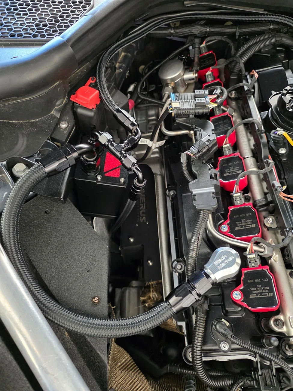

@mustafazumit has tons of issues with his, and filling up fast with DAW ultraflow X at 30 psi
Yes I did have issues and my first recommendation is running the oem CCV line since it has a 1 way valve check.
I happened to crack my valve cover which caused a lot of smoke on decel and my catch filling and spitting oil in matter of secs.

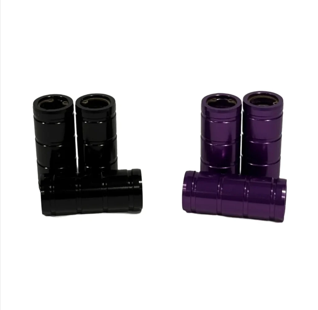

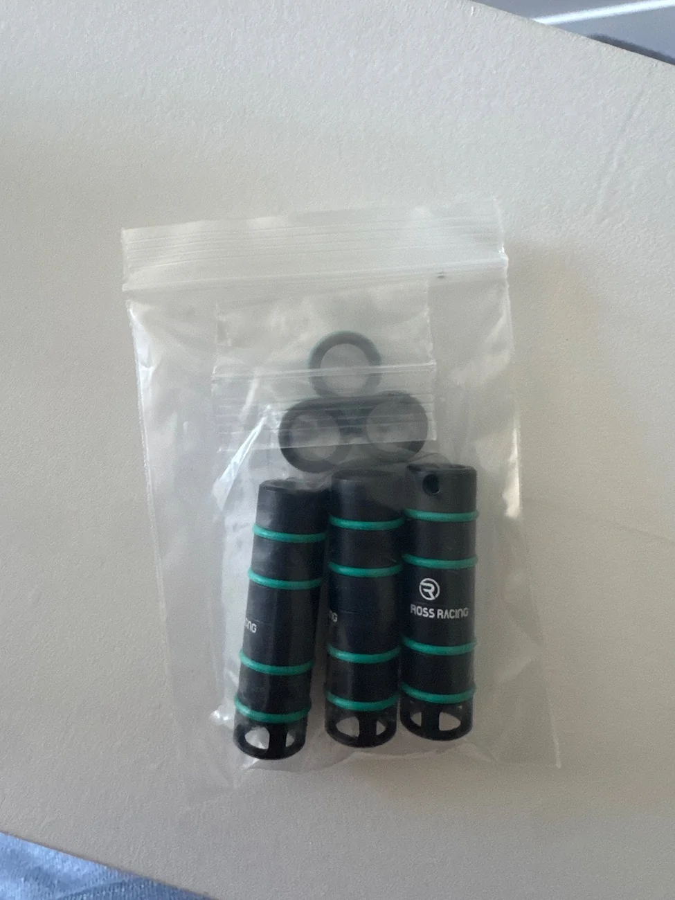

I don’t recommend the block off pins from bmr. check out ross racing check valves which are much better.

Interesting. BMR specifically told me to block off the CCV line once I installed the PCV Pins, otherwise the CCV line would fill the can with oil (and its not needed once the PCV holes are blocked).
Thank you sir.
Yeah that seems to be the way to go once the pins are installed. thanks.
I take that back. I just looked at it again and I did plug the CCV port on the block.

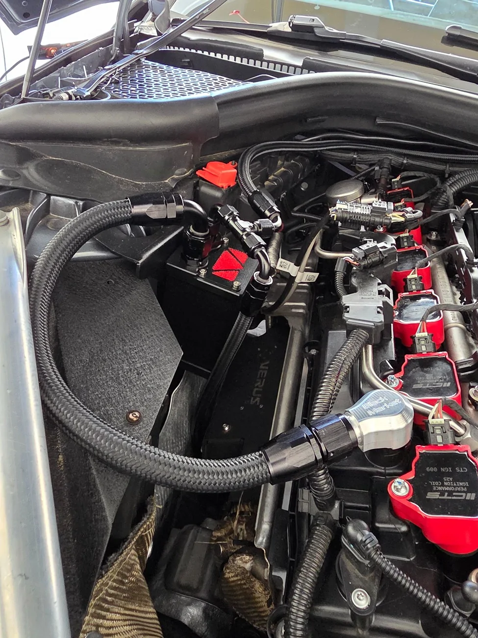

I originally installed the VS PCV head port check valves. And BMR vented oil cap. I added a 1pound check valve to the oil cap and made a line to an Amazon catch can. It never had any oil in it. I have been getting smoke out of the exhaust ocassionally.
I just installed the BMR catch can and I think I'm going to leave the 1 pound check valve attached to the oil cap line and block off the ccv line.
What do you all think, I just don't know enough about it to say one way or the other is correct.
The VS block off check valves didn't come with gaskets like the ross racing ones, so now I'm worried.

I do not have the PVC ports plugged, i think ill be going with the Ross Racing Check valves tho. And Yes full BMR Catch can setup
