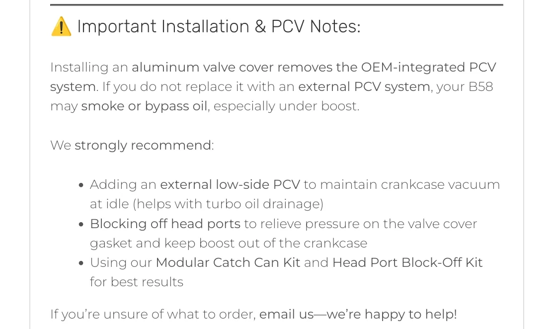

I think a lot of people think the CCV line is for venting.
I like what Ross Racing has to say on their listing for the valve cover check valve pins.
I'm not so sure that blocking the ccv is the correct way to go and I don't think leaving it with the free flowing line from the BMR kit is right either.
I think I'm going to put the OEM ccv line back on.

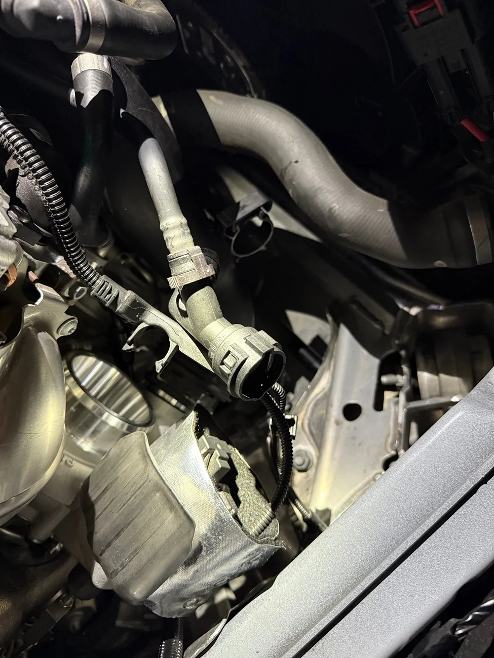

Hey guys I’m installing a pure900 and the BMR catch can. I routed the PCV and CCV to the can but what do I do with the PCV that went to the turbo inlet? It went to the same spot the PCV heater was at but since that’s deleted I’m not sure if it’s something I can just block off now or what?

Should be pretty similar to their video instructions, you use the lower piece of the CCV tube and block of with hose caps you can buy from a local parts store. Don't use their CCV line, it will cause smoke, just use your OEM ccv line.

The only discrepancy I found was in their video they hook the PCV heater line back into the stock turbo inlet but I don’t have one on the pure 900 setup.
I’ve read that too about smoke but where would I route the stock CCV then with the pure 900? They deleted the port it would go to, their turbo inlet is one solid piece.
