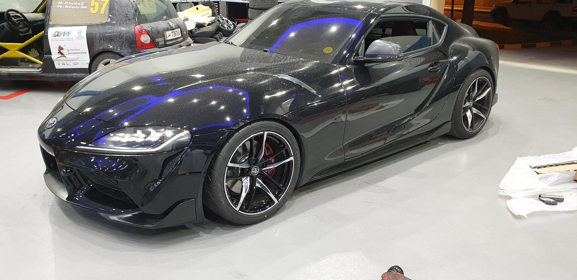

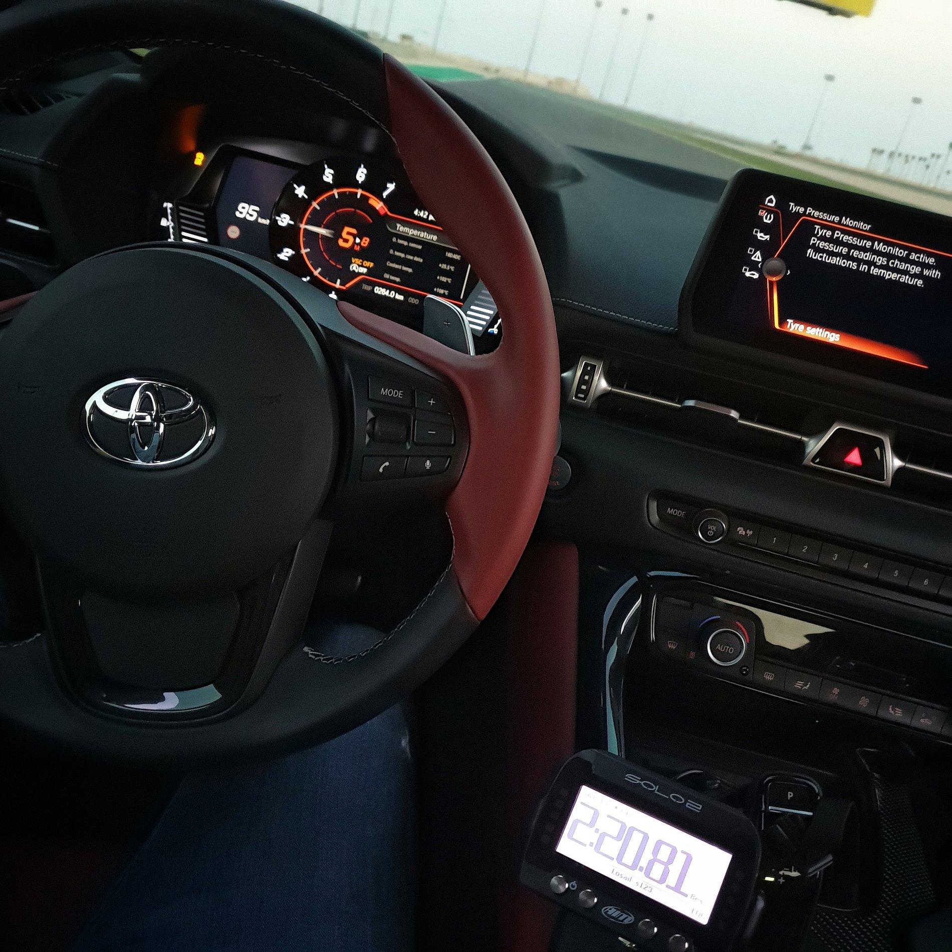

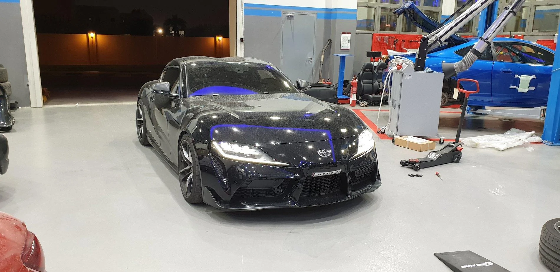

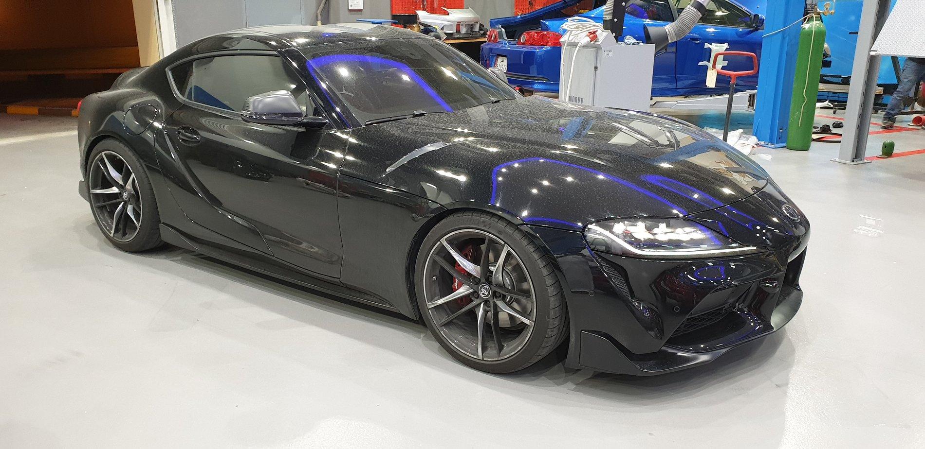

Took the car to track yesterday. This time I installed the H&R springs with 18 mm spacers all around. Re-aligned the Supra after the ride height drop as it gained more camber.
It was interesting to see how it will affect the feeling on track compared to the stock setup from last track day back in Sep.

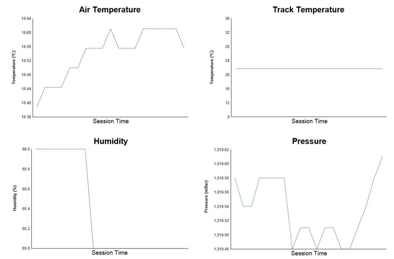

Ambient temperature was 66 F (92 F last track day)
Max speed on the straight was 135 mph last track day compared to 138 mph, so the car is much happier in the cold and you can feel it.
Not only was the car faster on the straights, now its faster everywhere. I can carry more speed in corners and it felt more stable with some understeer in few corners, however there is still some body roll. The H&R springs helped but still it can be a bit stiffer. Also no limp mode this time!! Max oil temperature was 236 F during a full 20 minuets session so I had the chance to do more than one hot lap this time.
Considering all the above the car was 3.3 sec faster than stock! To do 2:21.6 around Losail is very impressive for a car in this class. I am confident now that it can go high 2:20 as is with a cleaner lap.

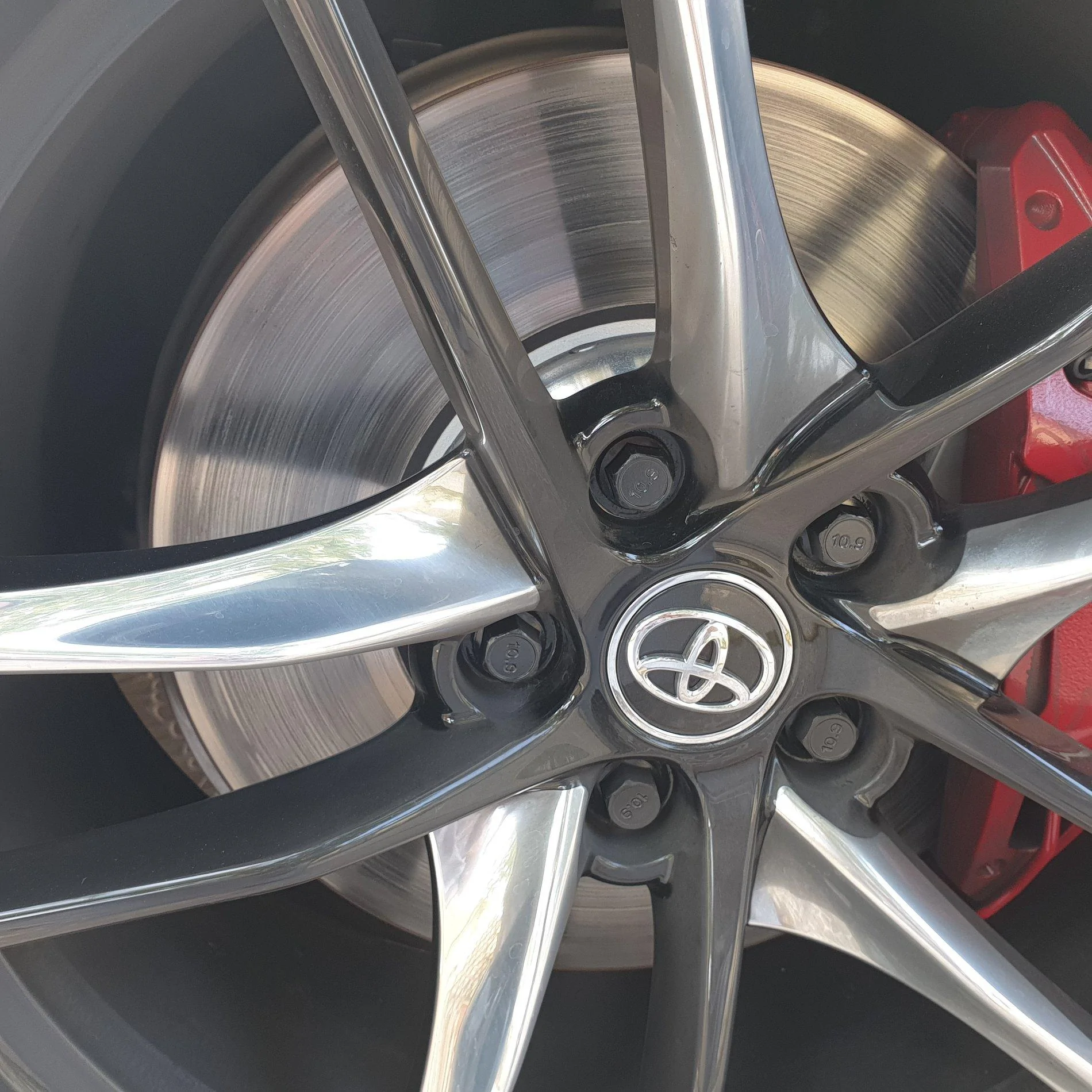

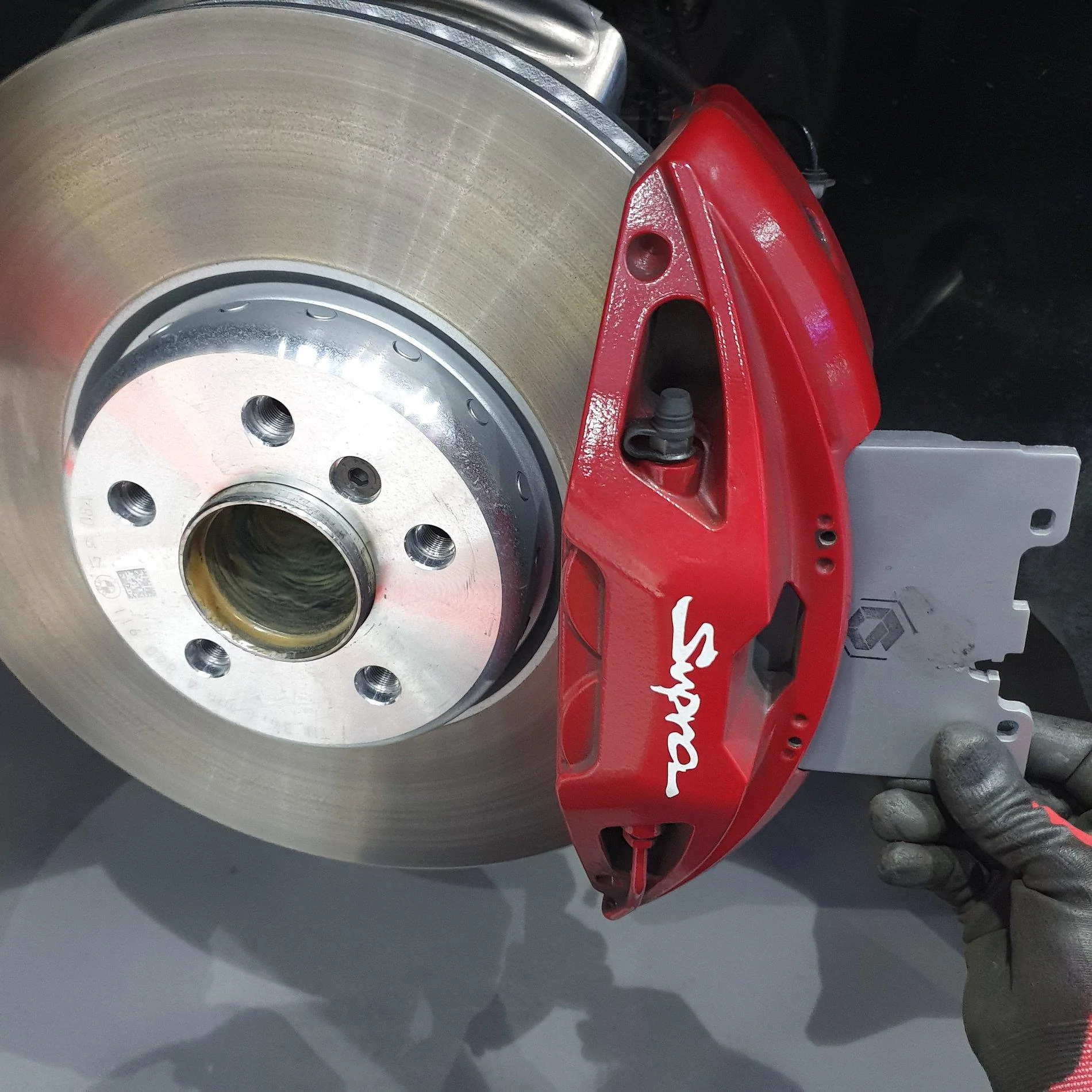

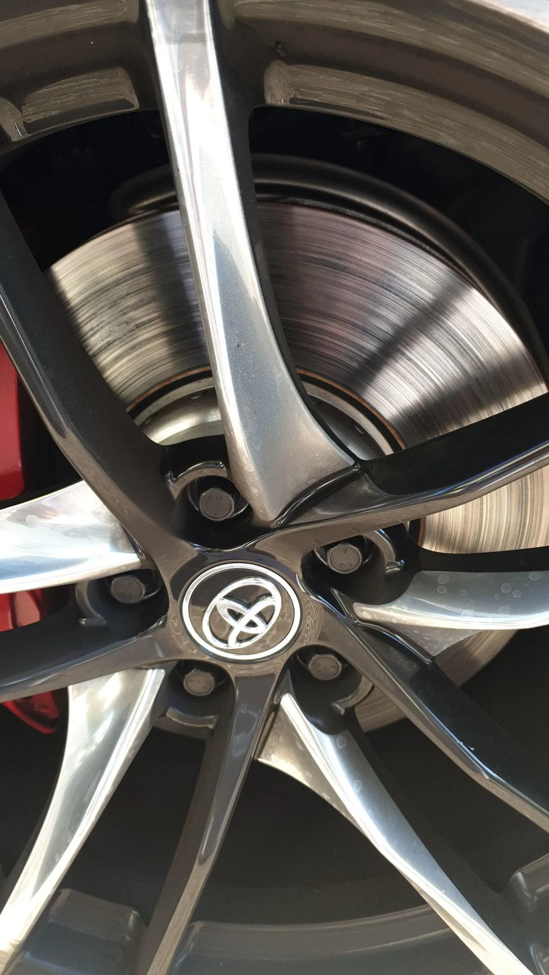

After three 20 minuets sessions this was the condition of the rotors. The car had stock brake pads and factory brake oil. Can someone tell what happened? Cooked? Pad deposits?
For next track day I will be installing CSG C2/CP pads with brake fluid.

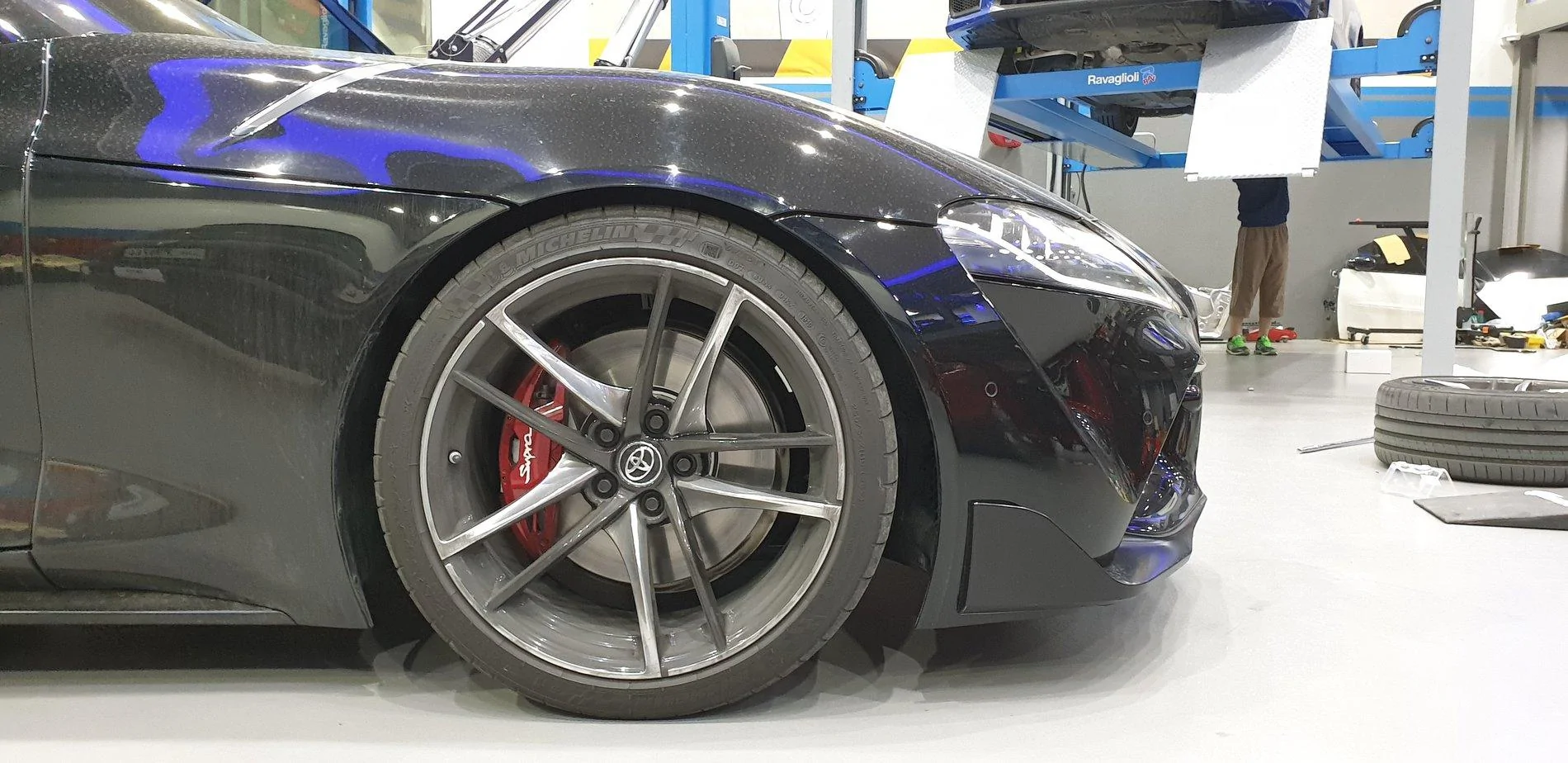

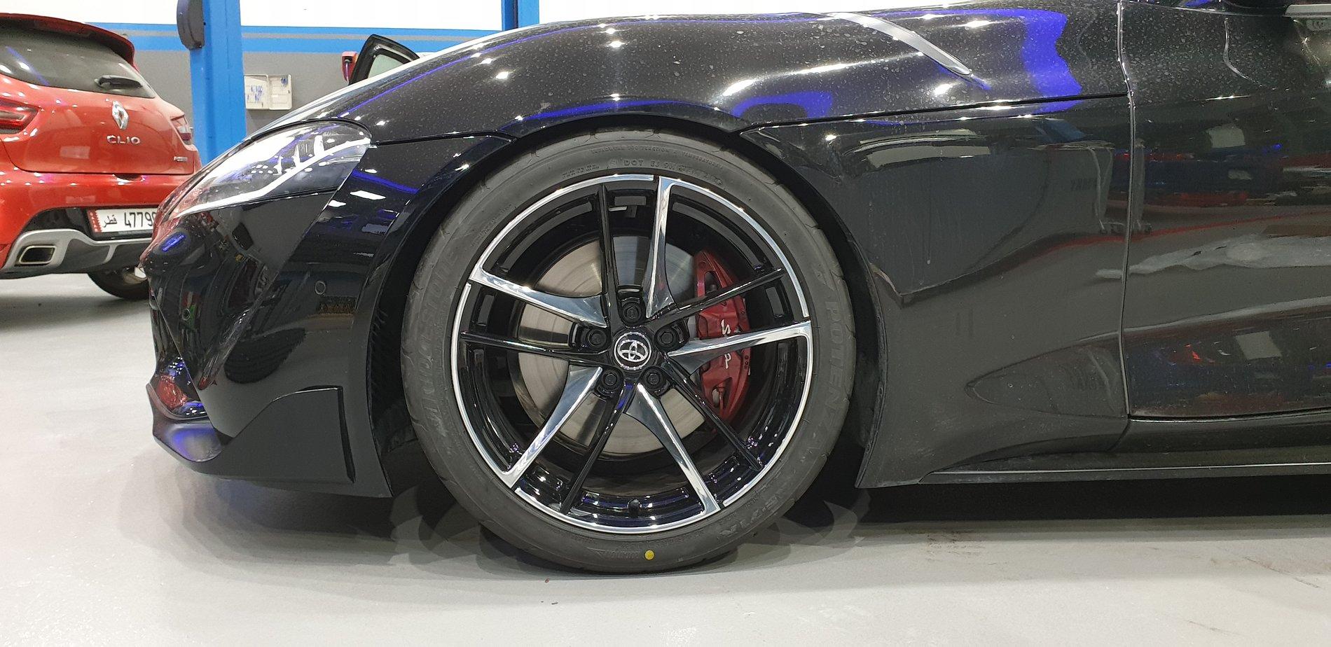

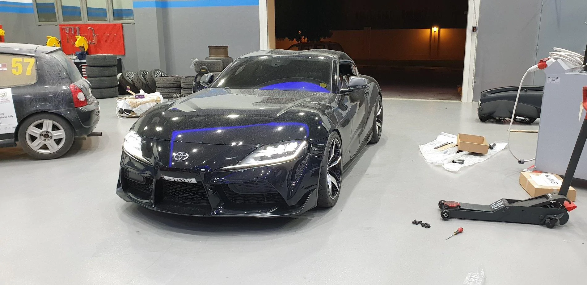

Trying to fit the rears in the front to check the clearance for square track setup.
Looks like it will rub on compression at track with current camber settings. SPL arms will solve that.
This side has the square 19x10 with 18mm spacer in rear and 13mm in the front.
And the other side has the 19x9 and 19x10 with 18mm spacers.
Good news is that it does not rub from lock to lock.

Took the car to the dealer and got the rotors replaced under warranty, then installed CSG pads. I also replaced the brake fluid with RPF660 and installed smaller spacer in the front (13mm)
Manged to shave 0.8 sec with the new setup. Braking is improved with no fade, good modulation, easy on the rotor.

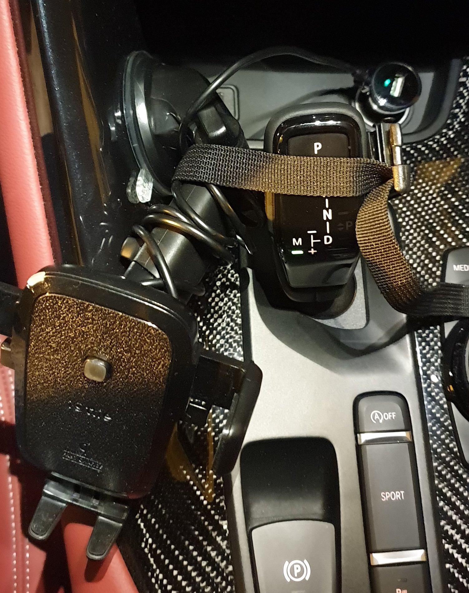

  • Shift lever jumping from manual to auto under hard cornering
  • Small fuel tank
For the shift lever, my current solution is this

On the things you hate the number 2 & 3 have you researched how to full disable the stability control and why the shifter moves from manual to auto?
Darth
Darth
Ali
Aug 19, 2019
169
292
Losail, Qatar
02 S2k, 09 Aerorace, 07 Y61, 14 1500 Denali
Unfortunately there is nothing out there and its a new platform so all I can do is adapt for now and to be honest I don't notice stability controls kicking in as hard now. Maybe because I got used to it or from the different setup (more grip)
For the shift jumping into auto under hard cornering (left handers) I think its because the spring or shifter mechanism holding the shifter in manual is a bit soft. As far as I know I am the only one with this issue since no one is complaining about it.
