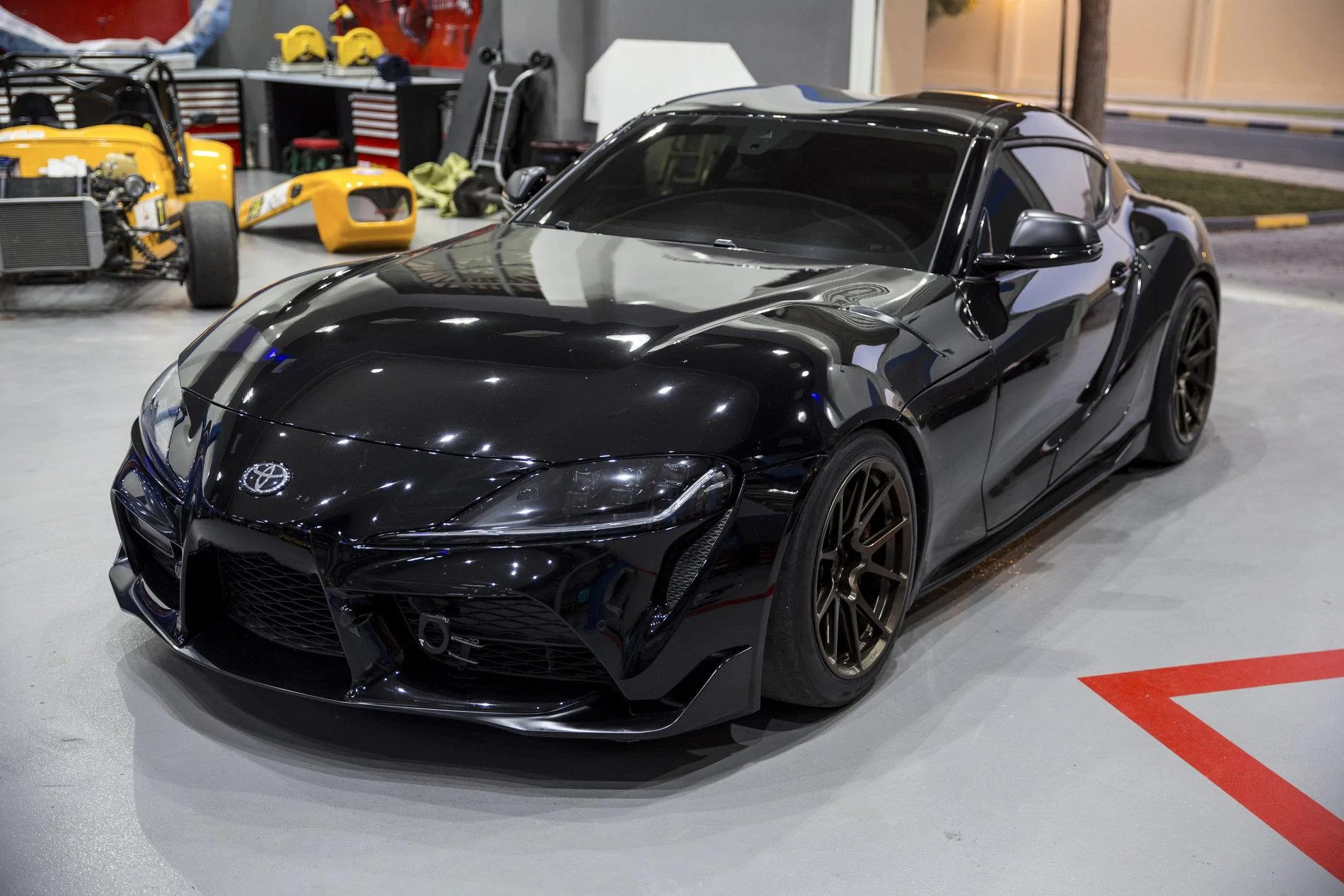

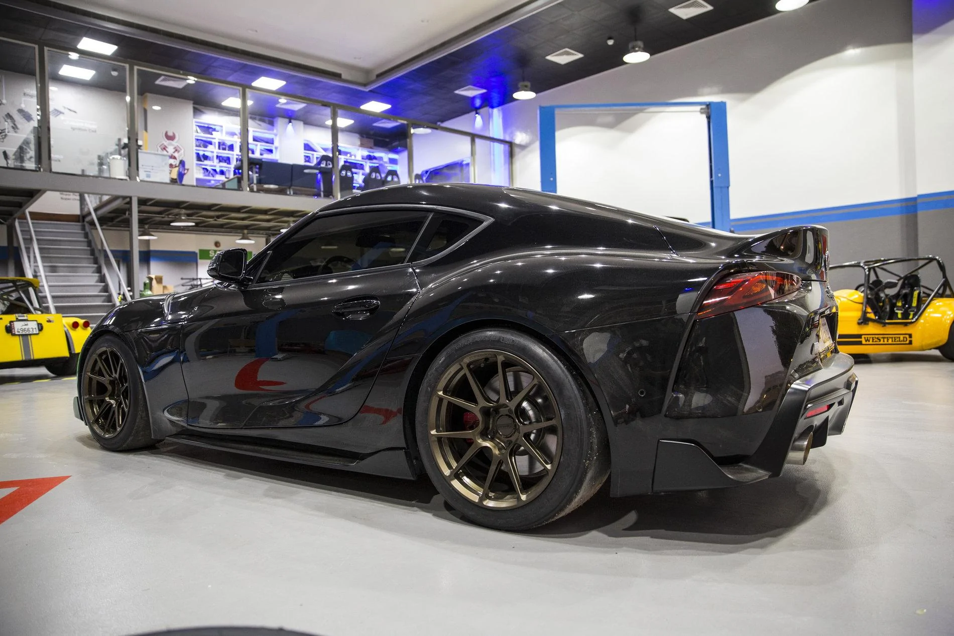

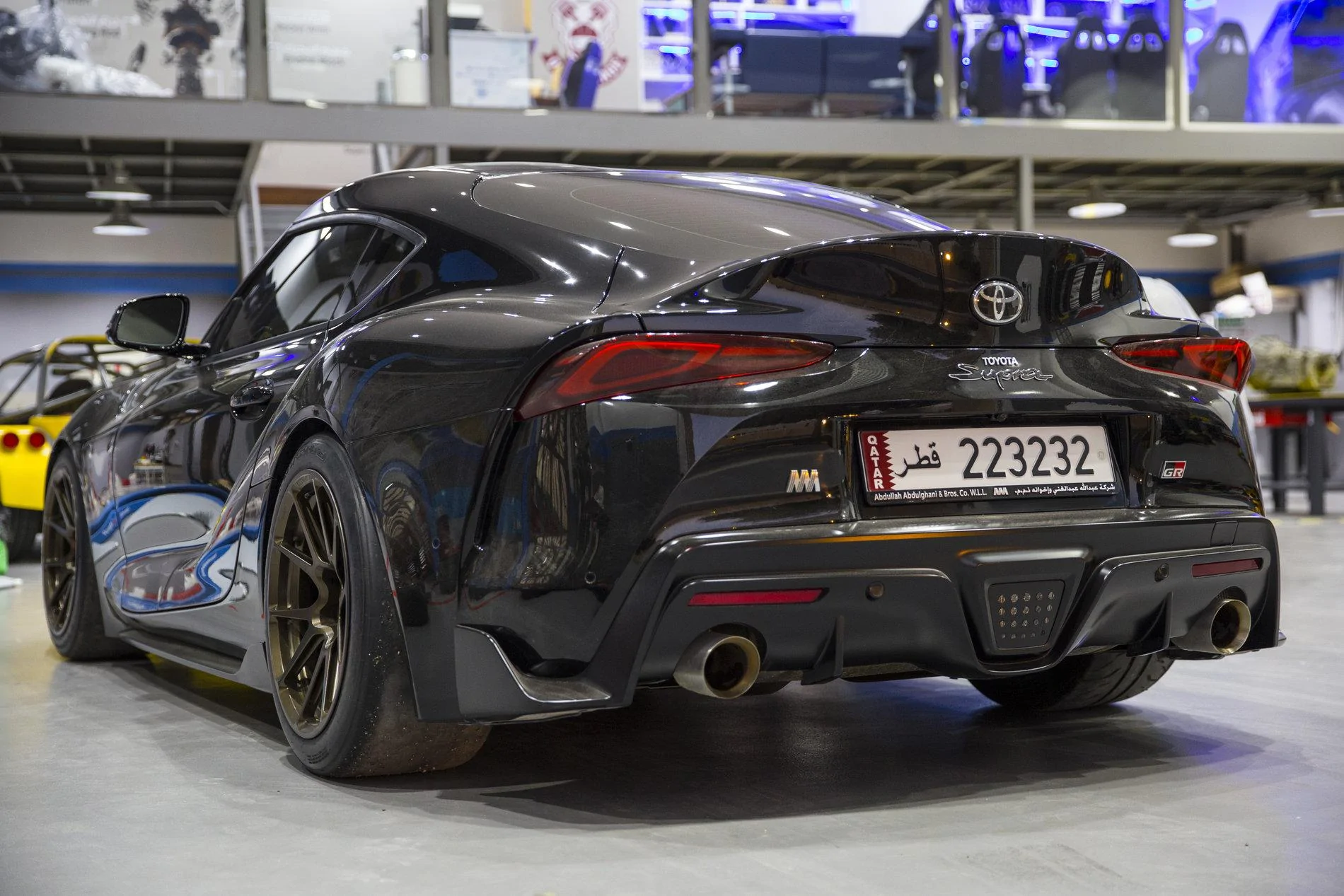

New shoes for the Supra! Went with Forgeline 18x10 F and 18x11 R.
Very happy with the fitment. Fronts cleared the stock spring perch, which is something I was concerned about.

What are the offsets on those wheels and what size slicks are you running. Those wheels look amazing in that color.
+31 F/ +41 R with Avon 250/640 R18 Front/ 270/650 R18 Rear. The Avon tends to run wide so they are around 285 F/ 305 R.

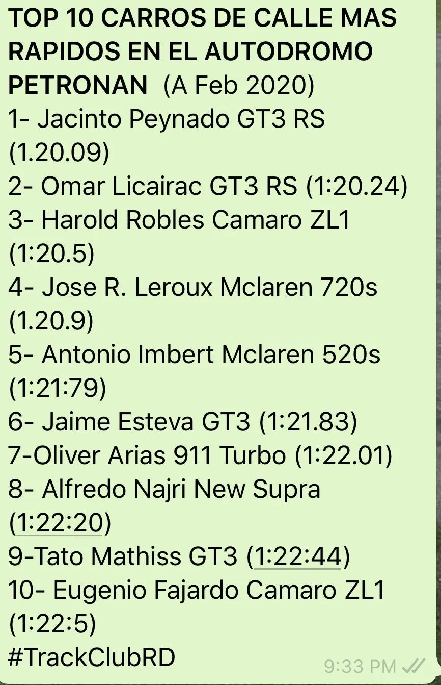

awesome write up. keep em coming.... I have had similar results here in the Dominican Republic. its incredible to see how much the car responds to little things you do to it. and how fast you can Play with the big boys........ as you can see from my list, already made top 10 in our local track.
for reference time my completely stock time was 1.25.8
