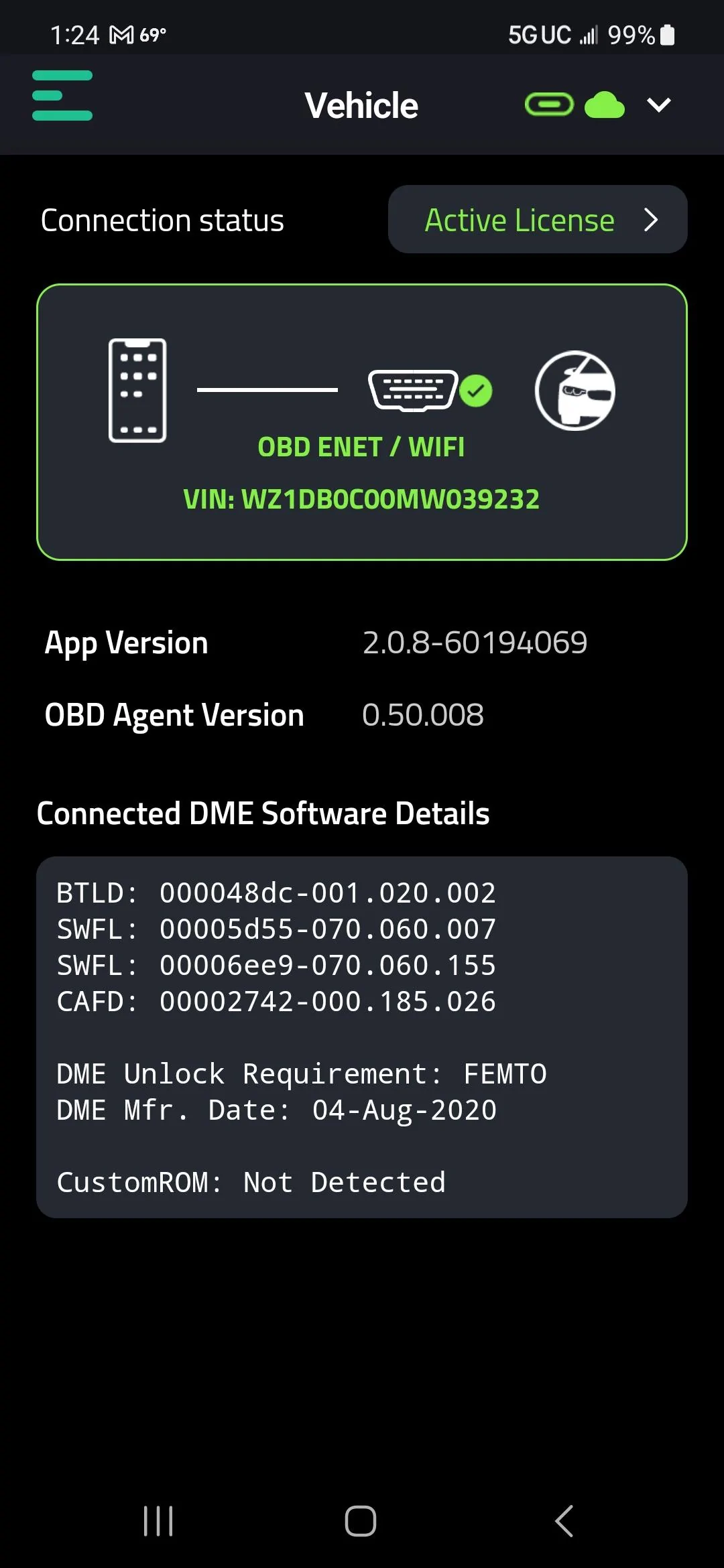

Edit: All is resolved now, but you can read below.
Welp! Major problem number one.
Screen said that my DME was still locked and CustomROM not detected.
Went to flash anyway and it failed, attempted to roll back to OEM tune and now the car starts and dies...
I am reaching out to ProTuning support as well.
Any thoughts? @Louaye @EPC
Louaye @EPC
Dec 7, 2022
87
149
Virginia
europerformancecenter.com
2022 Supra premium
Almost had a heart attack for anyone else viewing this custom rom will not say enabled until a custom rom map is flashed, and bm3 does not tell you if your dme has been unlocked.

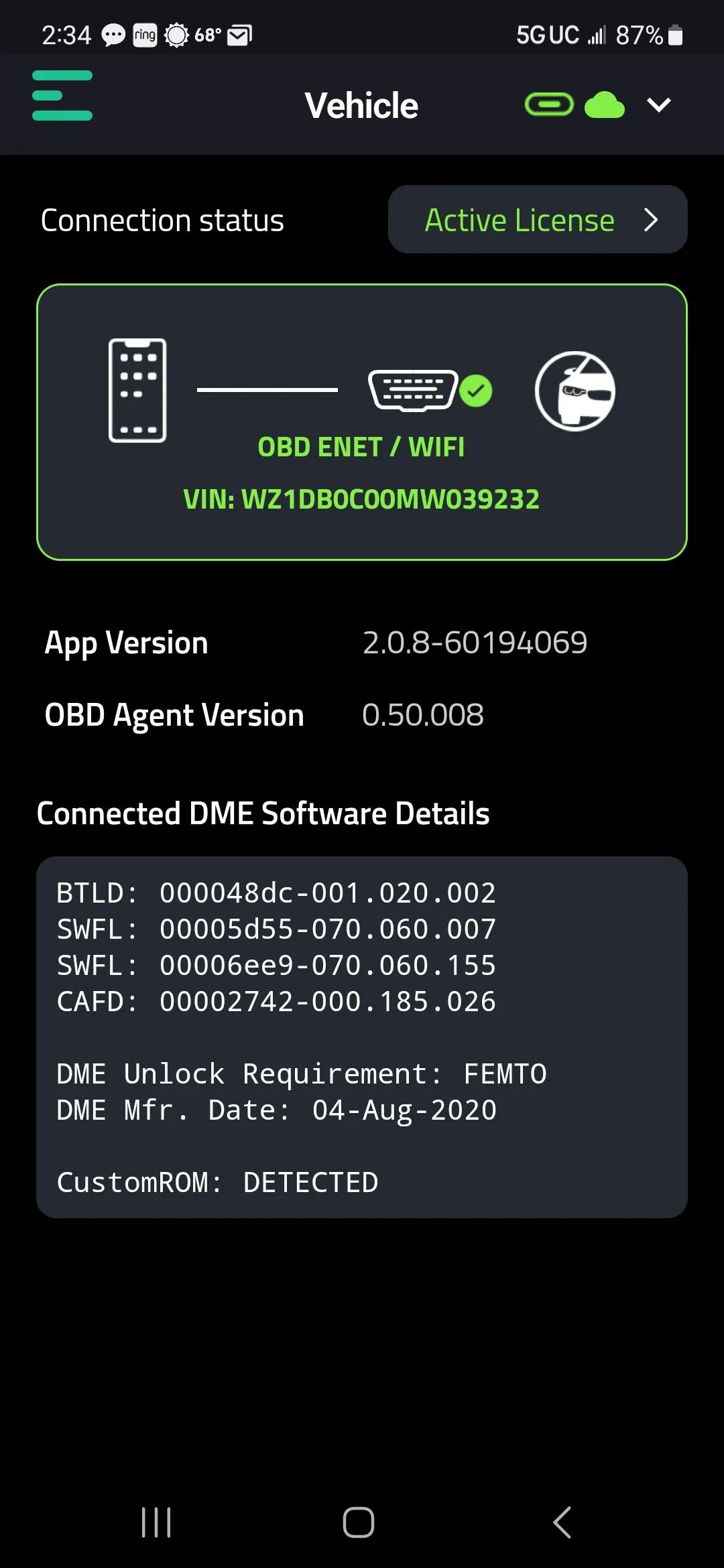

Ok folks, I am back up and running with the CustomROM.
I was using my Samsung Galaxy S22 with Enet cable and USB Adapter to attempt to flash the first time and was having issues.
I then figured what does it hurt - I got my wifes laptop, turned off the Windows Firewall, downloaded BootMod3 software and then was able to flash to Stage 1 93 tune. I then flashed to the MultiMap Stage 1 tune. I was only using the Enet cable with no USB adapter.
The car was able to start without issues - I have yet to drive it or tinker with the multimap settings.
Thank you to @Louaye @EPC - he contacted me right away, got my number and called me; all while contacting Femto and ProTuning folks.
