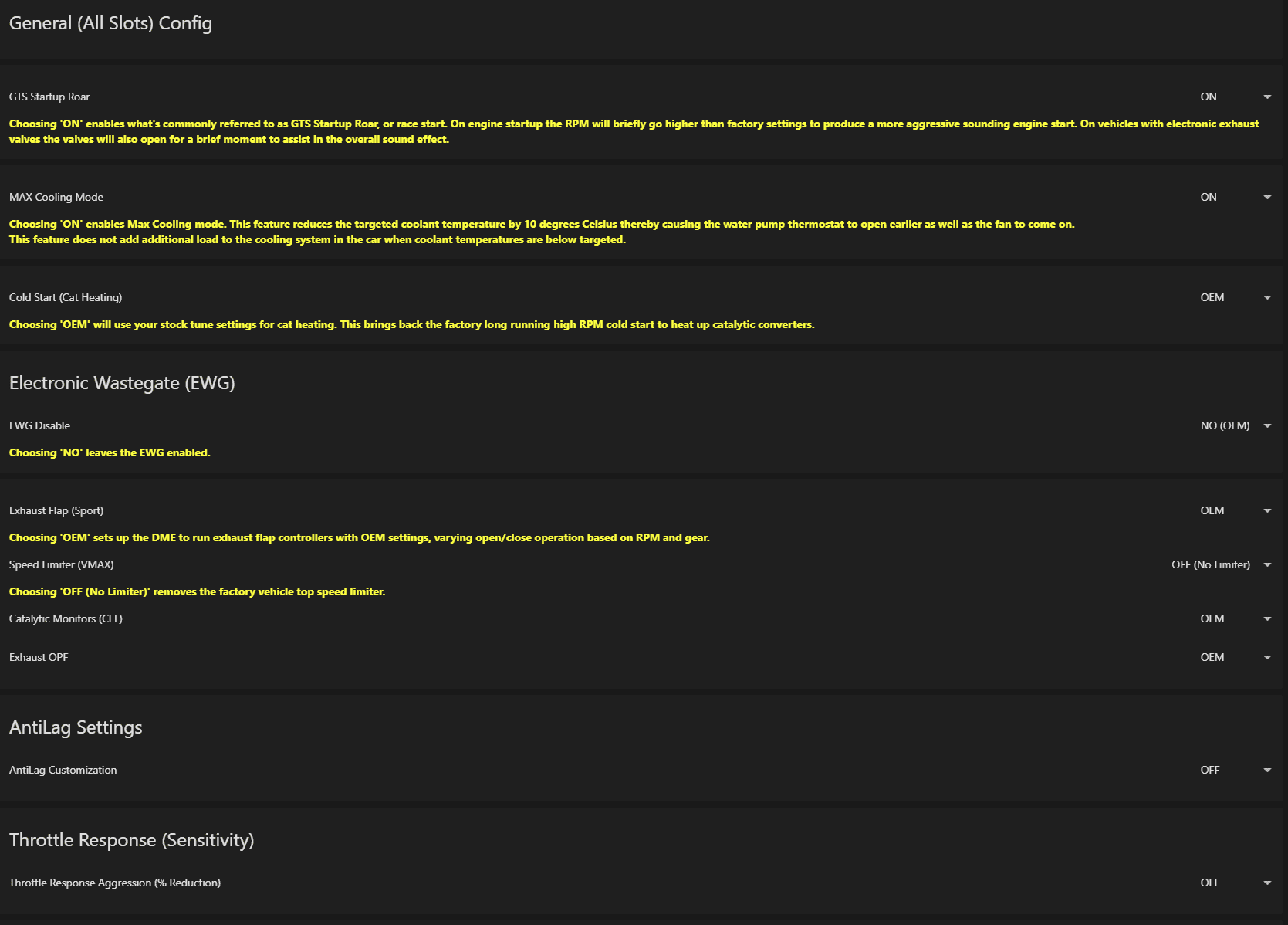

Can we disable cold start with BM3 ?
Eastwood
Dec 20, 2022
738
1,007
SoCal
Yes, the CVN number will change when any changes are made. You modify one table, CVN changes, modify another, CVN changes.
There are ways to force a CVN that never changes but I wouldn't know anything about that. ;)
So then flashing to the stock MAP would also leave the CVN alone, making it a clean ECU read for CARB?
8,472
14,120
Curious, why would you want to do that?
If you've removed a cat there's literally no point- so disabling the super annoying sound is a huge plus.
If you have cams or a built engine, you pretty much have to remove it if you ever want the car to start.
I despise my cold start, it is one of the reasons I switched to the FI exhaust, because it is so quiet with valves closed, everything else the cold start was too much, great exhausts, but cold start was just anti-social. I wish it did not require tuning, turned it off day 1 on my 2020
Does disabling the cold start hurt anything on the car??? I feel bad waking up the townhome every time i start the car lol
