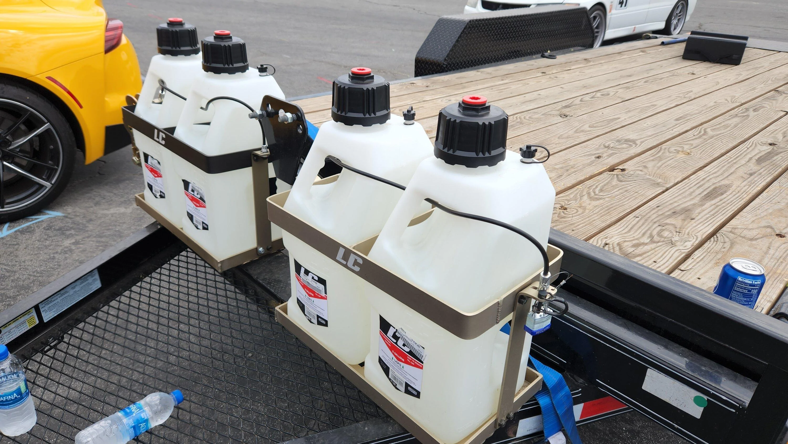

But not for power? You know you can run up to E20/25 in the car as is, right?
Correct. I prefer flex fuel so that I don't have to test e85% and do math to figure out how much I need to equal e20-25. I'd rather run pump gas than do all that.
I only run e85 to theoretically keep things cooler, power is a non-issue.
So I'd have to determine if it's important enough, to me, to justify all that $$$$.
Seems kinda not worth it to haul E85 all over the place and have no power gains for it.
Whatever keeps me out of limp mode in 100° heat. More power would exacerbate the problem. We only get the first three sessions of a day to qualify our hot lap. I can't afford to have anything go wrong.
Carrying fuel isn't much of a problem.
Since the intake temp is measured pre cylinders, that ain't going to help very much, if at all.
It pulls power based on IAT vs knock counts, etc? Well that saves me a ton of money.
Both. Sometimes independently, sometimes together. There is a table that based on IAT temps, looks up a timing reduction table at a certain percentage.
There is another table that pulls target torque down depending on how much timing is being retarded.
Cutting a hole in your hood and adding a vent would probably do more for this than just running ethanol with no performance tuning
