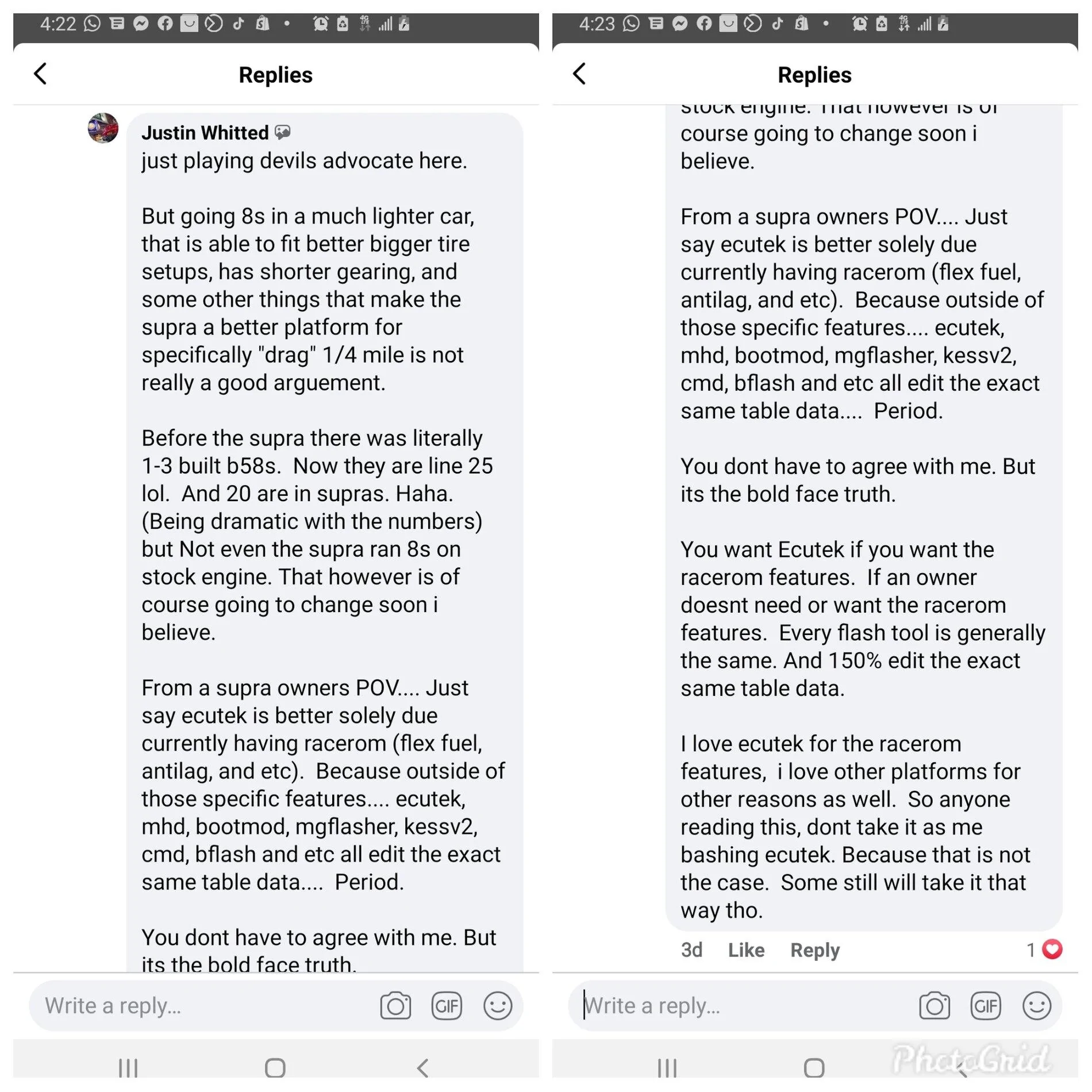

Rather than typing it all over. See below for my response to a similar question. To where someone used the supra running 9s and 8s before all the other B58 BMWs.
again, im unbias, i use them all.
