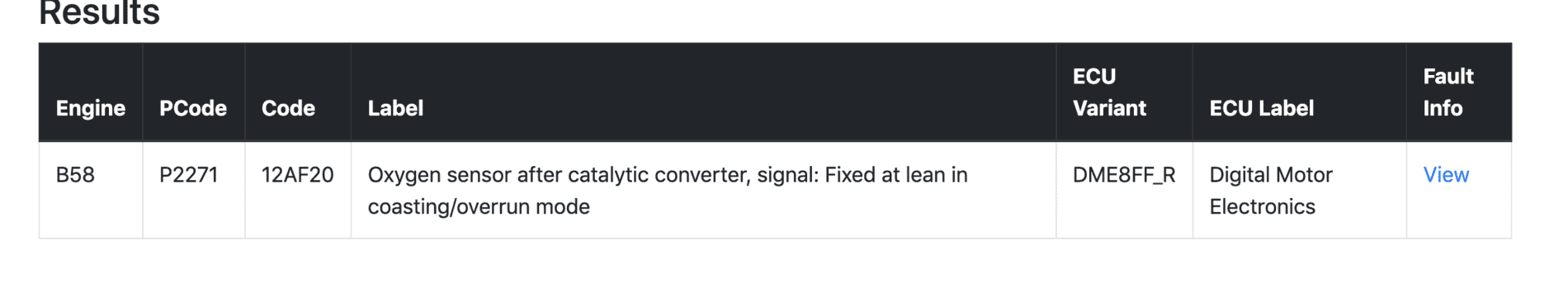

    I've been running stage 2 w/ catless downpipe and the CEL setting to off. I still get the CEL. Wondering if that's the same experience for anyone else here.

    whats the actual code?

    I flashed stage 2 with catless dp on Tuesday and got cel (p0141) yesterday. Cleared it and it went away. We will see if it returns.

    I'm seeing 12AF20, which is likely a different code. My guess is it's more about fuel trims.
    My full setup is Bootmod3 w/OTS stage 2 tune and a catless downpipe. I also have a mini-cat simulator between the O2 and the DP.
    The mini-cat is not this exact brand, but it looks very similar. <-- I'm wondering if my issue could be surrounding the use of the Mini-cat and the disabling of the cat monitors within BM3.

    That's the 02 Heater circuit if irc.
