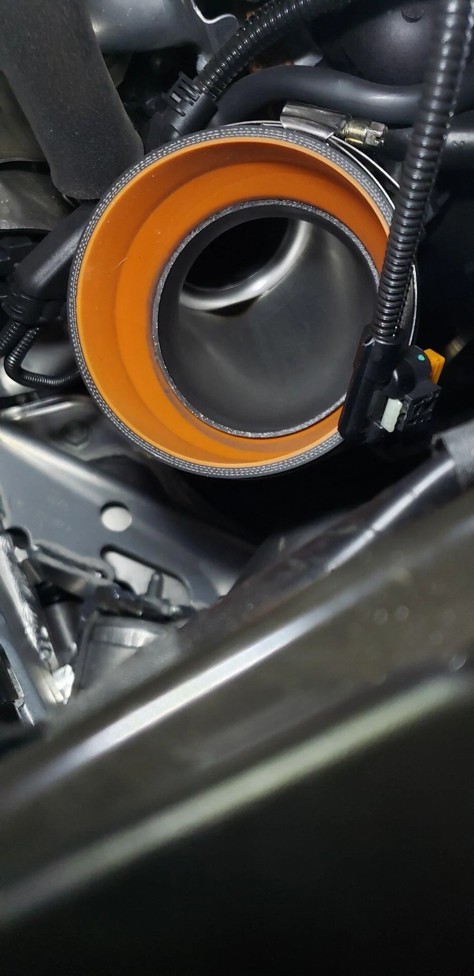

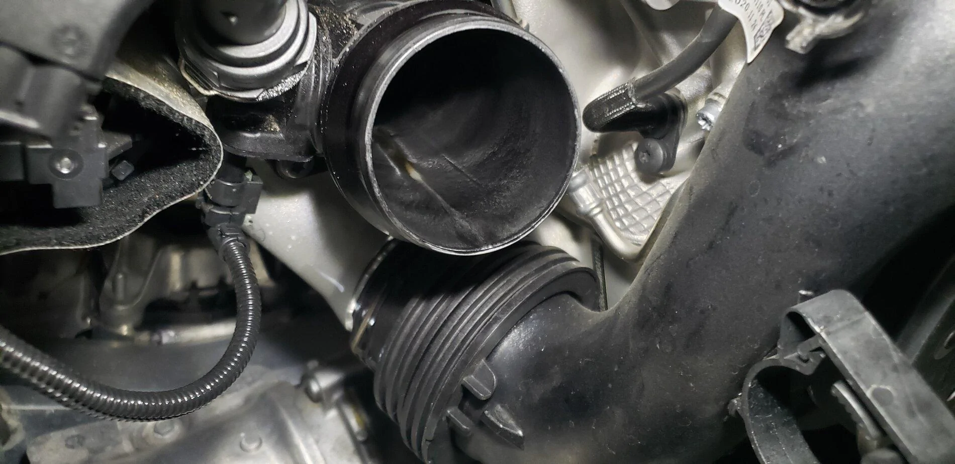

So it finally came. The minimum level warning showed up at 4500 miles. Changed my oil at 1200 miles, there was no oil consumption then. My build date is 12/20.
I tried to keep the break in period within the guide line. Pulled it a couple times around 5K rpm but mostly kept it under 3-4K rpm, never redline.
I was curious. Opening up the CAI and there was oil in the inlet pipe and the turbo intake is coated with oil. Not quite sure what to make of this. Is this blow by? Is my engine toast?

It looks like blow by, hard to say what the cause is. I would recommend removing your catless downpipe and MST intake and take it into the dealership for low oil documenting.
Cylinder scoring can certainly increase blow by. I’m also guessing you’re still running the Gazoo 0w-20 oil?

I'm running Amsoil 0w-20. I've already put one quart of the oil in. I'm afraid the dealership wouldn't do anything now because I don't have the low oil warning message anymore.
I'm gonna try and call them Monday to see if they have cases like this and make an appointment. I will definitely take everything off before going to them. I'm not risking it and let them have any chance to get my car flagged.
