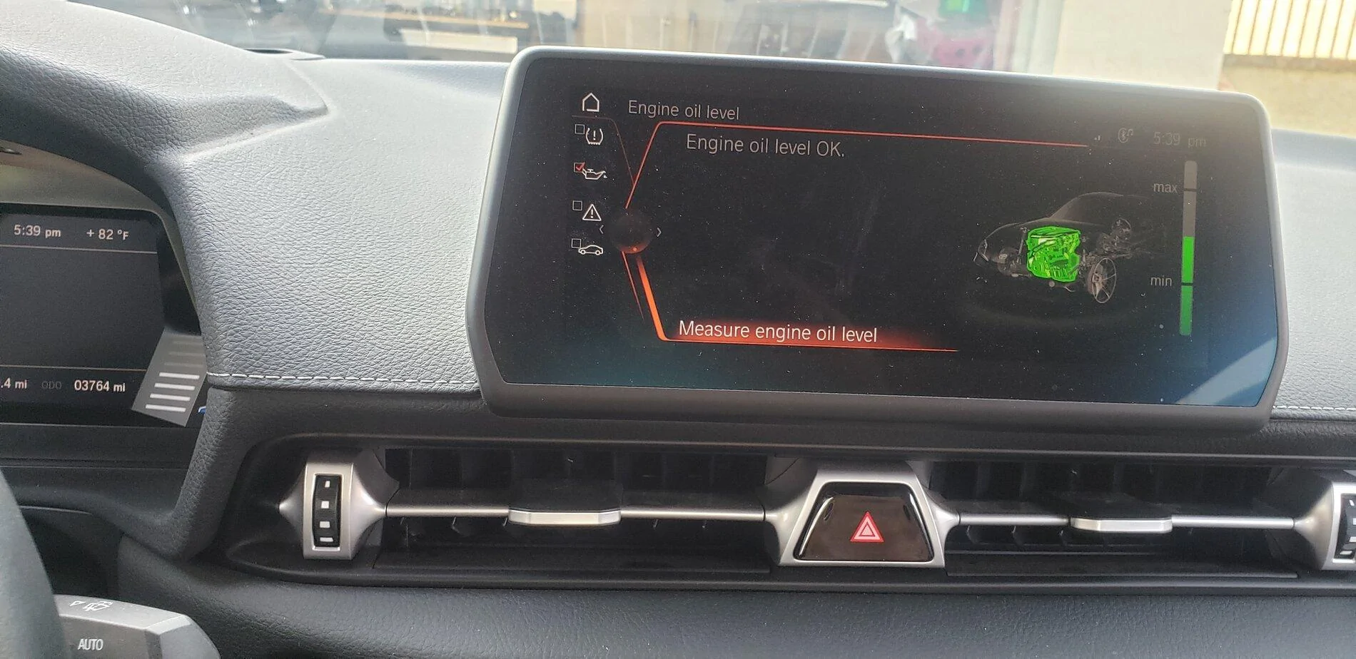

So far I've added
1qt at 3600mi
1/2qt at 4200mi
Did you get a second “low oil alert”, and decide to add half a quart to observe the measurement results? One quart at 3600 miles doesn’t sound too bad, imho. Second alert at 4200mi does seem odd.
-Sport mode burns oil quicker (could be some truth to this but take with a grain of salt)
this statement makes sense, and generally is understood to be the case with sustained high RPMs .
The question is, what rate of oil consumption becomes excessive for this BMW engine? Because there are varying standards even in this forum.
More importantly, unless the consumption is outrageously excessive (one quart per 500-1000miles?), I’d also want to observe how it develops over the 10000km break in.
I didn't get an alert the second time, I think it only triggers at 1qt under max. I've just been in the habit of checking it every few days now and saw it was 1/2qt low.
Be careful topping up without the alert.
I have seen the oil measurement fluctuate between markers. Mine alternated between 3/4 and 1/2 before it later stabilized at 1/2. It’s not very precise. So if you add oil before the computer calls for it, you run risk of overfill.
Yeah I've been keeping an eye on it for sure
Did you re-check after 30 min+ driving the next day? Thats what Ive normally done. Confirm it especially if its just a bit low.
I've basically gotten in the habit of checking it after driving, when I pull into my parking space at home.
