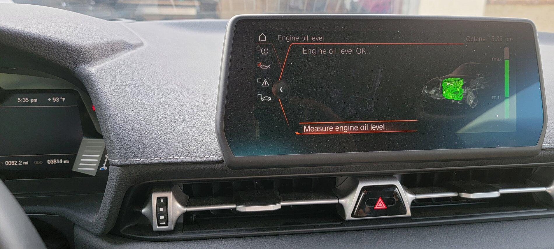

Started receiving low oil notification at about 3100 miles after doing an oil change at Toyota then again at 3900 miles after topping off. Right after that I made the switch to redline 5w30. Hit 5k miles today and still at max level praying for the best!

I would take it back to the dealer and tell them you want the oil check functionality fixed under warranty. If they won't fix it, try a different dealership I guess, but that just seems like bullshit that they are ignoring what is obviously defective software or hardware with the car. It isn't like they can say "our tech tested it and it worked fine" if it always stops at 20%.
Yeah going into the dealership this Thursday for the recall reprogramming for the brake booster and gonna tell them and show them checking if oil still stops at 20 percent. Was just waiting for the recall fix to available but it came quick so we gonna see what they say. We already know it some sensor for checking the oil level hopefully they can figure it out or maybe the reprogramming of the ecu fixes it? ?

I know there is a possible defect in these 2engines but I am not 100 percent sure it might be a combo of parts causing the low oil issue.
I am working with the dealer on mine I have two issues unable to check engine oil (it’s stops at 20 percent) and mine is burning about 1 quart every 1000-1200 miles!
The two parts below might fix the two issues!
Here is what I think fixes the rapid oil consumption is the
VALVE ASSEMBLY, OIL PRESSURE CONTROL
Part Number: 23950WAA01
And the unable to check engine oil level is the
SENSOR, ENGINE OIL LEVEL
Part Number: 89491WAA01
