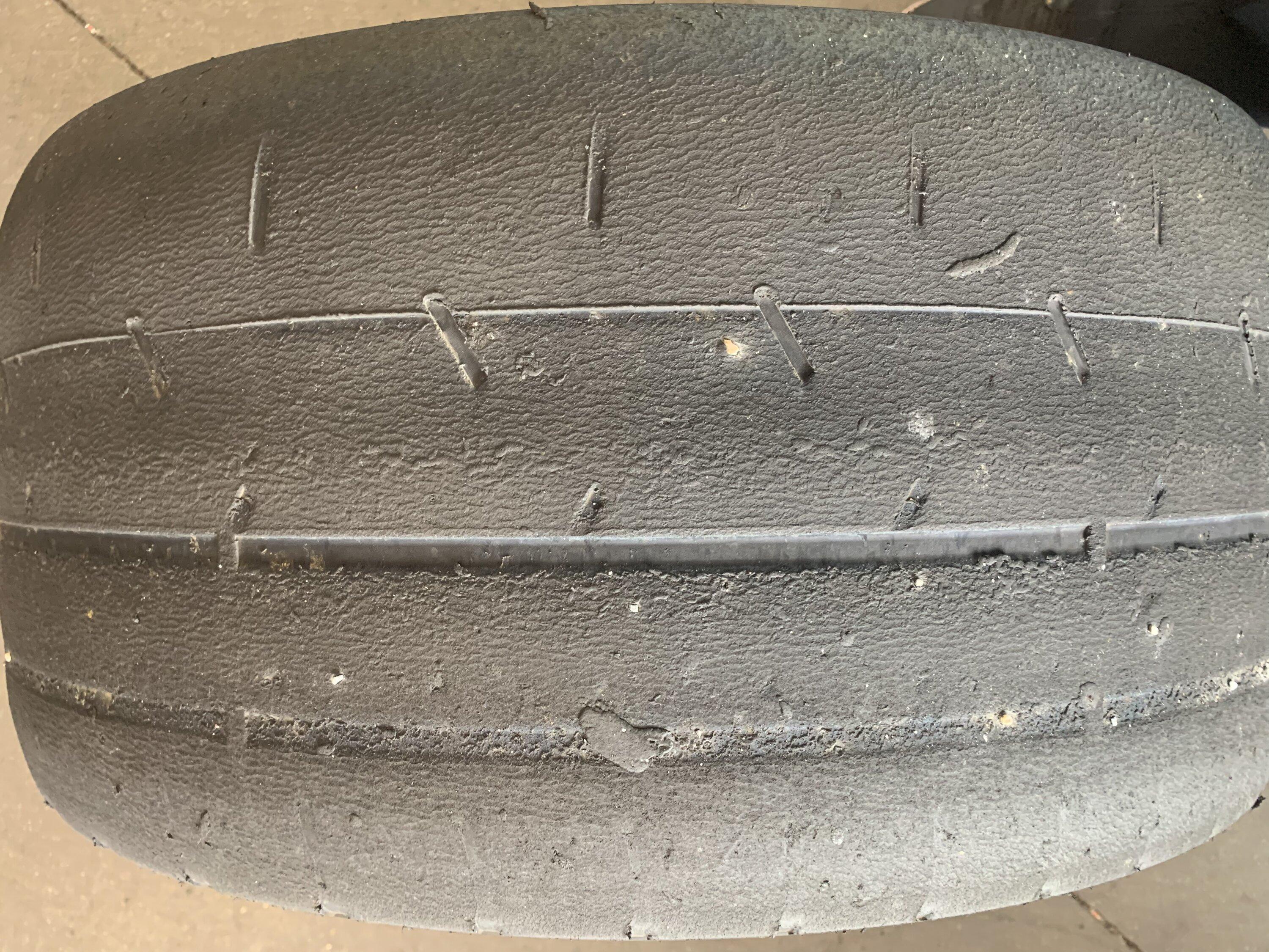

I am noticing some wear on the outside of my rear tires that I attribute to the small amount of toe-in I'm running in the rear. Fronts seem to be wearing a little more evenly with zero toe and ~-3.2 degrees of static camber.
I'm going to pull the tires and wheels off so I can clean them, bleed my brakes, and inspect the car before my next HDPE. I was planning on rotating the tires, but I'll be sure to take a few pictures of the front wear vs. the rear.

v1. I’m cheap. Still finding close out sets with some phone calls Paid 1000 including shipping this set. I am sure will be on v2 by sept
probably had one more fun day on them. But they were feeling heat cycled out and were 1.5 sec off my pace
