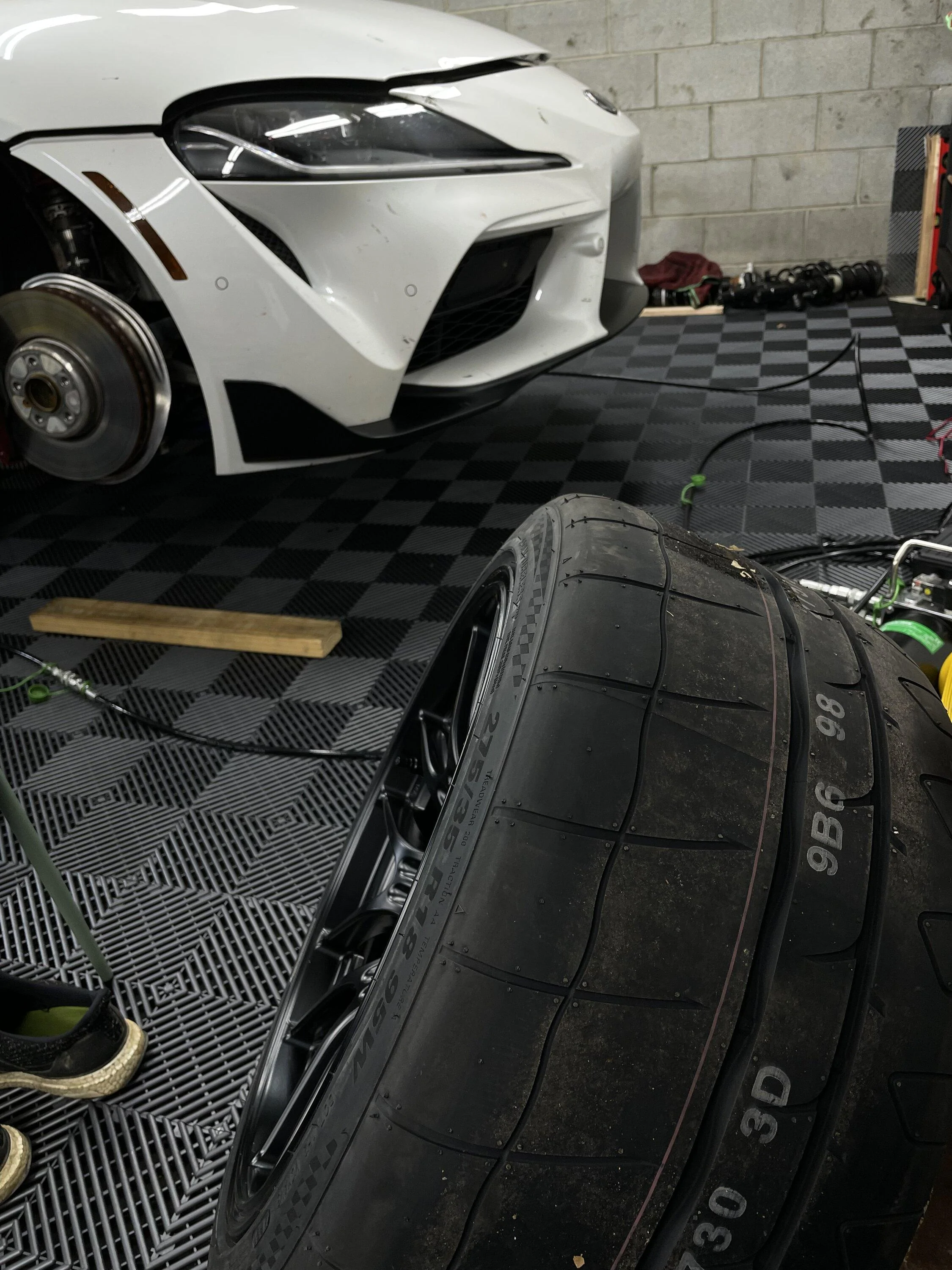

I finally put my Kumho V730's on and had two track days so far with them. Okay the first day, much better the second day.
I would say, the price/performance ratio is hard to beat with these. They do not have the pace of the super 200's but they are faster than the endurance 200's.
For under $900 for all four 275/35/18, it's a great bargain for a pretty capable lapping day tire.
I do miss my Nankang CR-S tires but they are more expensive. That said, I have a fresh set ready to go on after these Kumhos
275/35/18 Kumho V730 on a 18x10.5 wheel for reference:
8,808
17,284
^^^ second day was better because the first day was a big heat cycle and then cure over night
Yea I understand that. Was just a pretty big difference. More so than other 200tw tires I have experienced.
I was really close to taking them right off after the first day.
