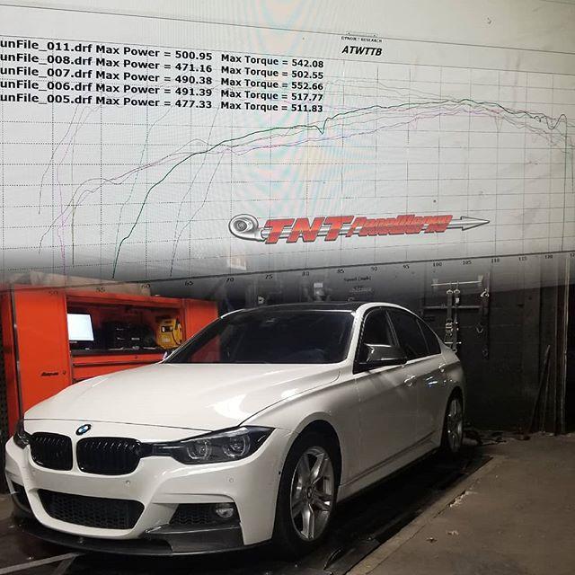

I'm not on anybody's side but a B58 on a stock turbo just made 500hp.
https://f30.bimmerpost.com/forums/showthread.php?t=1588149
"All Runs are 93oct +100% Meth
Parts on Vehicle:
➖@burger_tuning Jb4 & Intake
➖@evolutionracewerks Downpipe
➖custom Meth Kit done By @tnt_racewerks
➖Ecu Flashed by @dmetuning ➖Custom Exhaust "
Parts on Vehicle:
:bow:Thank you, finally a person who says the truth.
The engine already has a huge compression ratio for a turbo.
So even with water meth 500hp will be the limit the b58 c and it is 420ch in stage 2 for the x5 b58c without meth.
However, many look at the power and not the torque. the torque will be showing near 620N.m in stage 2 :yes:
