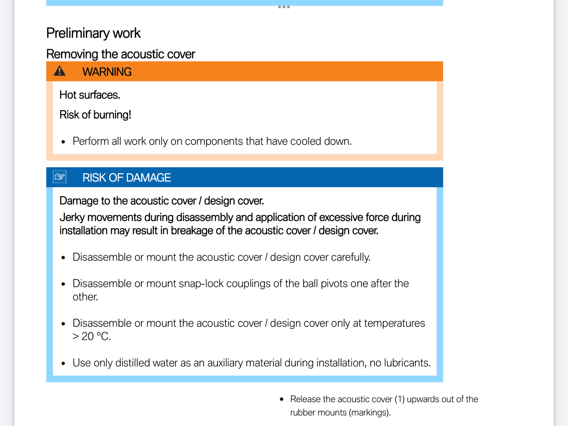

Just out of curiousity, was everything warm when you removed the cover? Being that you were doing an oil change, I’d think so.
Asking because of this from the service manual, though it’s mostly talking about damage to the acoustic cover, not the valve cover.
That’s design risk mitigation at its best. The part probably failed during the FEA study and had a high RPN in the dFMEA. They said F’-it well just cover our butts with the owners manual. ?

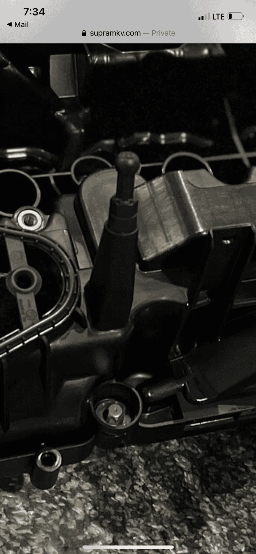

I'm still not getting this - how does a broken engine cover expose internal parts of the engine?
(keep in mind the Supra in our fleet is not mine so I'm not as familiar with the engine compartment).
Want to make sure I don't make the same mistake when I have to change the oil.
8,473
14,119
The engine cover didn't snap, the post on the valve cover that holds the engine cover did.

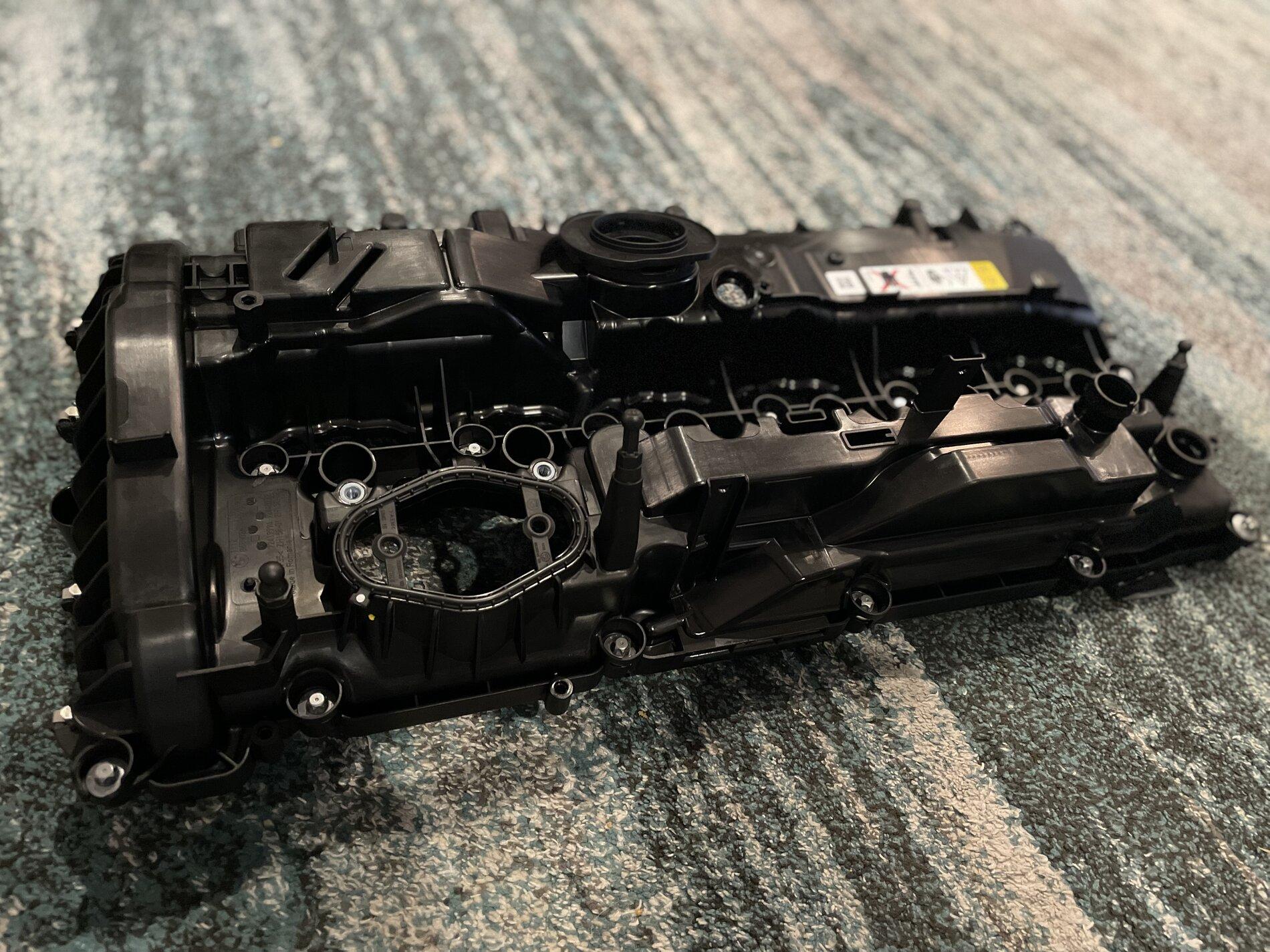

To be clear, the cover didnt break the post it connects to did. The post that broke is like 3 inches high and is extruded from the valve cover. I lifted the cover off of the engine on the diagonal opposite corner. When it the cover popped up I went a bit too far putting too much leverage on the post and “snap”. It broke at the base where it connects to the VC. Thus an open hole to the oily bits.

That sucks! These posts should be made of metal or at least not part of the engine.

You see the large opening on top of the VC? The tall post next to it. At its base is where it cracked.

At the base of the tall mounting boss
?‍♂?‍♂ Still don’t see it. Just take a better photo with it zoomed in and not a zoomed in photo of your overall photo.
We all want to know what not to do and break the mounting points on the valve cover. Still not sure how the hell you did it. I taken mine off like 500 times.
