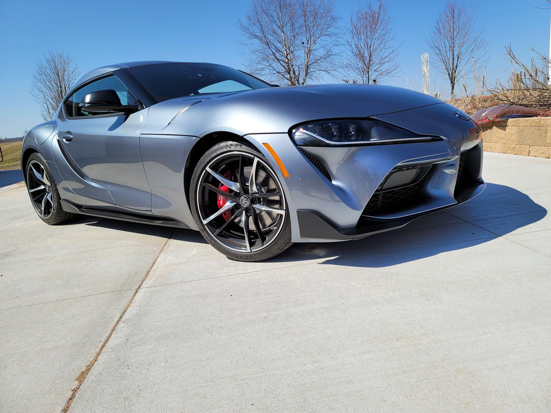

So like is says I bought my supra toady very nice 3.0 premium in grey. I'm happy! Parked it in the drive way for 3 to 4 hours. Went to put it into the garage. Started it let it idle for 45 secs. I wasn't trying race with it just put it into the garage. Took it out of park. Into reverse. Car dies. I'm like wait what? Start the car again. Put it in reverse and step on the gas it dies again. At this point I'm a little mad to say the least. Now I restart it plant my foot on the floor and it putters like it's dieing to 1000 ram and dies again. Now I'm super pissed like I just bought this piece of ****. Finally start it get it backed into the garage it now has a not so nice check engine light. I will have to look into in the morning.
