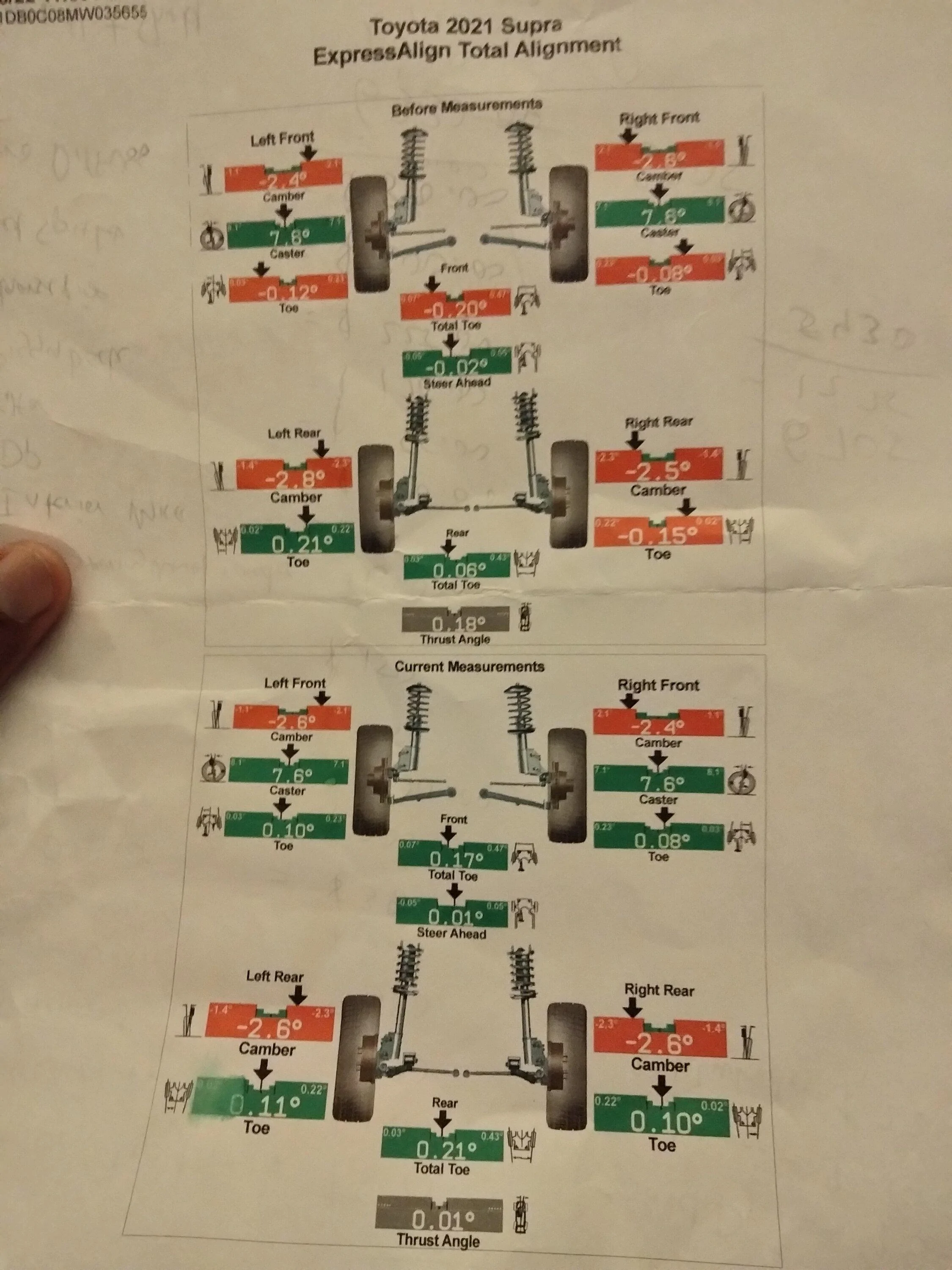

This was my alignment after some springs installed. I'm glad I got the alignment because the before was really really bad. At 140 mph in my car it feels stable AF!
