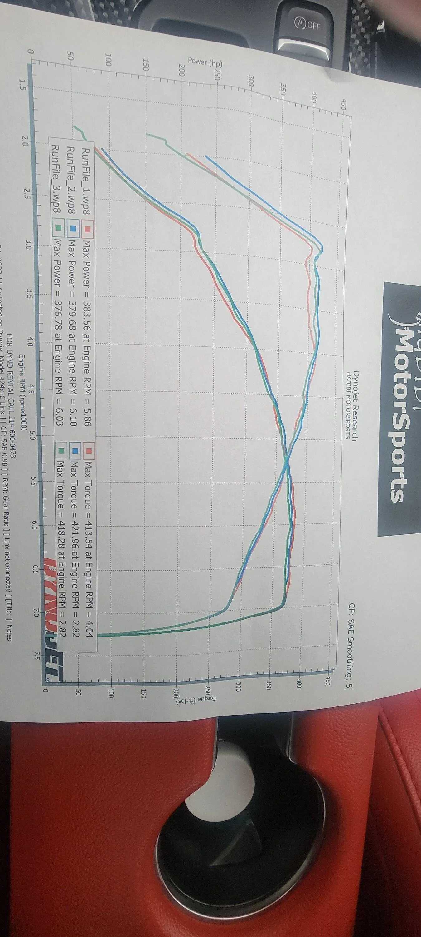

Well. I didn't get a stock dyno numbers. I was a little disappointed when i saw the numbers. Just because I've been see other stock car numbers almost the same as this one. I just can say it was 40 degrees cold and 50 percent humidity so it was not hot at all.
Also can't take to the drag strip until reopen back again. With only the intake i did run a 12.4 at 116

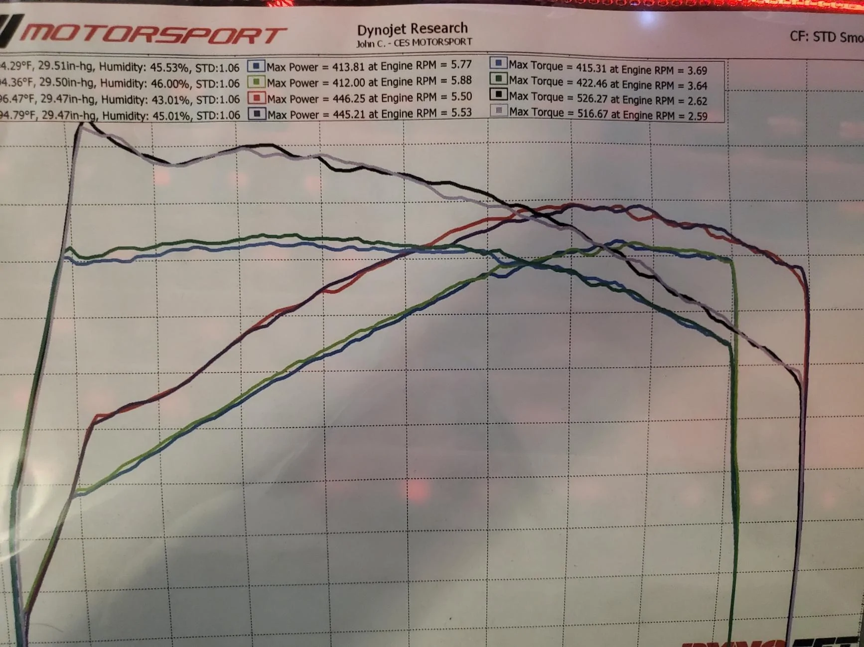

I put the car on a dyno. Its a 2021 tunable one. I put a mst intake and 4 5 inch powerneedy catted downpipe. Then a stage 2 tune. What you guys think about this numbers. To me i think they are kind of low
These are stock numbers. My 2021 made 413whp and 415wtq, and again 412 whp and 422 wtq on a second run. The car had no tune in the first two runs BUT did have a catless DP already installed. Then we moved onto a standard OTS 93 octane map. My best run tuned was 446.25 whp and 526wtq and it was 96 degrees F and humidity was above 40%. Since this I have now gone with an E40 custom tune and its considerably quicker. Your numbers STRONGLY suggest that your tune file did not go through properly and you're still running a stock tune.
This is what i think it happened. Because this cars constantly are making 375whp and 420tq. At least 2021 and up. I mean, i think for 1,300 i should get at least 415whp, just for having a v2mst intake intake and a catted 4.5 powerneedy downpipe. This tuner suggested buy a charge pipe and pay him another 800 to do a costum tune usinga dyno, but at this point im afraid i will end spending 2k on a tune and maybe get another 25-30hp
Request your money back and move onto either Ecutek, BM3, or MHD and a different tuner.

So basically if we see the dyno numbers on a 2021 supras can we agree this numbers are numbers for a car with a downpipe and intake and NO TUNE ?
Unless your car is seriously hurt, your numbers are stock tune numbers.
