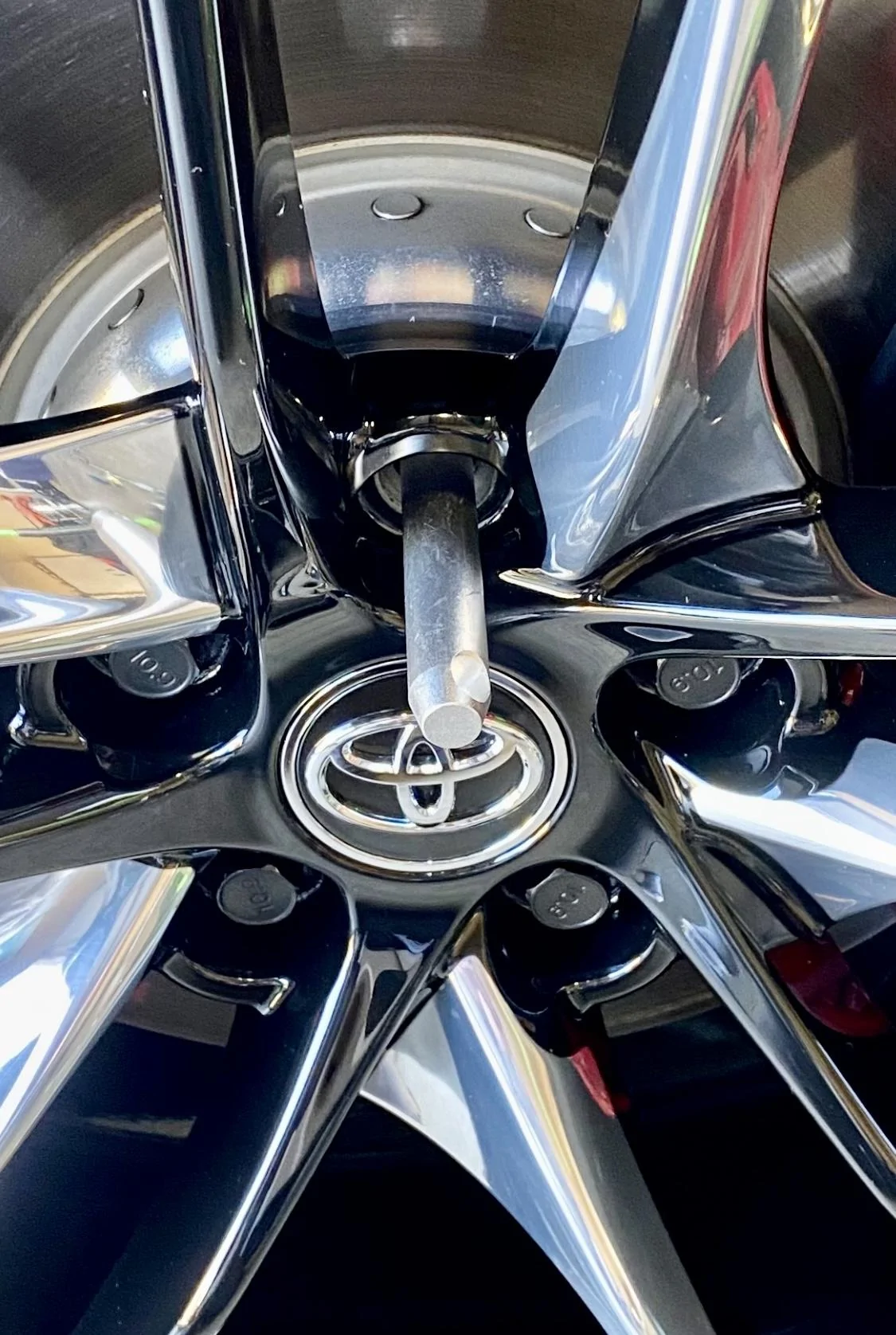

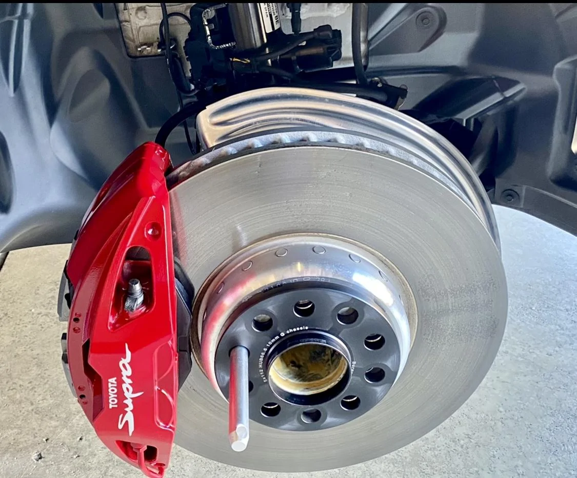

yep. wheel hanger is best way to go if stud kit is not an option.
https://www.amazon.com/Steel-Wheel-Hanger-Alignment-Guide/dp/B07SFZ6YJL/ref=sr_1_5?crid=37UVQEQLHT4R6&keywords=bmw+wheel+hanger&qid=1666193590&qu=eyJxc2MiOiIzLjg5IiwicXNhIjoiMy4zNSIsInFzcCI6IjIuODUifQ==&sprefix=bmw+wheel+hanger,aps,91&sr=8-5&th=1
not sure which one is right size.. i forget these things.. :p but I believe M14x1.25 is correct. search before ordering it.
following is what I did before I have stud kit. (after jacking up the car)
1. rotate the wheel so that one of lug bolt will be at the top.
2. take that top bolt out and screw in wheel hanger. this way, when taking the wheel out, wheel will not hit the brake caliper to damage paint or damage wheel.
3. take rest of the bolt out and wheel off.
to put it back,
1. make sure wheel hanger is on the top.
2. align it and put the wheel on.
3. hand tight other lug bolts (4) and then tighten with tool using star pattern stating from across where wheel hanger is. this should let the wheel sit on center.
4. take the hanger out and screw in last lug bolt.
5. lower the car and torque to the spec.
