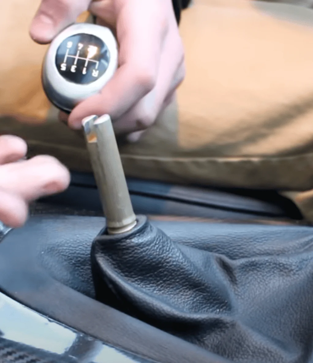

This thread is kind of confusing. It sounds like multiple issues being reported. Is the shift knob detaching from the shift lever during normal driving?
I was curious and lifted up the shift boot and the knob and lever are all one solid piece from what I can see.
the shift knob is attached to a rod which is inserted into a shaft that leads into the gearbox they are in fact two separate pieces and the separation point meets I would say about 3 inches below the base of the knob…idk why but that sounded super sexual and I think I’mdone with the internet today

LOL sorry to make you go into vivid detail about that. Do you have a picture of where the failure is and the knob is separating or do you just pop it back in?
so my ocd caffeine induced anxiety ridden ass didn’t take a photo or video I just shoved it back down and started making phone callsto Toyota. The boot never came off in my case so I just blindly guided it (the rod) back into place and shoved it with as much force as my amateur body building ass could lmfaoooo seems like it’s stiff for now until next time and when that happens I’ll snap a video
Start the video at 1:10
