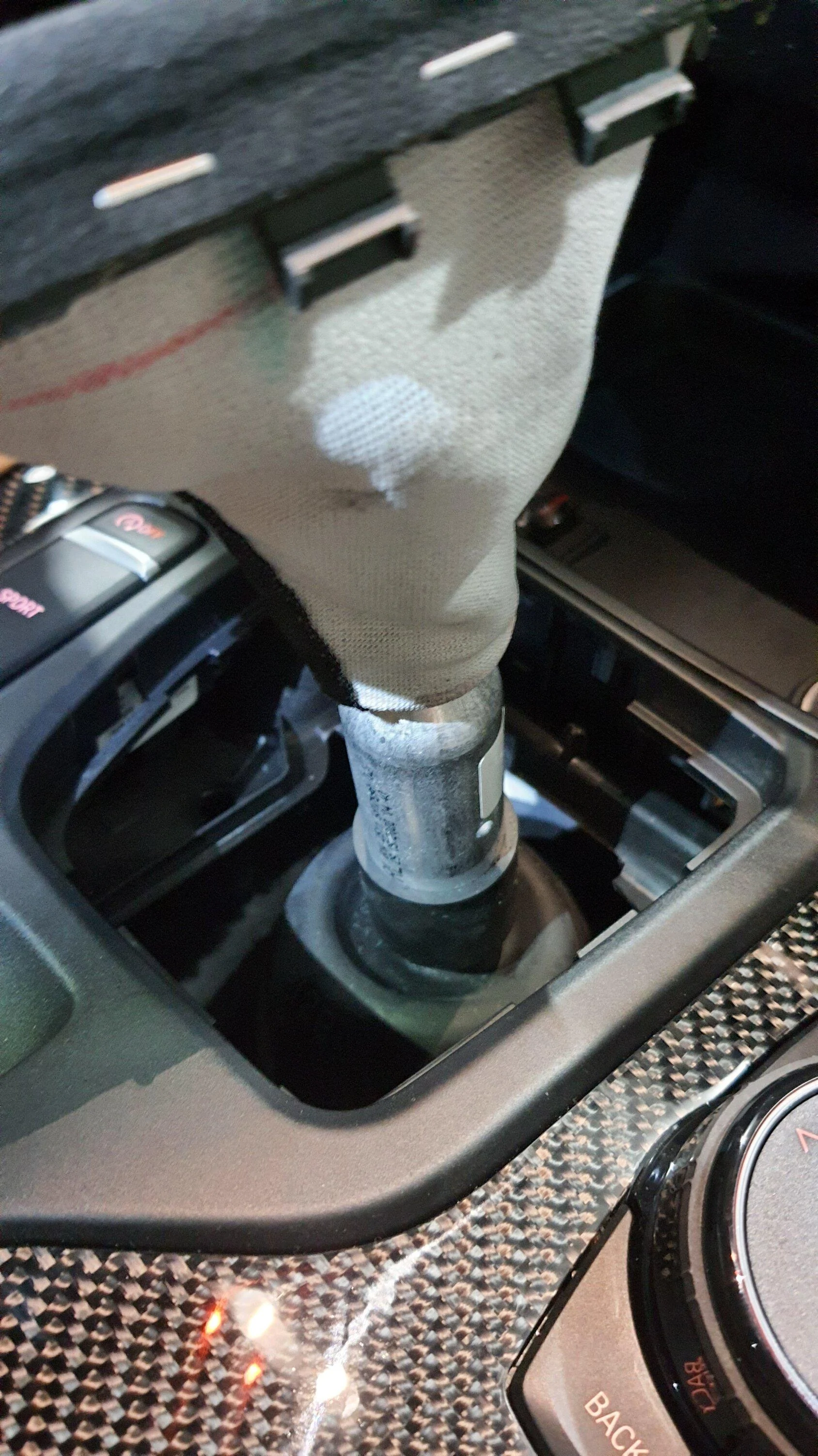

I wonder if it's a bad batch of clips or they just aren't putting them on right from the factory.
There doesn't appear to be any clips holding it on, just seems to slide on and "snap" in from what I can see. It's likely the knobs either aren't being pushed down enough and installed correctly or the inside of the knob where it's supposed to clip in is defective. Either way seems like bad QC on Toyota's part.
This is what the lever looks like under the boot:

im surprised this isn’t brought up more. So far all 3 people with a manual that I know personally have had this issue. 1 guy swears he was driving normal when it happened to him

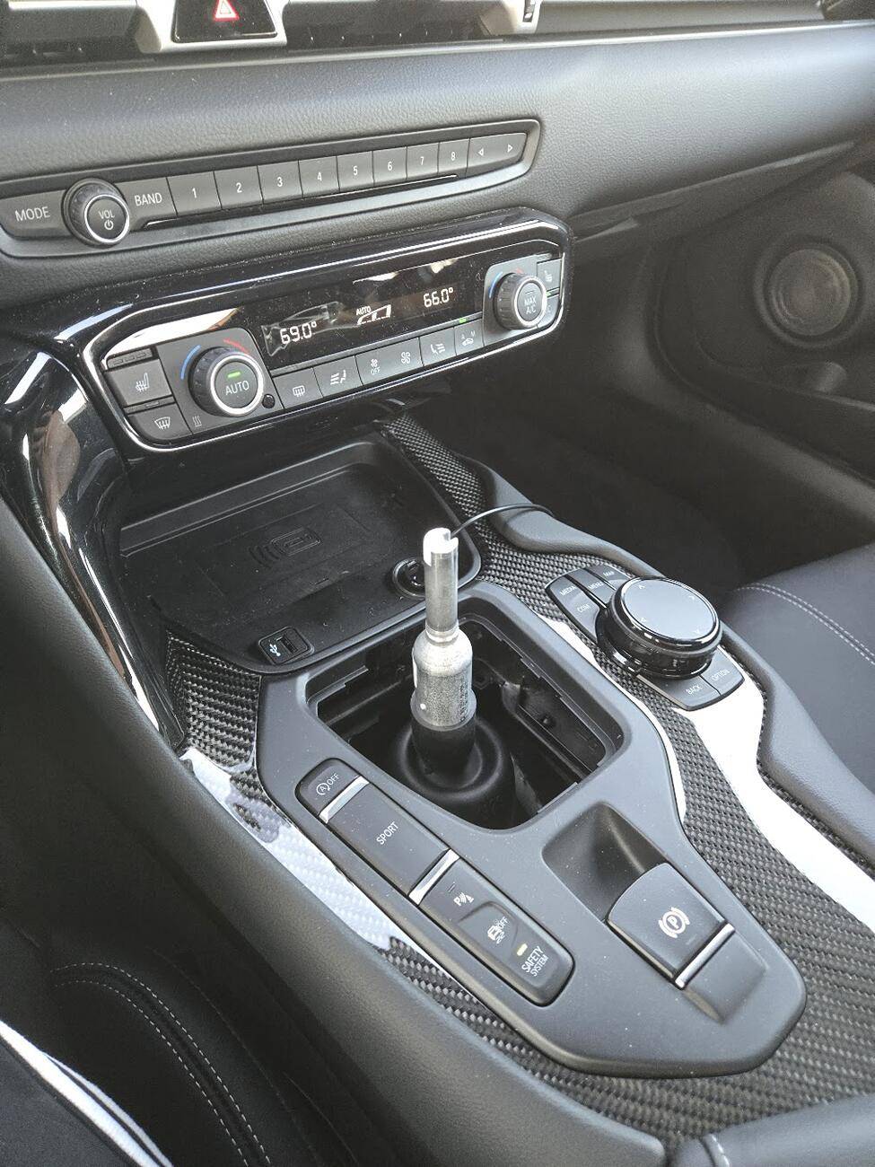

It's happened to most of us. Why do you think so many (myself included) are running an aftermarket knob that comes with a threaded adapter?

I love my Raceseng shift knob. NTA adaptor FTW!

Mine happened 8-9 times, but after one good whack in, it has not happened again, granted I am a little more cautious with how I shift to avoid it so that may be a reason why, the first time was pretty scary, mid 1-2 pull and it came off and car threw itself in N and just banged the rev limiter in the middle of an intersection and that metal rod gets super hot so it was a bit hectic getting back into gear and pulled over.

Nothing‘s broken. Manual knobs in BMWs do not thread in. They are popped into place. Whatever reason yours was not pushed or clicked in all the way down. Which led to it popping out very easily. Once you give it a good shove, it will click back in. And you’re good to go. Not a big deal.

Just happened to my 26MT today turning into an intersection. Was super scary when it happened. Wtf. Not safe at all.
