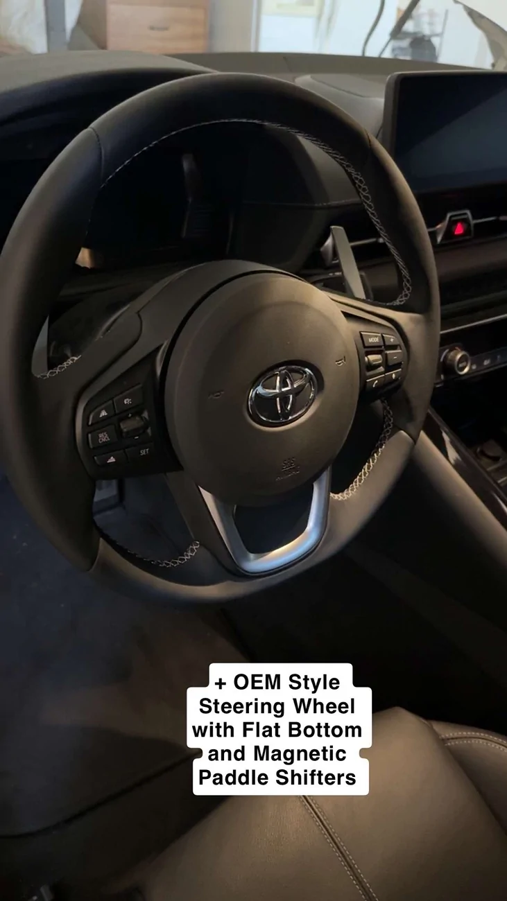

This is the steering wheel in question. Just a basic OEM wheel with a flat bottom, and added magnetic paddles with custom paddle shifters (exactly what I wanted) I love the wheel a lot so I’m really hoping it’s not an issue with that and I can just fix it adjusting the tie rods šŸ˜…

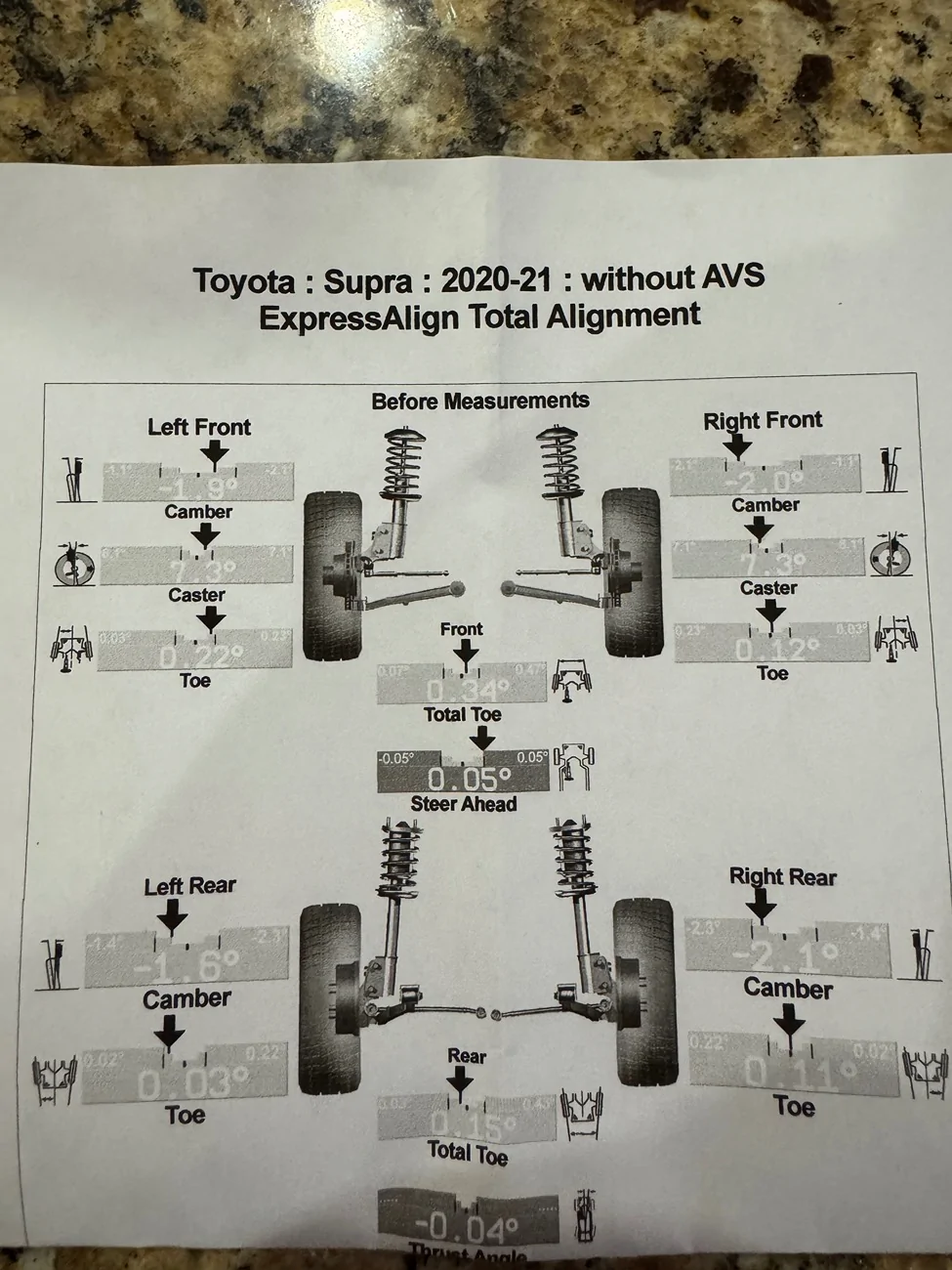

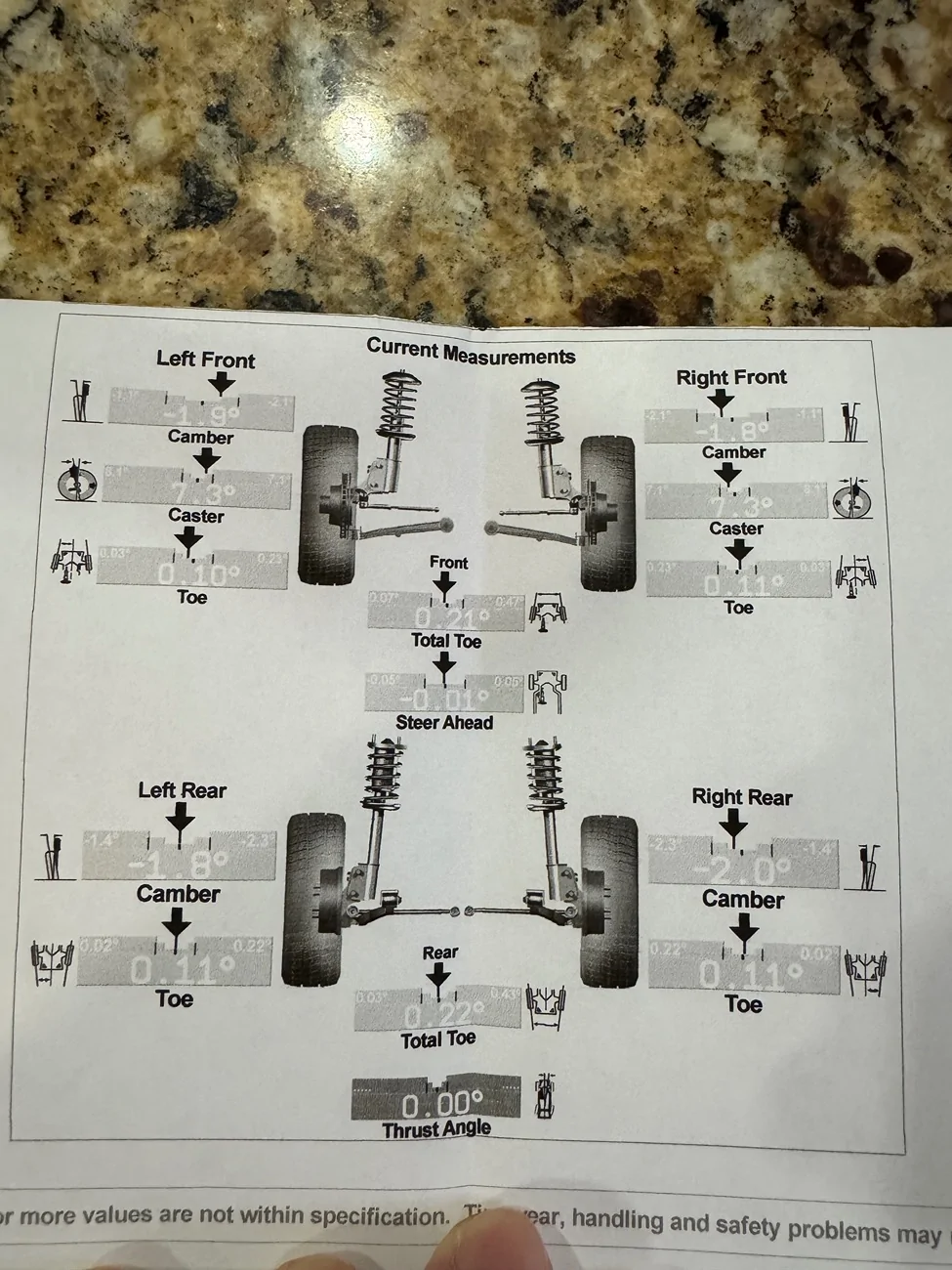

Did they give you a print out of the alignment data? I struggled with alignment issues especially the steering wheel being crooked. I was assured it was put to "Corvette spec" whatever that means and that the alignment was spot on (it wasn't).
But usually, they give you a sheet with all the numbers. I'm wondering if something is bent in your suspension or if you are just going to shops that have no idea what they are talking about, as was my case for like 3-4 different places.

These are the alignment specs they gave me. Top pic is before and bottom is after. I have no clue if these are ā€œgoodā€ alignment specs or not, or if that’s even a thing lol. I have nothing done to my suspension or w/e. Car is pretty new still, it’s a 2024 with 1600 miles. Only thing I’ve done to wheels is add spacers. No lowering springs, no aftermarket wheels/tires, etc

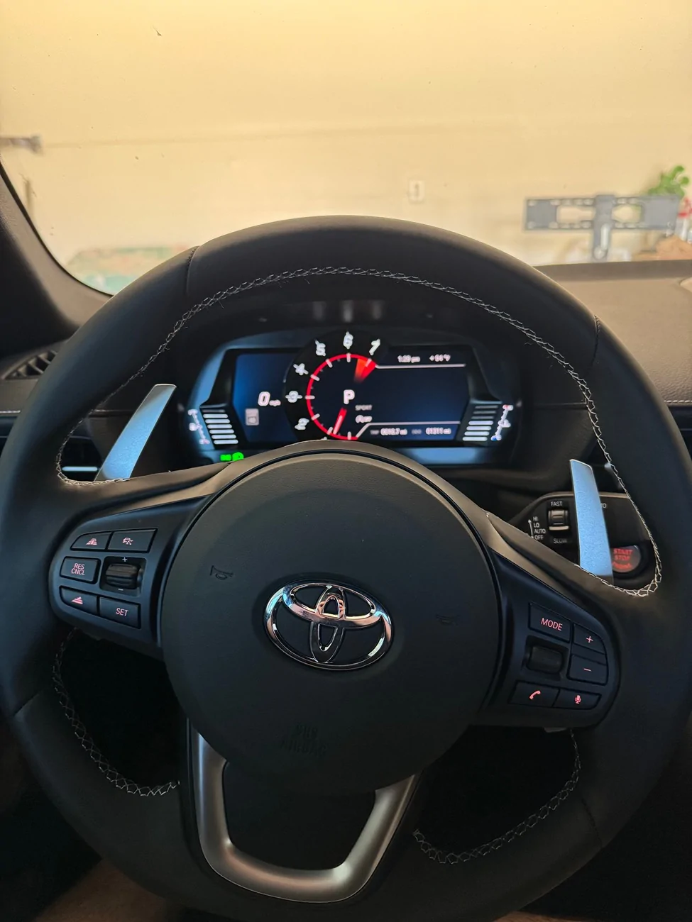

I ended up caving and going the diy route I posted. It actually helped so much, needs a minor adjustment and then I think it’ll be perfectly straight. I really wanted to do it the proper way and get an alignment to fix it. But with no trustworthy alignment shop close to me I feel like I couldn’t justify taking a couple hour drive for an alignment, and ngl was kinda worried I’d get the same result/told the same thing.
