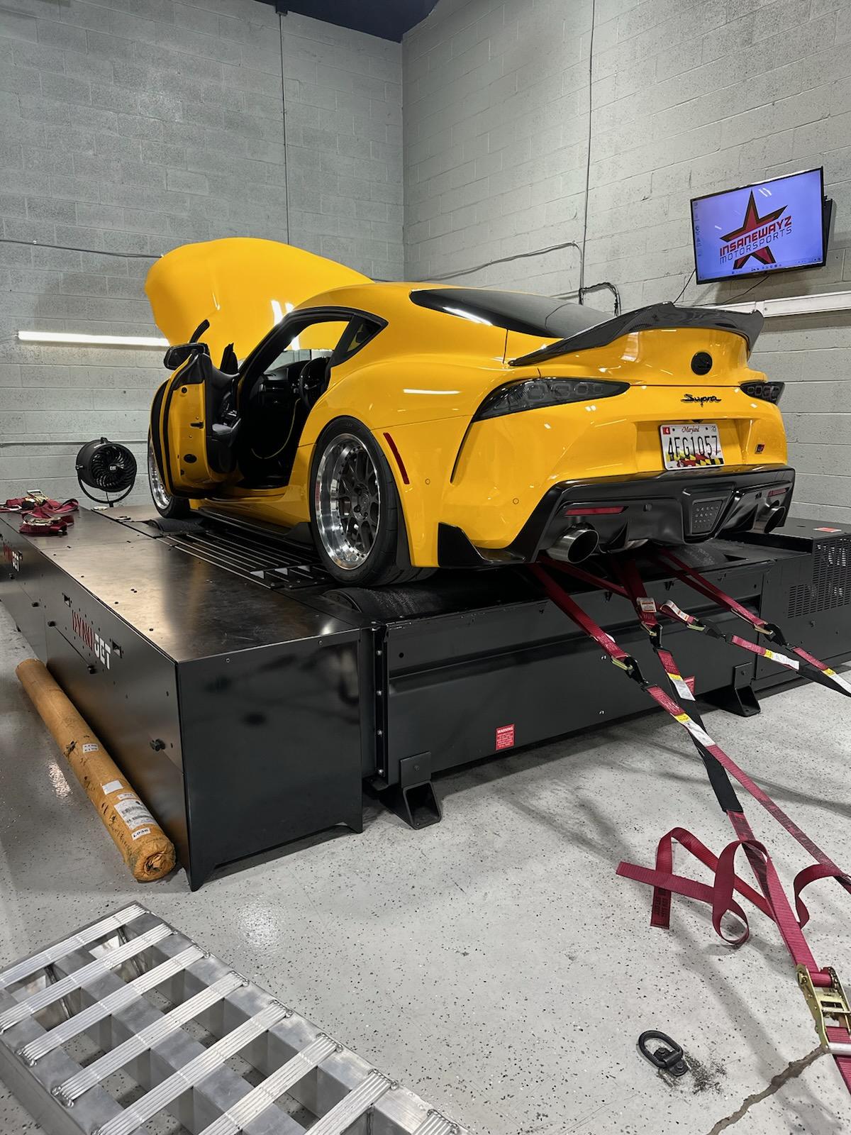

Got the numbers. Will post everything in a fresh thread. On vacation so I haven't even reviewed everything yet.
We did NOT max out the fuel system. Now the turbo on the other hand lol.
Sameh pushed that little baby DAW flow max as far as it would go. Could have gone a little further with higher ethanol but my dumb ass left too much 93 in the tank and getting Sameh's time is tough to get. They spent 5 hours doing 3 tunes. Three maps. 93, E52 low boost/timing, and full send.
Full send was 594whp/595tq @ E52
Not bad for the smallest upgrade turbo you can currently buy for the B58 (to my knowledge). Torque was not limited. I have a pure stage 2 tranny.
Will post the dynos, logs, and apparently they're making a video of the spool equipment install and dyno runs... will post that too.
Short story... still have headroom on 100% DI fuel system. Already in discussions with EPC for a top mount full frame. Going to run this for a few months first and hope that bm3 rev2 board comes out.

I haven't. Long story short (maybe not that short), it took Sameh 18 runs to dial in the Spool FX400x and 350IFX (stage2) injectors. He wasn't happy and I completely misunderstood one of his comments. I thought we were only running E52 due to the amount of 93 I had in the tank. That was incorrect. The issue was Spool provided him/PTF with the wrong tables for my HPFP and Injectors. I had originally bought the FX350 hpfp and Stage1 injectors. I sent the FX350 back (never installed) to Spool for the FX400 since I was still waiting on the injectors. They sent me the FX400 but upgraded me to the Stage2 injectors. So Sameh was trying to tune my setup with the wrong tables.
The tables have been provided to Sam and PTF. I'm supposed to get an updated tune this weekend, which I'm sure we will need to iterate on.
I have the original write-up ready to go, but need to supplement it with the new tune/data/dyno pulls. I didn't think it would be fair to Spool or Sam to post without the complete picture. According to Spool, I should be able to run E85 with no issues once I get my new tune.
I promise I will post everything in one comprehensive thread once complete. Sorry it as taken so long. It took about 2 weeks (LOL) to figure out what the issue was. As soon as I sent my logs to Spool, one of their developers knew the issue right away and reached out to Sam/PTF.
