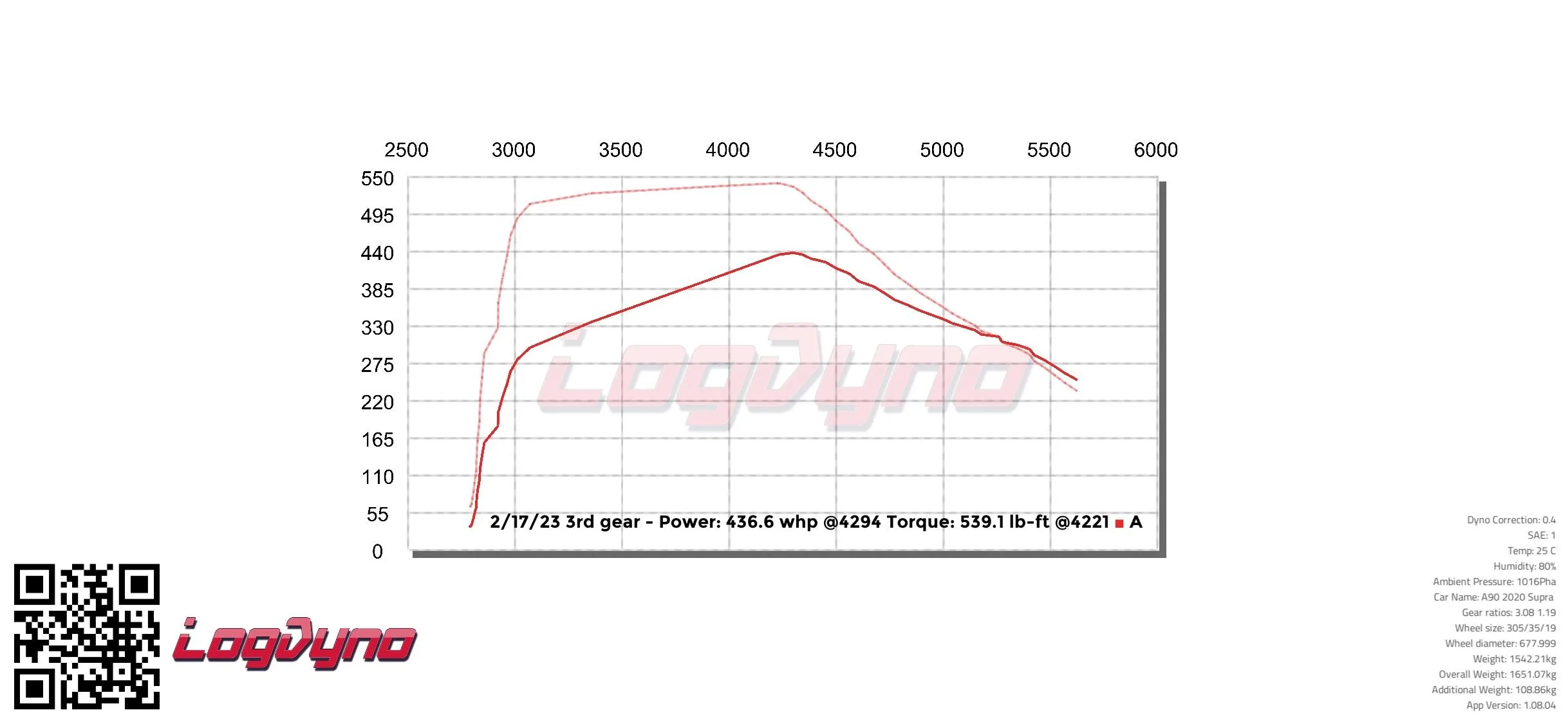

How are you making those numbers when literally everyone is saying it would require mods and meth or ethanol to get there? I'm not calling bs or anything, I'm genuinely intrigued.
406 WHP? People are saying you need meth or ethanol to make 400 whp?
JB4 map 2 will map that lol
8,828
17,320
This is mine with only 93 Octane with custom Ecutek tune only on a 2020. I don’t consider charge pipe and intake (Gruppe M) mods.
Perfect example of people only looking at peak numbers and not at the actual curves. What is going on with that tune that you lose 165whp/275wtq so quickly from 4250 to 5500 rpm??? That looks horrible.
Do you have a turbo restrictor like Group B rally or something?
I let off of the gas. Trooper was in on the side of the road. Before you go run your smart ass mouth, know the facts first. Lol ?
