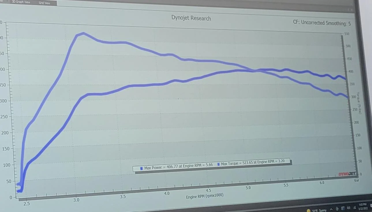

Just throwing this out there. I have a 2020 tuned with an ECUTEK on a dyno tune and it's making 420HP/500ft*lbs at the wheels with literally zero mods.
Just adding a flex fuel kit and an E50 tune will likely get you to right about 500, maybe just under.

How are you making those numbers when literally everyone is saying it would require mods and meth or ethanol to get there? I'm not calling bs or anything, I'm genuinely intrigued.
I make alittle more hp and around the same tq on 93 gas ⛽ with Ecutek custom tune, intake, and charge pipe. That’s it. You can make 500whp with custom tune alone on a 102 octane pump gas. No need for E or a downpipe. But a downpipe will make it alittle more easier for a less aggressive tune. Most people on here just listen and follow whatever everybody else does. A factory exhaust and downpipe surprisingly flows pretty well…….
Mike Botti. He knows his stuff.
also mikey botti tuned here. i asked for a conservative map for daily driving.
catted DP and intake
dyno 411/500
obviously could make more but not my goal for this map
8,472
14,122
So- yes. an excellent tune on a slightly juiced dyno will make 500hp on stock everything (just DP) for whatever reason, I was assuming locked ECU- and given the questioned assumed no unlock.
