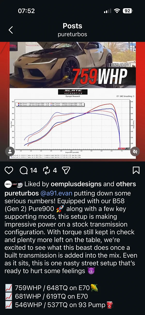

Don't feel like I could get a real concrete answer from the previous replies for this / researching elsewhere so sorry if this has already been discussed 100 times;
Realistically what can I expect if I went RP65/Pure900 + HPFP + Injectors on 93 octane? I want to be in the mid to upper 500's on that setup with MHD sometime next year and want to pre-plan for it starting now.
Note; I have E85 access and already do E40 blending for my JB4 map, but there aren't a lot of E85 stations in FL and especially not along the highways, so for convenience sake I'd love to just run 93 on a bigger turbo.
swrdply400mrelay
Jun 23, 2022
933
501
SoCal
From Pure’s IG, on 93 got 546 whp
ETA: do88 MERA, S58 injectors, Dorch DS25 HPFP

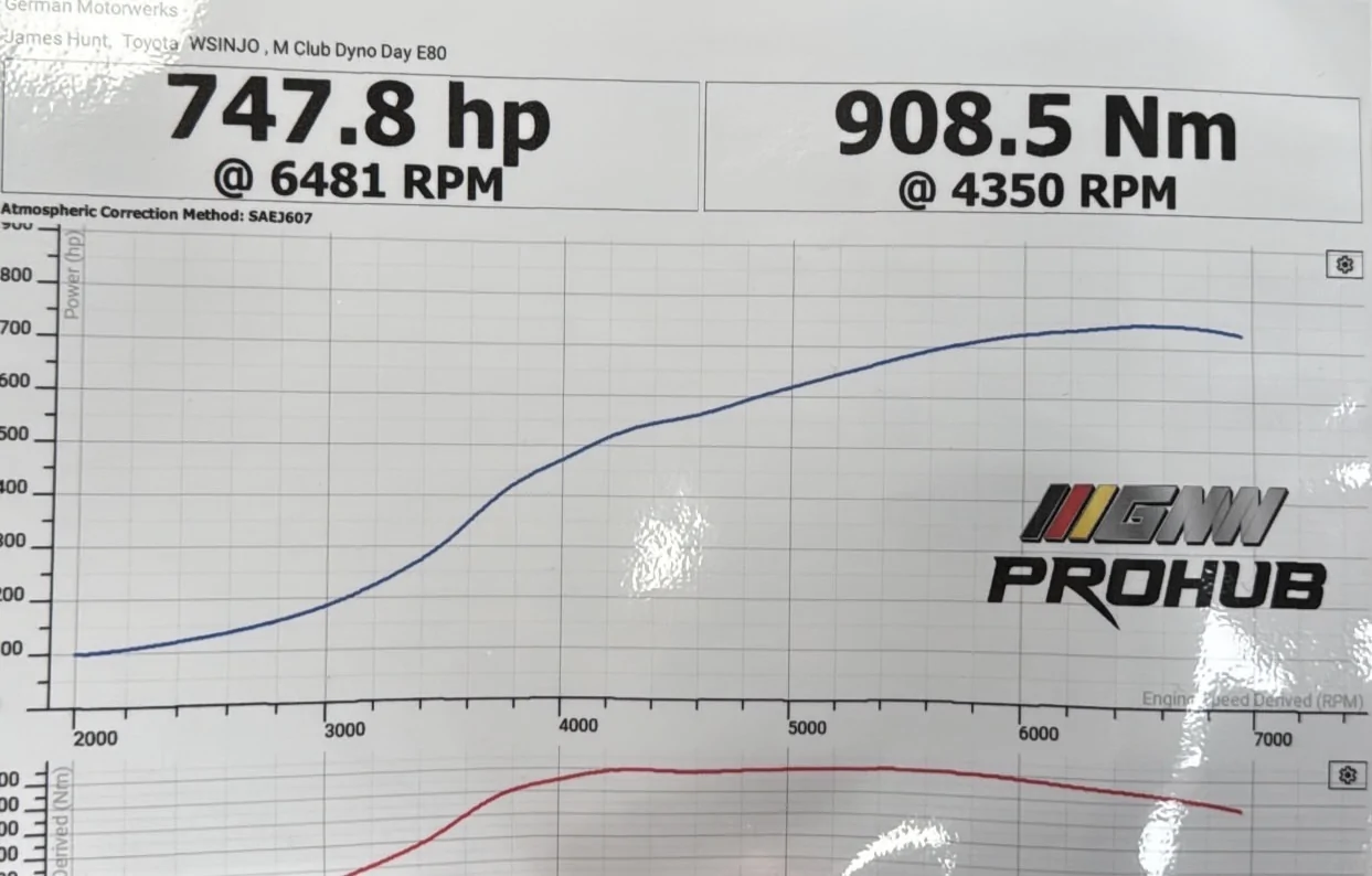

Guys simple question: 2port di, pure800-like custom turbo, S58 injectors - to achieve 550whp on ~e30 reliably for track do I need to upgrade HPFP to Ds25 or no need at this power level? I need the power to be safe and last in 100F waether.
I get mixed opinions on this, some say i should do hpfp, some tell me injectors are enough and there is no reason for HPFP upgrade for this power level and the stock pump is enough.
