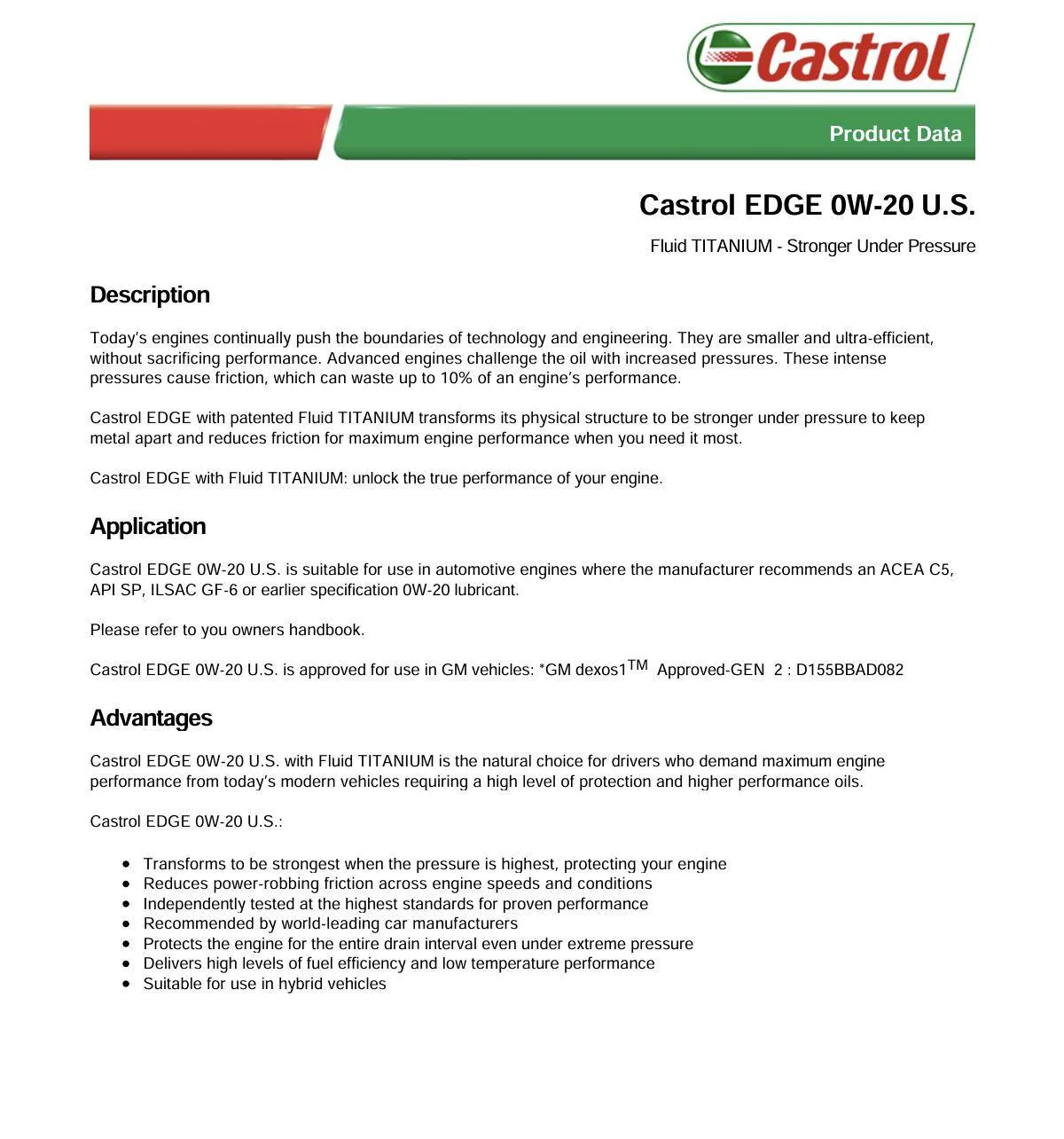

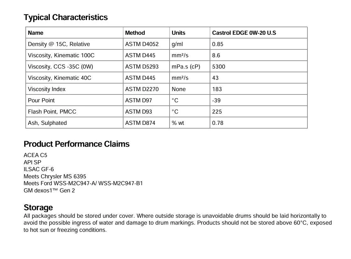

Here's a link to the normal Edge 0W20. Hopefully this works. I don't know how to post the data sheet itself but you should be able to click on it from this link. It shows the "normal" Edge 0w20 meets ACEA C5 specs.
If this link doesn't work for some reason (like my technical challenges), use Castrol's oil selector and put in a 2018 Chevy Malibu 1.5L. That's my DD and it uses the same same normal Edge 0W20. You can then get to the data for that specific version from there as well.
Fingers crossed this works....

https://msdspds.castrol.com/msdspds/msdspds.nsf/CastrolResults?OpenForm&c=USA (US)&l=English (US)&p=Castrol EDGE 0W-20 U.S.&t=PDS
Screenshots of the PDF:
Self-reply - looks like it worked! So, I will repeat, the mainstream Edge 0W20 that you can find in every retail store does meet all required specs for our cars. Freaking out over this "special GR Supra oil" is just dumb. At least for the 99% of us who are not driving around with built engines or tracking the car.

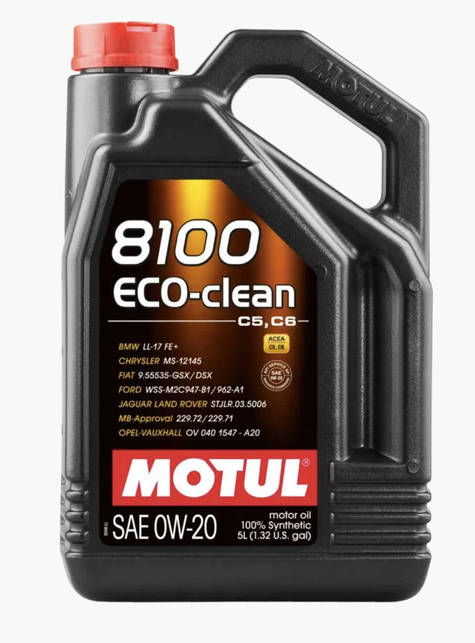

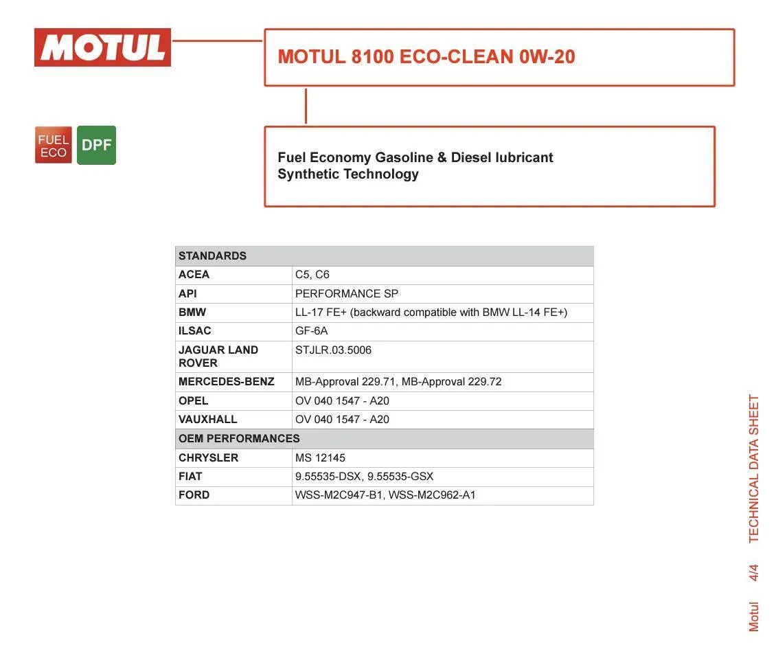

To add another option.
Motul 8100 ECO-Clean 0w-20 is LL17FE+ *and* C5 certified, and yes, it even states it on the bottle.
