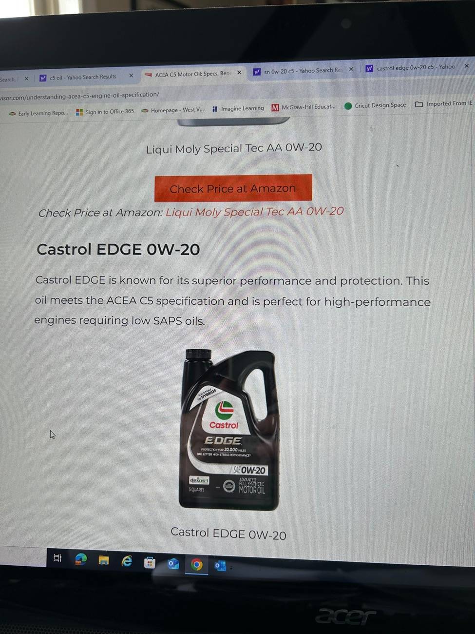

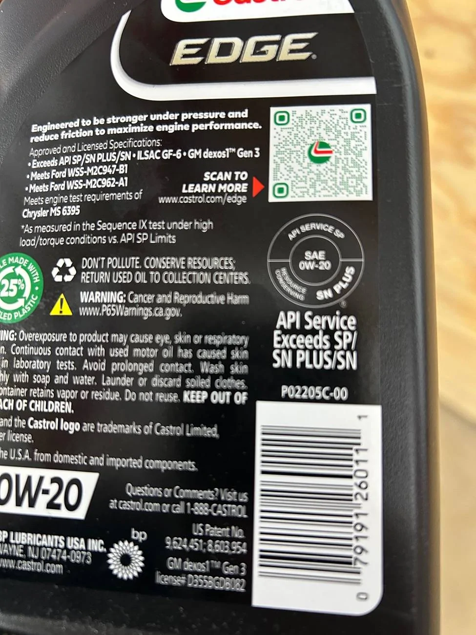

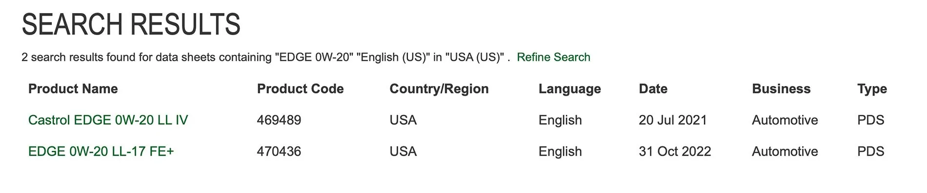

i think you're confusing the various 0w20 SKUs. the product sheet link doesn't even link to the correct 0w20 SKU.
https://www.castrol.com/en_gb/unite...astrol/newsroom/castrol-edge-0w-20-ll-iv.html
LL IV isn't the same as normal edge 0w20. the only thing that matters is what sticker shows on the bottle, and the one you posted doesn't say anything about C5. the one in the bottle is the mainstream castrol edge 0w20 SP that you can find any local retail store.
