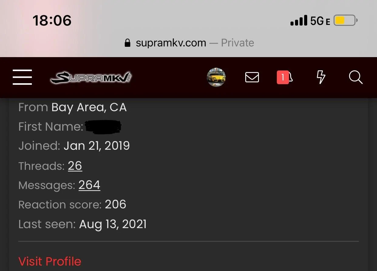

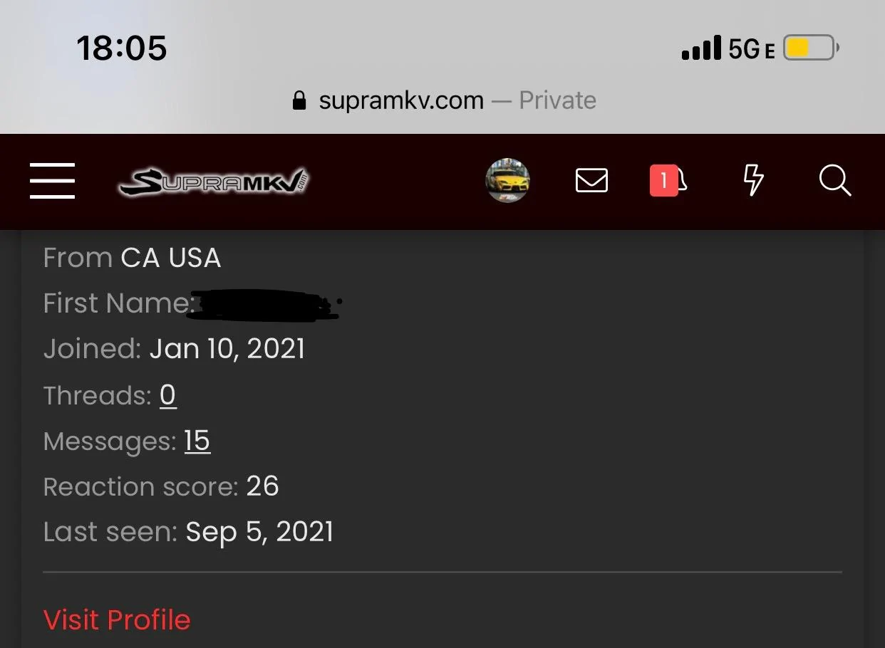

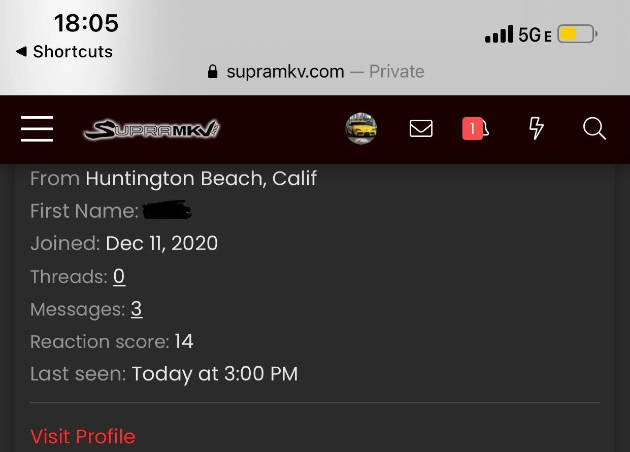

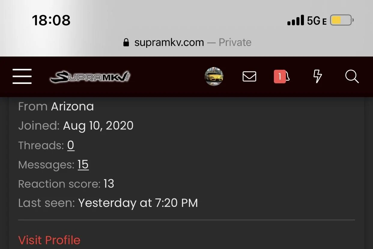

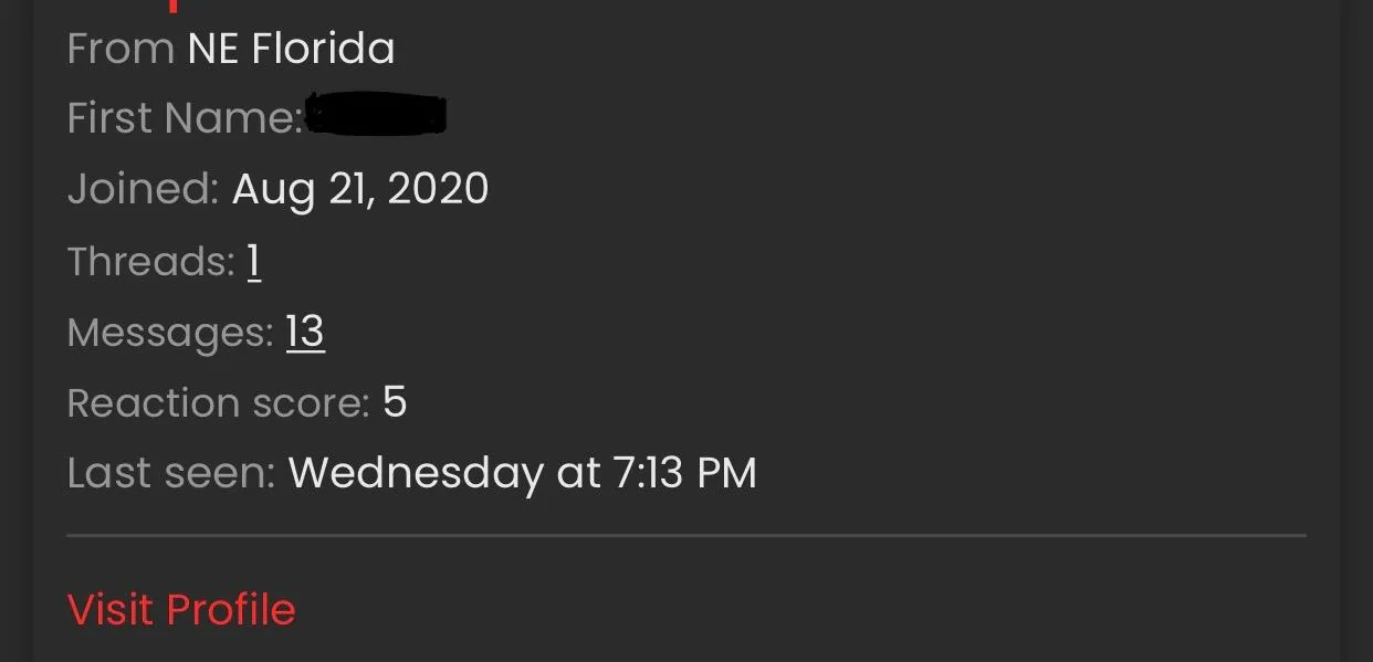

Beg to differ. There are members in this forum that documented issues on their cars with oil consumption. Their areas of location consist of places that aren't cold as shit and have done soft break ins according to toyotas recommendations. Stock cars too because these guys have or are going to file TSB's. Stock oil is shit, even normal toyota cars are having issues because other cars are running 0w-16 for "fuel economy". These engines weren't mean't to have water as oil.
i'm not gonna disclose people's usernames for the sake of their privacy but here is the general locations of the people who are dealing with consumption.
I think you misunderstood. These are all places would fall into the “consistently hot climate” bucket that I called out in my previous comment. If you are driving your Supra regularly in hot ambient temps, it would be wise to use a a heavier oil.
