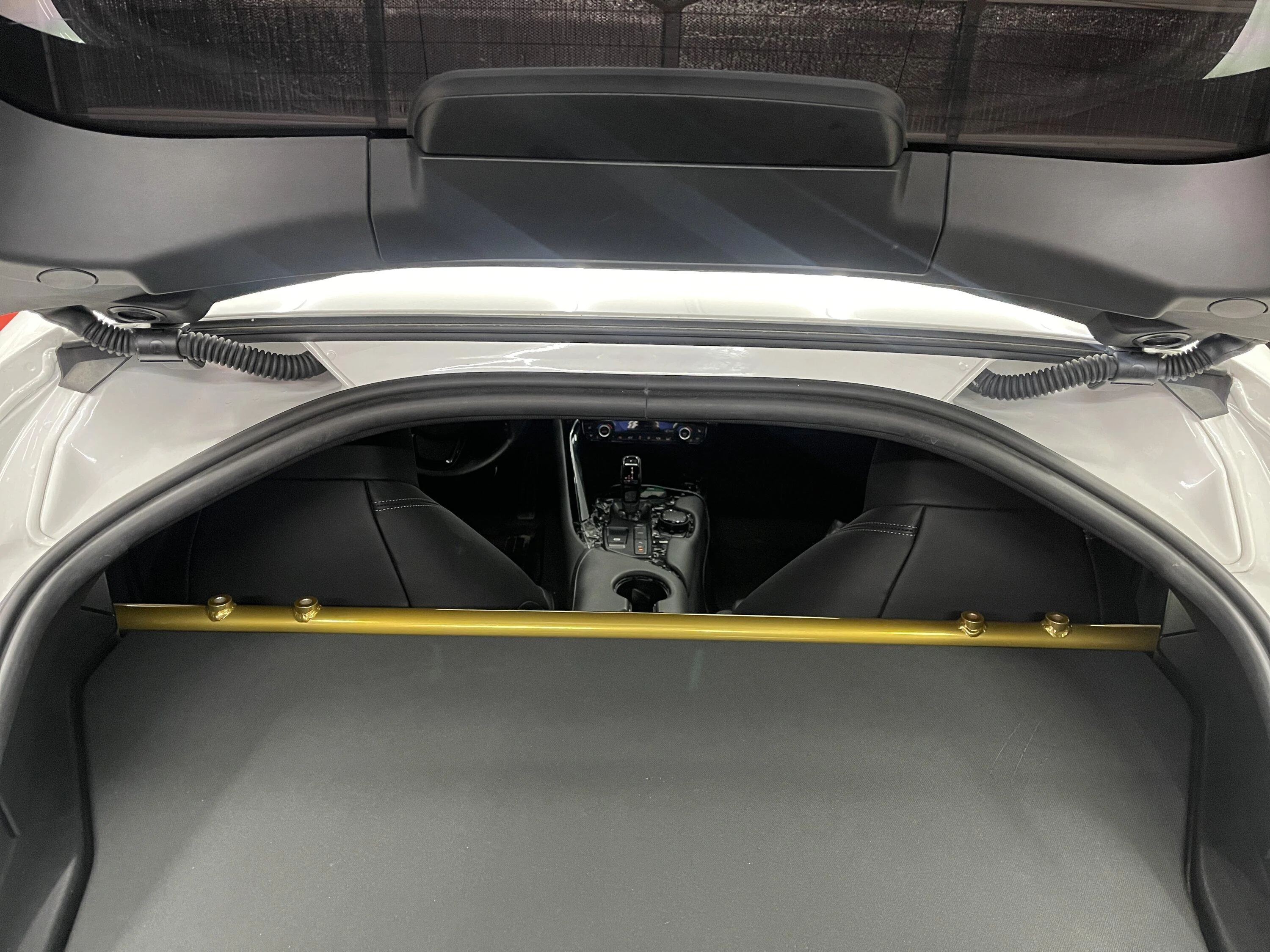

I'm jumping in here with questions. I'm not an engineer and don't know about safety from these bars but I'm looking for a little more room to move my seat back but don't want to get decapitated if someone rear ends me either. I'm not going to run harnesses, just more room. What should I go with?

Cusco or hks bars are fine if you aren’t mounting a harness to it and just want legroom.

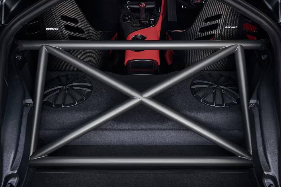

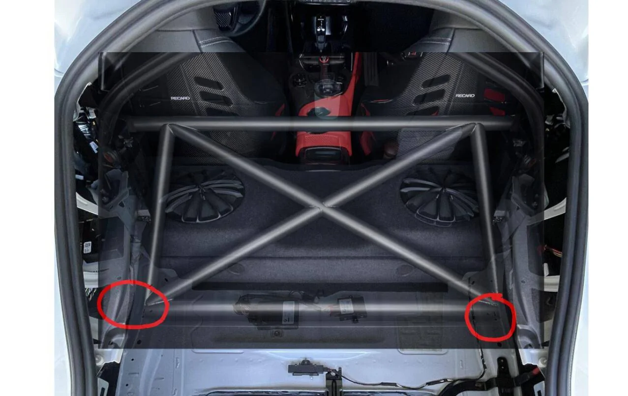

Anyone have an idea where the lower bar bolts into? Assuming top part either goes where the factory bar goes, either Cusco or USM, but I can't figure out if the bottom part bolts into existing places, or if Toyota/BMW added a dedicated spot for it.
If I had to guess, it would probably make use of some of these holes in the chassis. The scaling isnt quite correct but you get the idea
