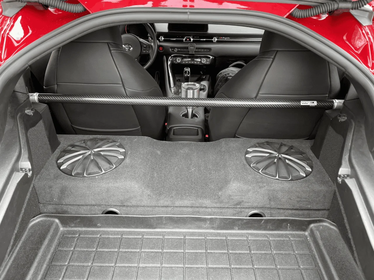

Do any of these rear bars grant any additional space to move the seat back a little further?

Besides the carbon fiber which is just an aesthetic replacement and the beefy yet pricey Hochman, has anyone noticed any increased stiffness at all from the others like USR or Cusco?

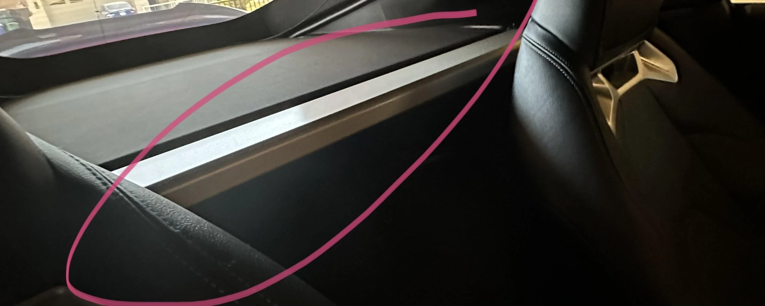

Looking to get an aftermarket part for this, Im not a huge fan of the silver, any recommendations or pics you guys have?
Remove it and take it to your local Anodiser and ask him to anodise it sating black. Easy.

I went with the HKS carbon brace.
The additional space it creates to move seats back is nice byproduct.
Any difference in feel? Nope. Does it help with stiffening? Maybe.
I'm sure the oem piece has been through plenty FEAs with engineers, so I wouldnt see why this bar would be upgrade nor downgrade from factory bar.

Other then being used for a harness, does any
Aftermarket bar such as these stiffen chassis?
Pizza
Mitch
Mar 2, 2022
209
293
Michigan, USA
Potentially... The Cusco bar is definitely stiffer than the thin OEM piece, so under the right load it could in theory stiffen it up a bit, but the Supra already has a very stiff modern chassis and so theres no real reason to "upgrade" the stiffness unless you were doing a cage for an actual racecar. Toyota said that it's stiffer in rigidity than an LFA
