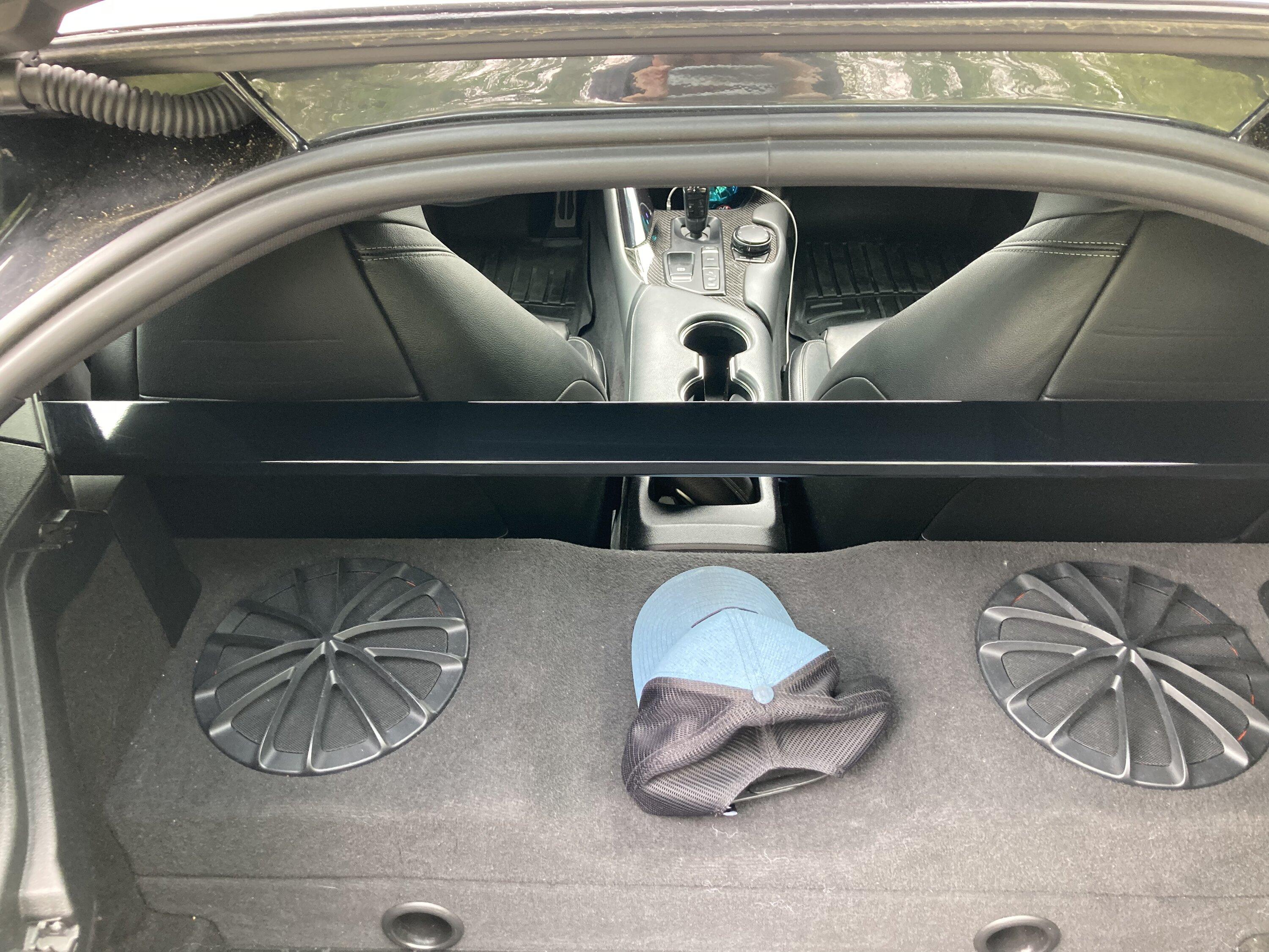

Has anyone switched this bar out?
RaceReX
Rod
Mar 23, 2023
83
83
Bay Area.NorCal
2022 3.0 Premium, 2009 SRF
Qu
Potentially... The Cusco bar is definitely stiffer than the thin OEM piece, so under the right load it could in theory stiffen it up a bit, but the Supra already has a very stiff modern chassis and so theres no real reason to "upgrade" the stiffness unless you were doing a cage for an actual racecar. Toyota said that it's stiffer in rigidity than an LFA
quick question.
how do you know the Cusco bar is stiffer Than the stock bar?
and I hope you understand that the only difference that matters, as far as chassis rigidity, is tension and compression. Not torsional rigidity or shear modulus.
thanks,
rod s

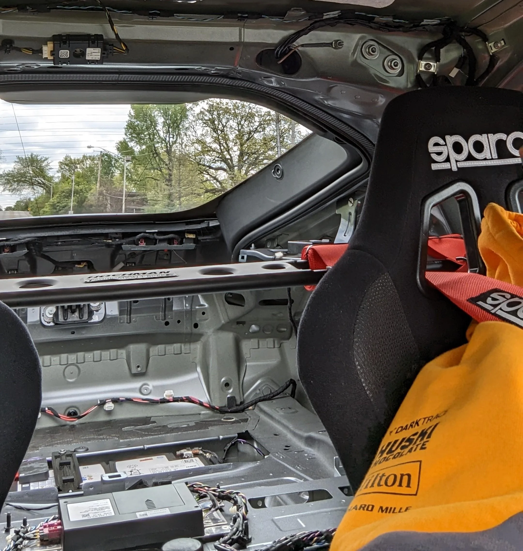

Why bother? I needed a place to attach harnesses due to the safety regs I'm working within and I like doing things the difficult and expensive way. I also wanted to see Ben's work because I'd like to convince him to take on a custom project (not the Supra but a Lemons car I'm considering building). I'm impressed with the quality of the component and the craftsmanship that came out of his shop. I'd recommend his product.
I personally don't like any of the roll bar options currently on the market for my application. They're made to be used with the interior still in the car, so from a space utilization perspective, you're losing a lot of it if you use something bolt-in. They're also outrageously expensive for what you're getting, or are produced by a foreign company, and freight to the US would be extremely costly. My path is a custom roll bar, and there's no one around here I would trust with the job, so I'm shopping around. I'm not going to let the car sit while I line something up.
I disagree with you about the mounting points not holding. You made the claim and I'd like to know your basis for it. There are thousands of these cars driving around counting on the harness bars being an effective safety device.
Call a reputable cage builder and ask them. They will say it’s not a good idea for a wide range of reasons.
Just because there are thousands of people doing this doesn’t make it a good idea. Many of these bars are only rated or tested to DOT standards(if they even test them), which is not even close to the same thing as SFI, ASN, KNAF, FIA, or NHRA specs. These parts won’t carry one of those ratings because they simply aren’t strong enough. Anyone that builds structural parts knows a straight line with a perpendicular load isn’t going be strong enough for an application like this and that’s why all cages use a collection of triangles supporting the direction of loads it’s designed to hold.
That being said the mounting point holding or not is just one of several issues with these bars. Call a cage builder and get their opinion if you don’t (rightfully) believe people on the internet.
edit: example of an honest part description: https://www.northstarmotorsports.co...ars/manufacturer/Brey+-+Krause/productID/1865

Qu
quick question.
thanks,
rod s
The stock bar is aluminum, and the Cusco bar is steel. Generally steel has a higher yield strength and tensile strength than aluminum. It also has as a Young's modulus that's much higher than aluminum, making it much stiffer.
Obviously this may not directly translate to just popping in the bar and having a X percent stiffer chassis in that area, because we don't know how forces acting on the car translate to the bar, but the Cusco bar is stiffer. That's why I said it potentially could have an effect under the right load, but there's no performance based reason to actually do it.

I filled mine with expanding foam because I couldn't get it to stop being the source of a rattle. Then wrapped it gloss black. Looks much better. I didn't like the holes it left when I removed it, as it likely helps very very very little, if at all.
Any pics? I wish someone made a block off plate. That thing is a rattle trap

The 4 threaded bolt holes on the bar, are those standard 7/16" "seat belt bolt" threads?

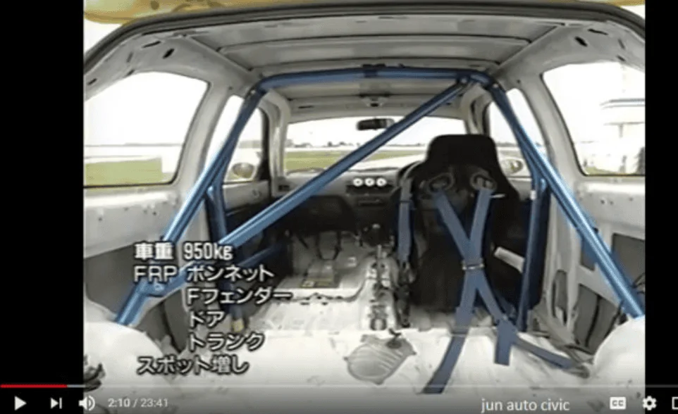

8,846
17,339
While I agree with the logic of harness angle, I should point out that this is a SFI rule, and thus mainly apply to US racing bodies (NASCAR, NHRA, SCCA/NASA, etc).
The most notable difference is that FIA does not regulate shoulder harness angle. This is why you see so many professional racing orgs in japan and europe that have very low shoulder harness angles. Puma GTO was in Super Taikyu, which is FIA. Sard Supra, Endless Skyline, Pennzoil Skyline and Calsonic Skyline were all JGTC (now SuperGT), which also followed FIA ruleset. I went on a deep dive on best motoring videos and gathered a bunch of screenshots into an album here awhile back:
I don't think I would use that image for any safety reference. That main hoop doesn't have a lateral bar or a cross bar. That thing would only hurt you more than having nothing in a significant accident.
It's like saying helmets aren't needed and showing drivers on the Nurburgring driving 160mph without helmets to prove your point. ;)
Those Cusco death cages always make me laugh.

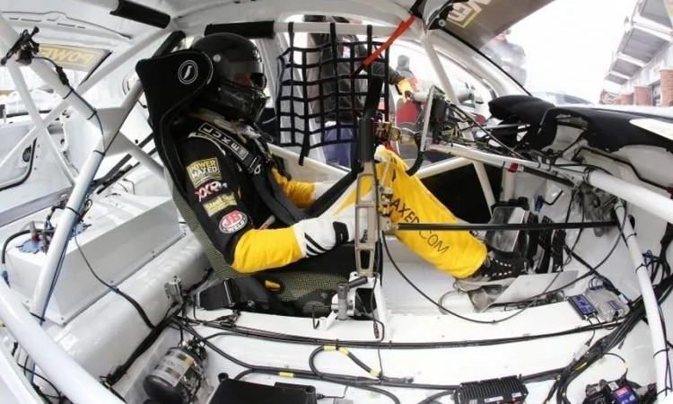

Note that album has 30+ images, including the fia spec cars I mentioned.
8,846
17,339
Yea totally, was just calling out that specific image. Also was not being critical of your overall post, just to be clear.

Doesnt change the fact that they are all installed wrong. Some racing orgs have really good tech inspections and some dont. Most of those belts were takata:
https://www.hmsmotorsport.com/doc-share/ea_12-1_takata_2021-10_online.pdf
https://images.carid.com/takata-racing/products/pdf/70002us-0-installation-instructions.pdf
http://teinusa-blog.com/using-racing-harnesses/
Just because a bunch of people do it incorrectly without following the very specific manual that comes with the harness doesnt mean its correct. FIA has a drawing number: 253-42 which shows the angles and over the years it was updated from -45 to -20 acceptable, to -45 to -20 not recommended, to finally only stating 0 to -20 this year.
If you look at photo 9 in that album you can see that the harness is much higher then the drivers shoulders. There might be some seats that are legal to mount this way (which would stop the downward force on the spine) but many are not and it can cause seat failure during a crash from the loads in the downward direction (A fixed back seat will do better then an adjustable in this case). Generally this means the seat was not sized correctly to the person. An average street crash at 30mph is ~30g of force, or 5,500 pounds for an average weight person. Racing crashes are even higher, if you put a force somewhere it wasnt designed to be it will bend or break.
This is the comp doc I was looking for, this is their competion spec from 2017: https://www.fia.com/sites/default/files/hans_guide_and_instalation_spec.pdf
Its really simple. If you purchase safety equipment, read the manuals and install them correctly as a functioning group. If they arent followed, they will not work correctly.
