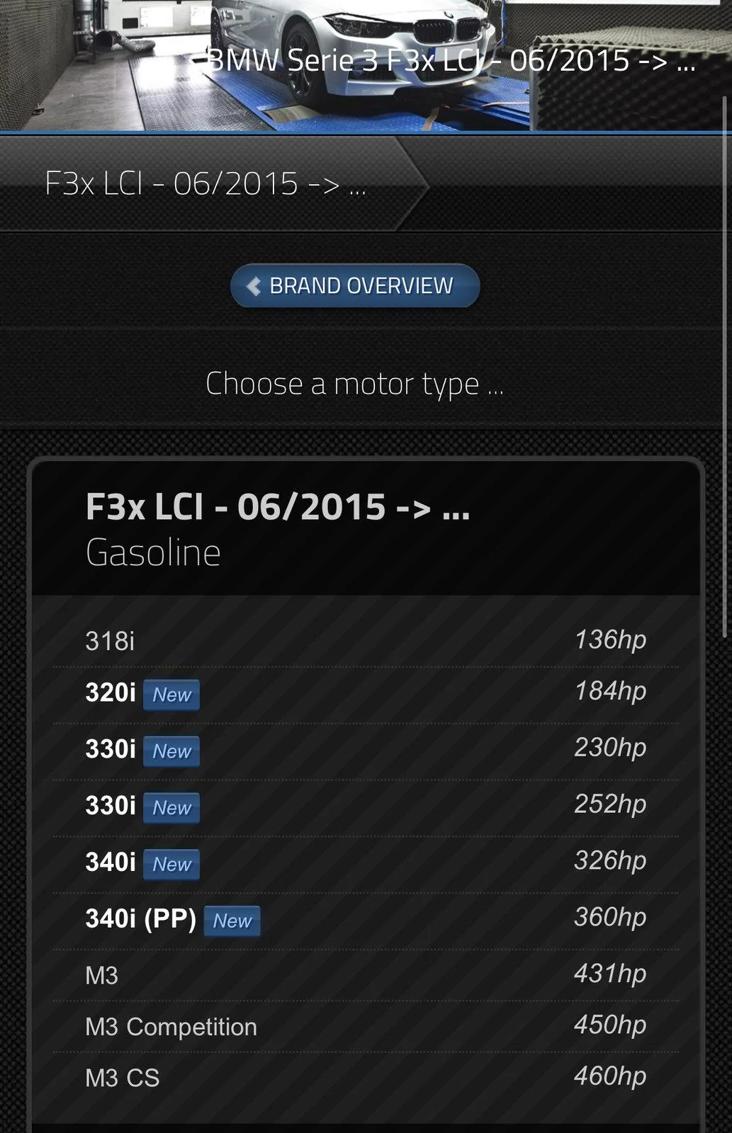

For information brperf have recently cracker all serie 3 bmw.
It’s posible not easy :)
Sometime only one solution open the ecu

I understand why brperf have strangely publish all this update ^^
Do you now the method used for crack ecu?
