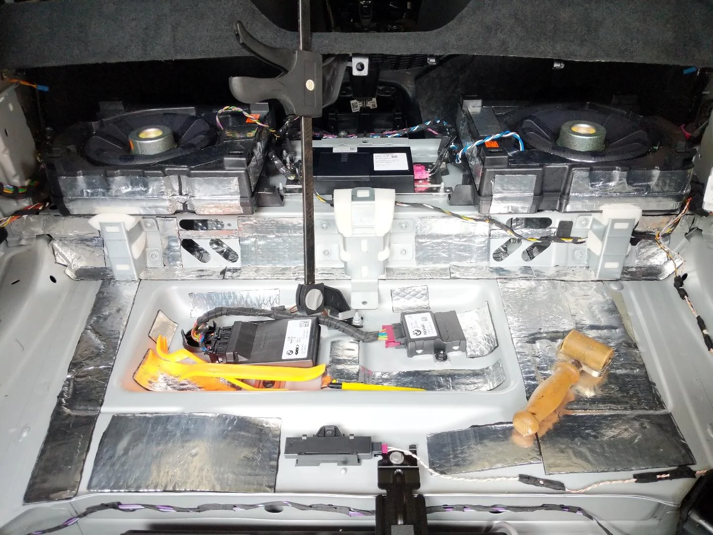

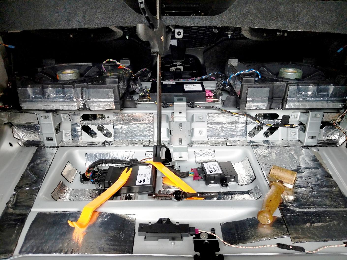

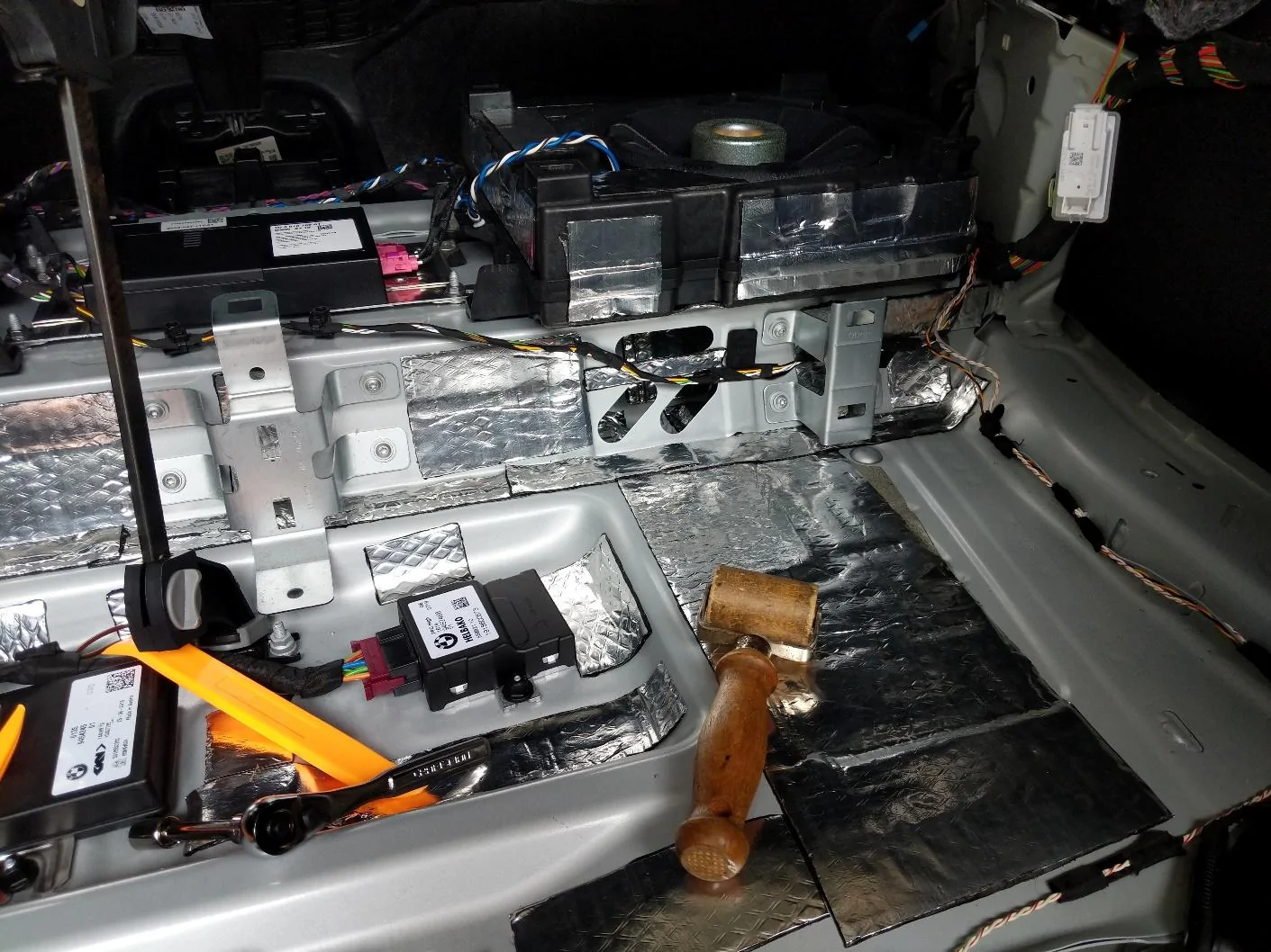

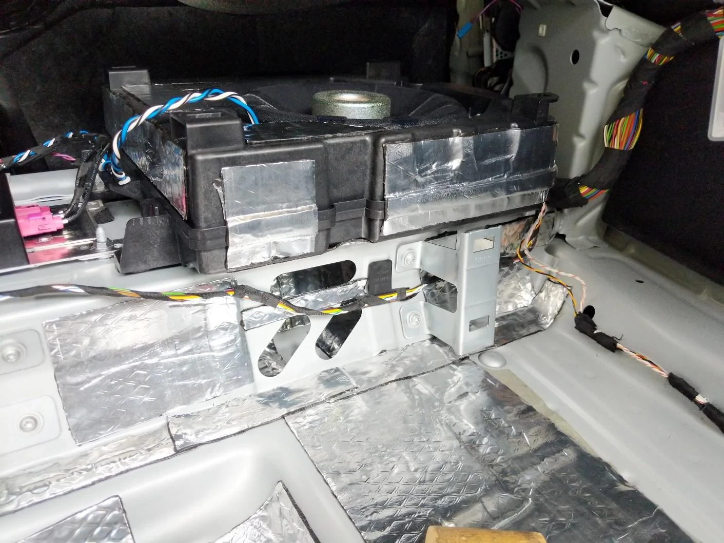

(3) Rear Lower Deck
This are is pretty straight forward. I just did section strips being sure to not cover any nuts, bolts, wires, etc. You don't have to cover an entire piece of metal with dampening to change the vibration response of the metal. Of course, the more the better, but any amount will have some affects.

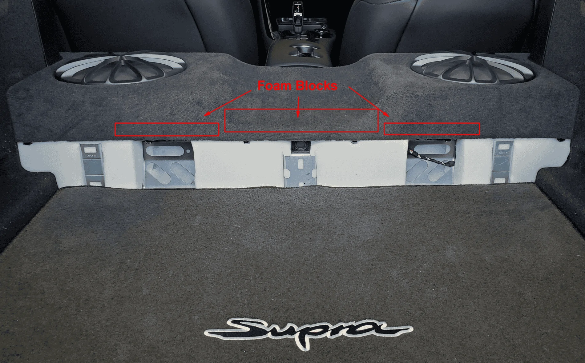

You really don't need to take the car apart...I also don't think those areas on the black plastic subwoofer enclosure are necessary....I've already explored them and the way in which they are designed those surfaces will not cause any vibrations...
Try stuffing some foam blocks in the area shown below....

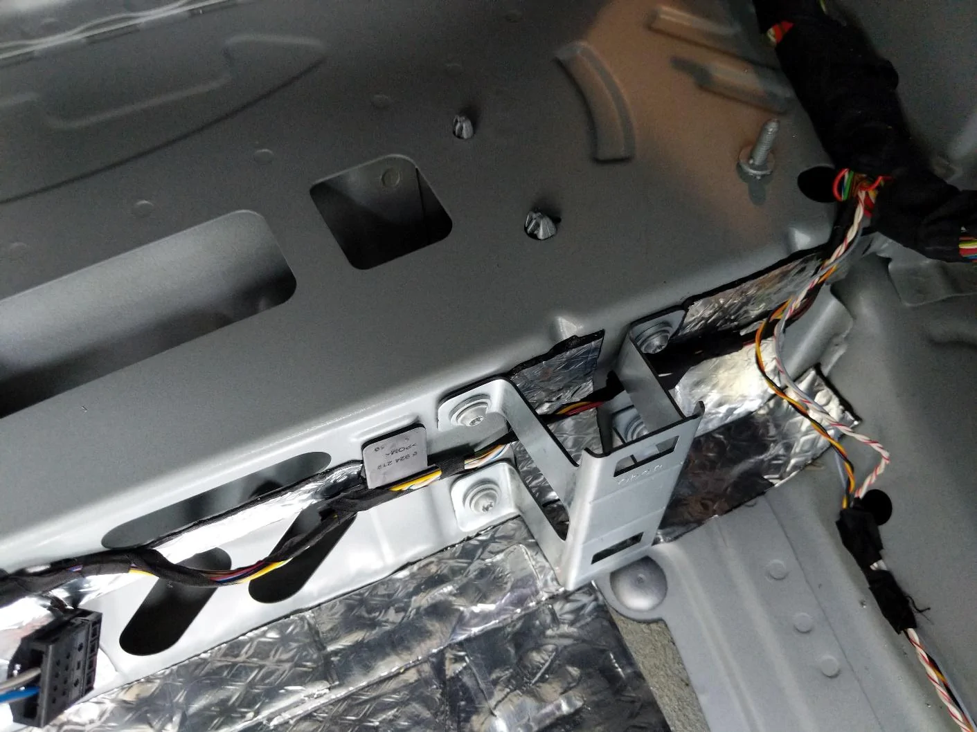

For those that have completed this project, which involved lining the walls of the speaker enclosures, placing foam insulation between enclosure and narrow rear panel, and adding exhaust ports, I've also identified that there is one final area that needs to be addressed....
I discovered this after implementing all these other improvements, thus allowing me to significantly increase volume along with raising bass EQ settings...What I found was that there was some exhaust port energy escaping from under the long narrow rear panel (which as I show in a few pics below) causing the rear floor panel cover to vibrate...Keep in mind that this is yet another design problem which causes the floor panel cover to vibrate where in-turn this vibrational energy is transferred to the cargo areas' side and back panels causing them to vibrate as well...
The solution here was to apply some adhesive back foam to the areas show below which eliminated any energy transfer under the rear floor panel cover...

Next, the image below shows where some exhaust energy from the 3 elongated ports was also being released under the large rear floor panel cover causing it to vibrate greatly...With the floor panel removed simply place your hand under the narrow panel and you'll see / feel the exposed gap ...
Below shows locations where 2 adhesive back foam strips were applied to underside of exposed narrow rear panel ...The left adhesive backed foam strip was 1.5"D x 11" L x 0.25" H and the right foam strip is 1.5"D x 6" L x 0.25" H...This essentially sealed off the gap where the exhaust energy was also being channeled...
As a result the large rear floor panel cover vibration has pretty much been eliminated and side and rear trunk panels no longer vibrate during low bass / high volume music passages....
