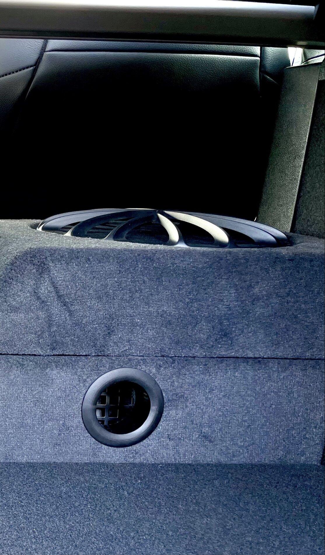

Installing Rear Panel Exhaust Ports...
  1. Cover the front carpeted area of narrow rear panel to be cut with blue tape and mark a 2" diameter circle
  2. Use either a 2" hole saw or a dremel tool with disk to cut out the marked circle
  3. Use a small dremel grinding drum to finish the edges of the port hole
  4. Cut the black OE panel insulation in the the center of hole and fold back on either side
  5. Insert 2" exhaust port
  6. Use tie wrap to hold thin black OE panel insulation along side walls of exhaust port
  7. Secure port to rear panel with drops of epoxy or superglue at edges touching rear panel and port walls
I also placed black metal speaker mesh (4" x 4") over the three elongated holes and secured in place with 3m tape...

Shown below is a pic of the finished project:
