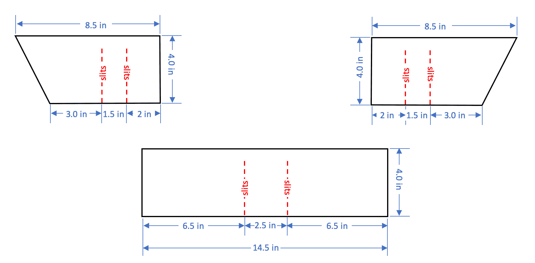

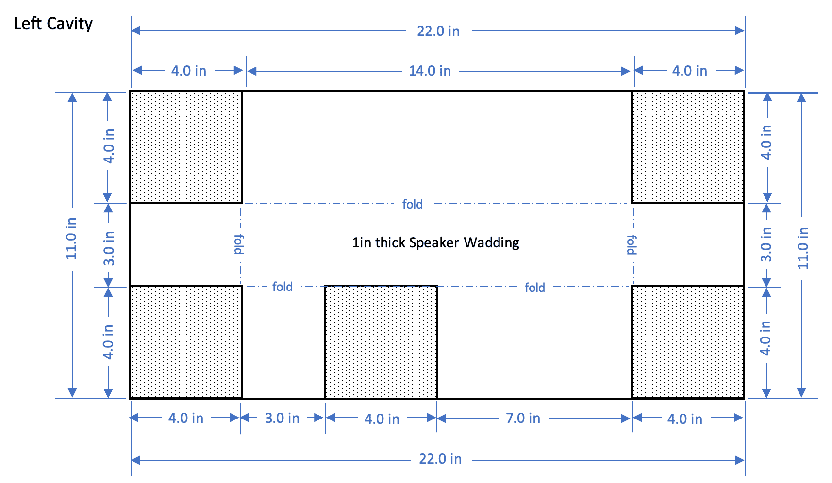

tadda ... love the added details.
here are some contrabutions for your first post ... I've attached template drawings I made for your wadding and foam. I did these to make sure I had the right dimensions ... LOL
Thanks! :thumbsup: I added images to first post...

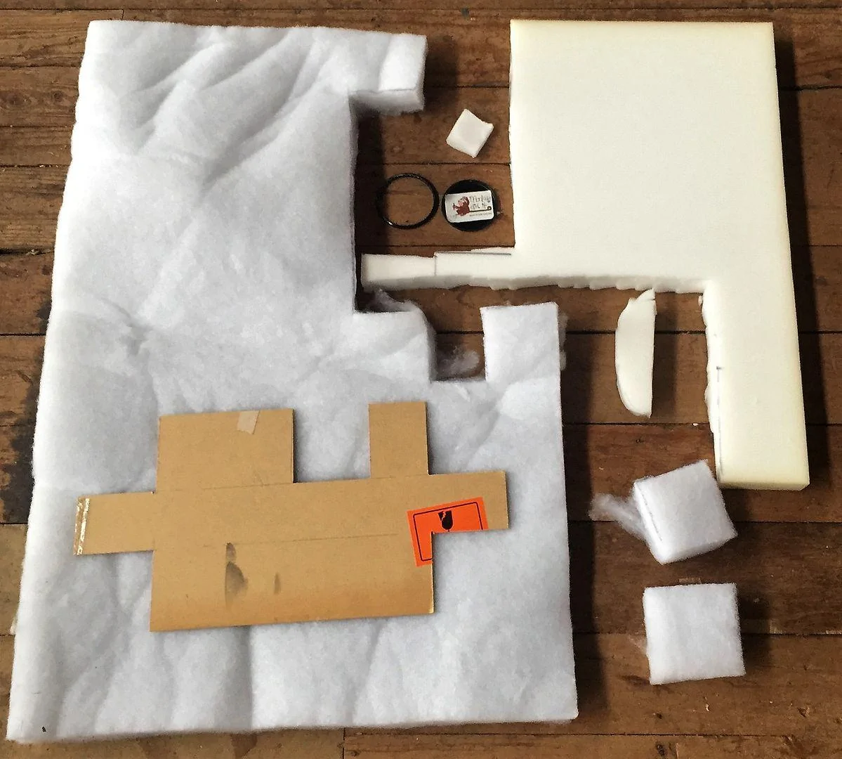

I've gotten 2 of the three items I'm waiting for. I've installed the ports and am going to stuff the two enclosures, just need the foam to arrive.
This is fun.

Got the vents in, cut up a pencil holder for mesh, wadding cut, looked way too thick at about 2" uncompressed so split it in half, about to poke it in after lunch :)
Making good progress!
They stack 2 sheets of wadding on top of each other...I found each sheet was just a little over 1" thick...
I had to get all my stuff locally so it was a case of "that will work" :)
Will post a few pics when finished including left over bits :D

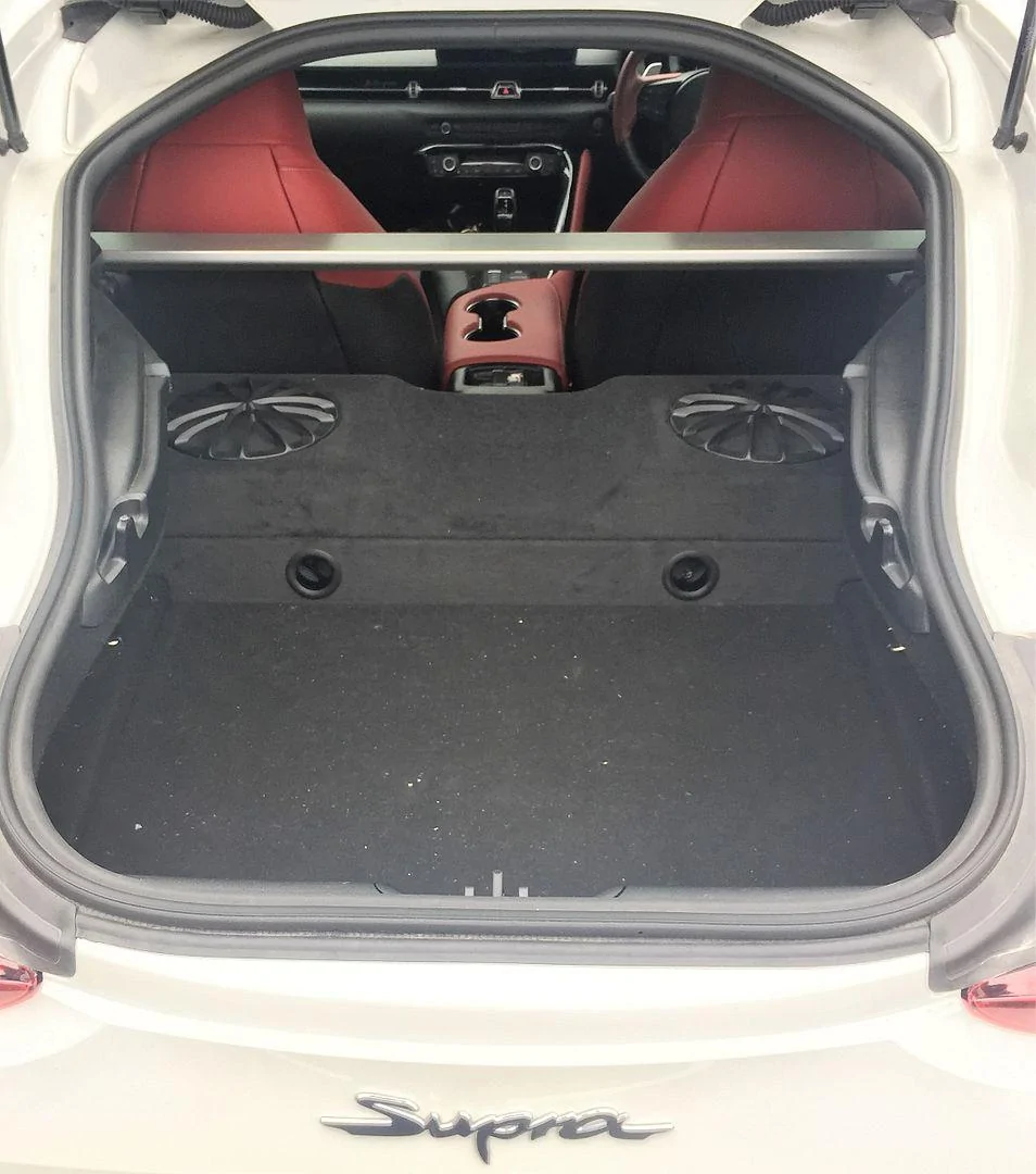

All done, thanks tadda the difference is great even to my old abused tinnitus ravaged ears :headbang:
Sitting in it now listening to my favourite Cure songs as i post this :cool:
Here is what I had left over
Used your setting as well, once again thanks so much :bow:
Congrats!!!
Glad to hear it all worked out and your pleased with the results....:thumbsup:
