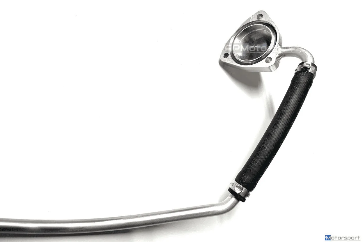

In the past BMW has had OE oildipsticks for the F82 M4 GT4 (S55) engines/cars.
It does replace the oil level sensor.

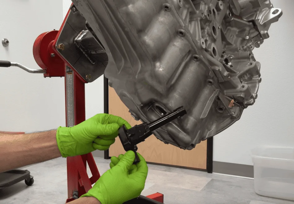

A kit exists as a retrofit for S55 and looks like N55:
https://www.bimmerworld.com/Engine/BMW-Oil-System/GT4-Engine-Oil-Dipstick-Retrofit-Kit-F8X-S55.html

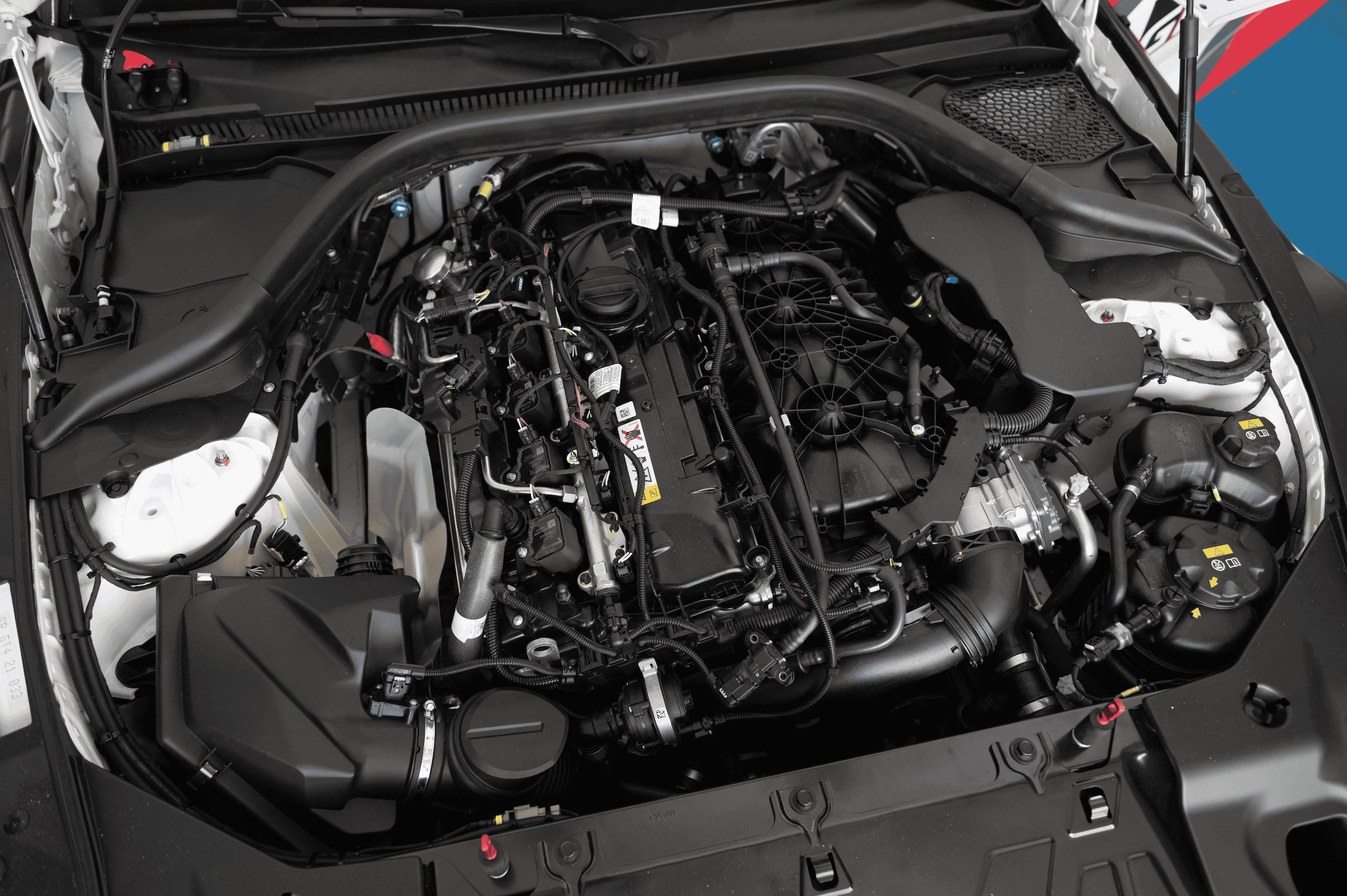

Since the Supra GT4s uses the B58, I'm wondering if the GT4 cars have a dipstick. ?
However, I do not see an oil dipstick in the GT4's engine bay, maybe someone can spot it.
S55 GT4 retrofit:
Supra GT4 engine bay:
I know.... My main issue was that to truly get the measurement right, everyone would need Bimmerlink to check the actual full level, then trim the stick to fit. I figure most people wouldnt want to do that. This wouldnt have been an issue if I had the tube made from steel, with a 90° angle instead of rubber line but then I dont think you would be able to install it since there is not much room in the engine compartment. So ya, I gave up.
BMW motorsports used a rubber hose between the part and the neck.
But the part comes from the oil level sensor location.
Maybe a similar implemenation can be done.
It would be CRAZY if the same part works and just need a different neck to fit the engine bay.
Then we all would be fighting for this retrofit kit.

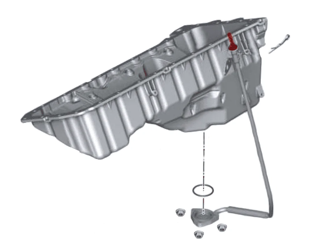

S55 oil dipstick:

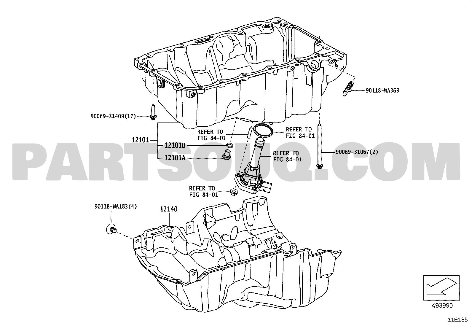

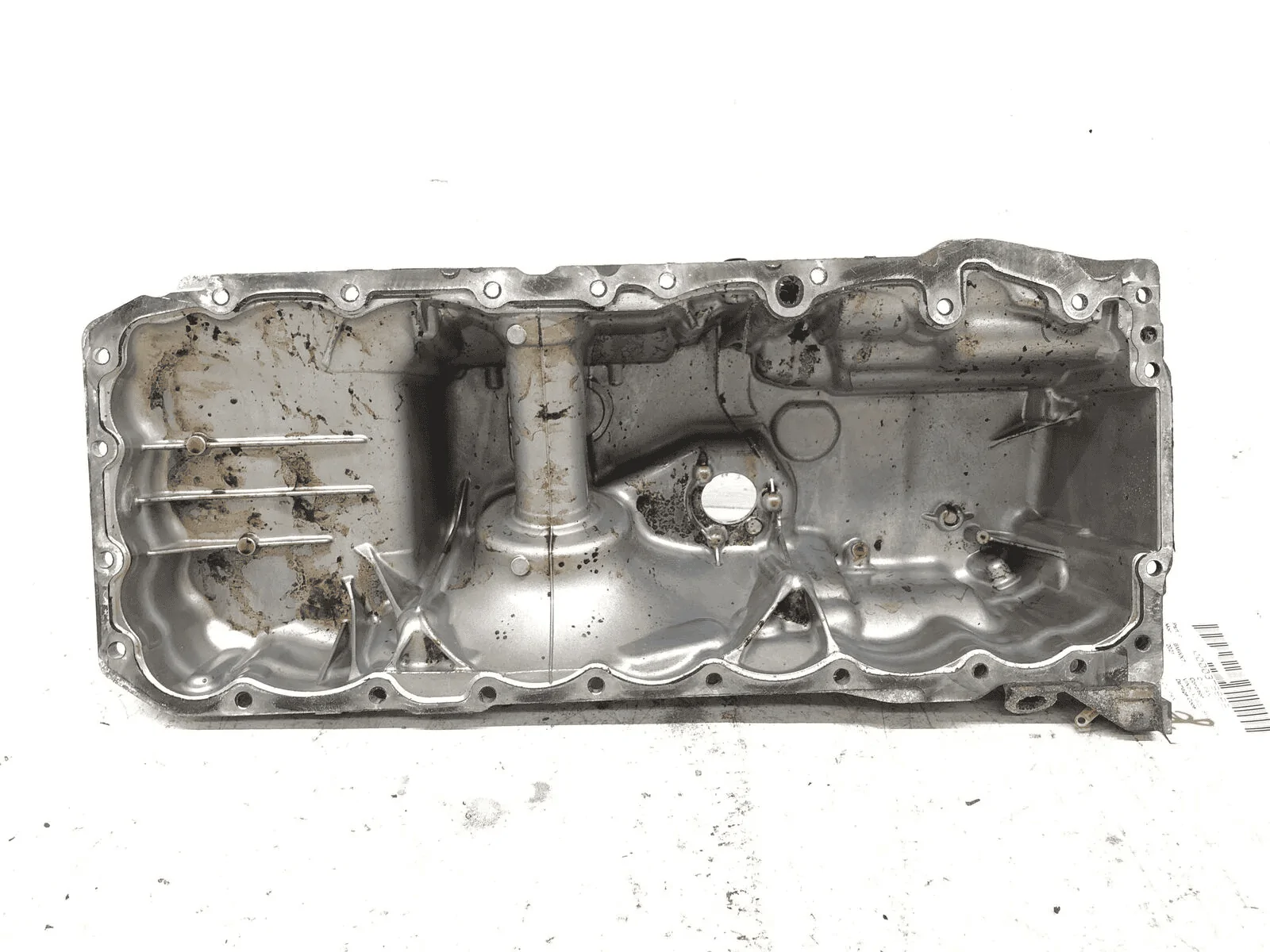

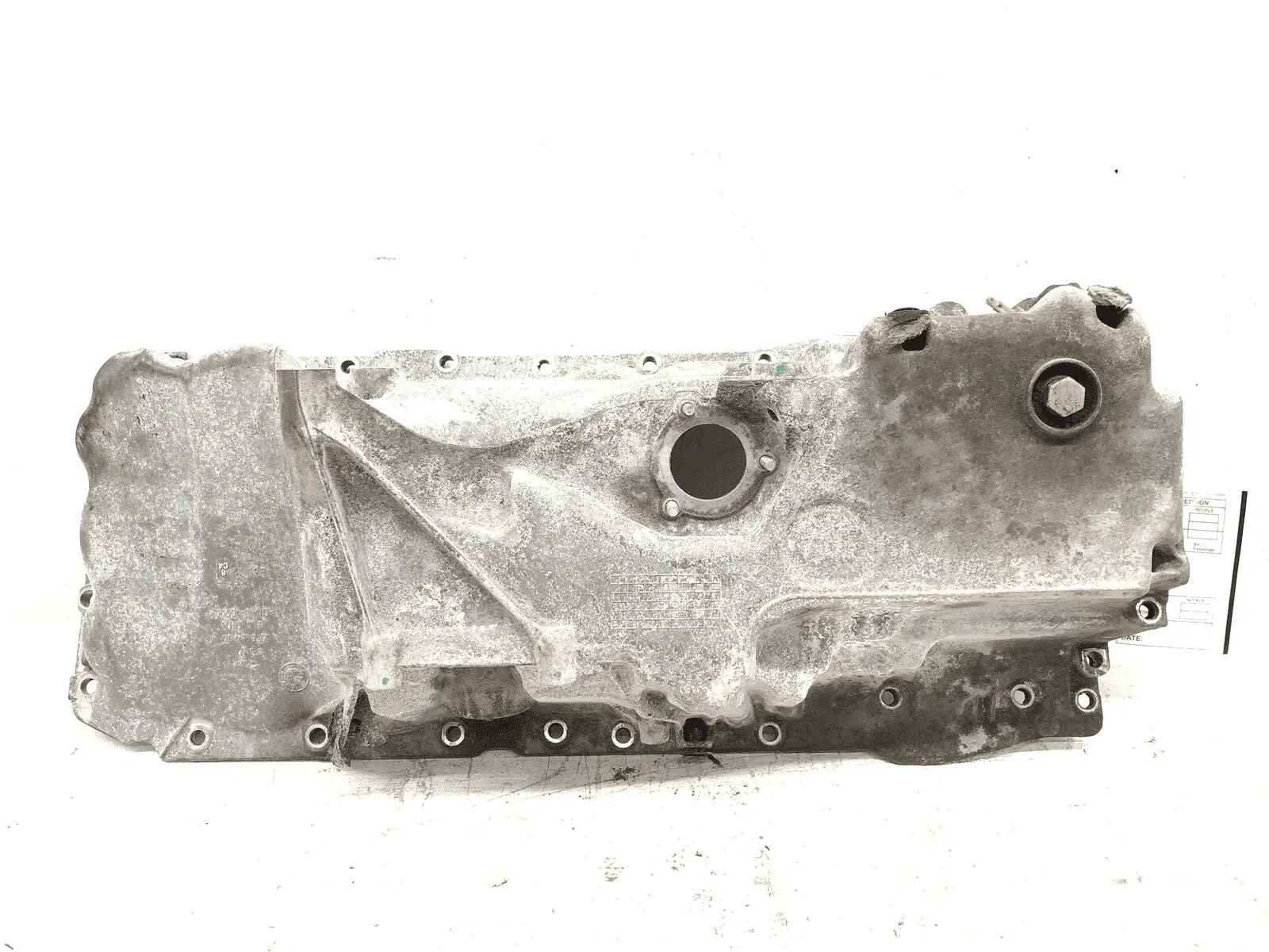

B58 oil pan:
From a B58 (Gen1 i think) 2018-2022 X7 xDrive (couldnt find any Supra oil pan pics):
https://www.ebay.com/itm/155516433583

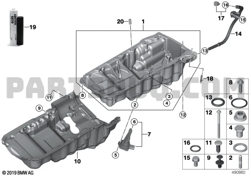

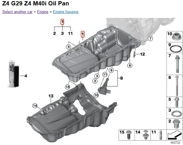

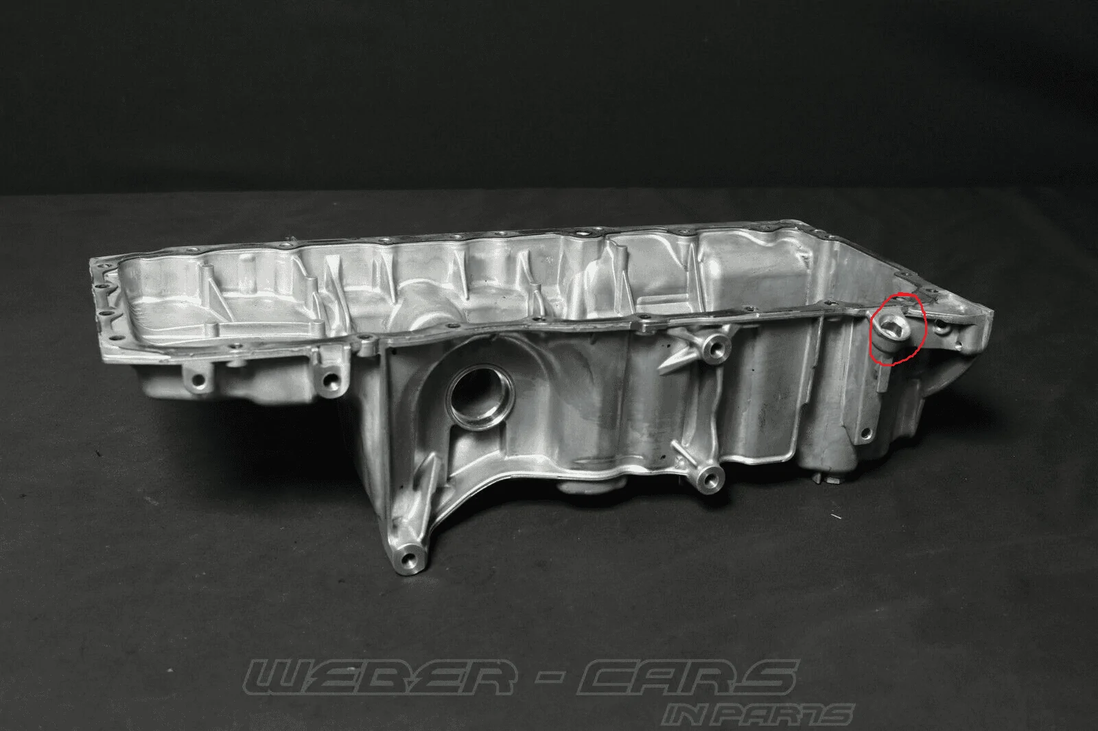

The B57 oil pan has a dip stick. The oil pan between whatever is on the G05 B57 cars is the same as the one on the supra. So if one really wanted a dipstick, you could probably just swap over one of the B57 parts over with no problems. It retains the electronic oil sensors so I doubt anything has to be coded.
Diagram of the B57 oil pan, with electronic oil sensor, combined with the dip stick.
B57 Oil Pan on the G05.

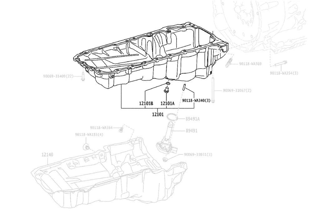

Supra oil pan diagram (I couldn't find any pictures of the oil pan).
From Papadakis' teardown video, the provision is not there.
The pans are different, no idea if a pan swap would work either.
The front section is also different, I assume to clear the subframe.
