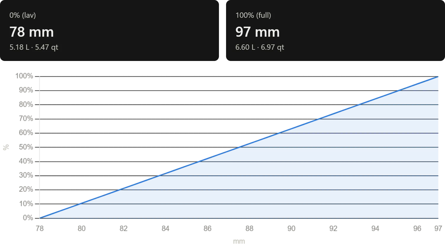

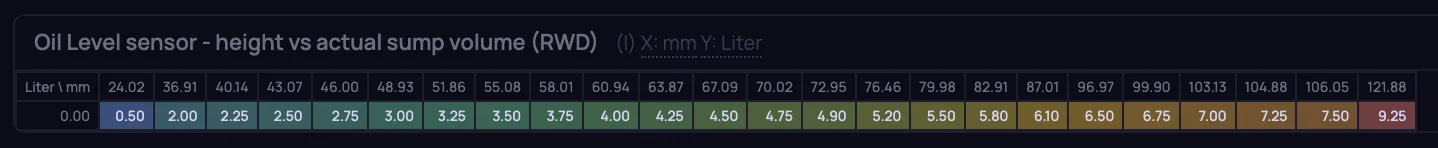

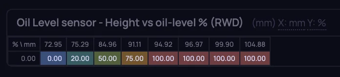

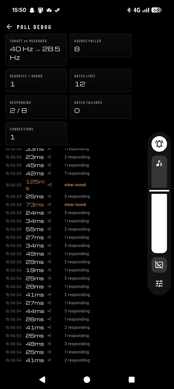

Based on the numbers from this post:
https://www.supramkv.com/threads/oil-level-analysis-with-ecutek.10943/#post-182251
I made this chart and added the values to an app I'm working on, so I can display it as a simple percentage bar.
I'm not 100% confident in these numbers though, and would much rather have the actual values from a confirmed table.
@razorlab, is this something you could help with? I've spent hours going through BINs, HEX, A2Ls and XDFs, but I just can't seem to find the correct values.
Any help would be much appreciated!
