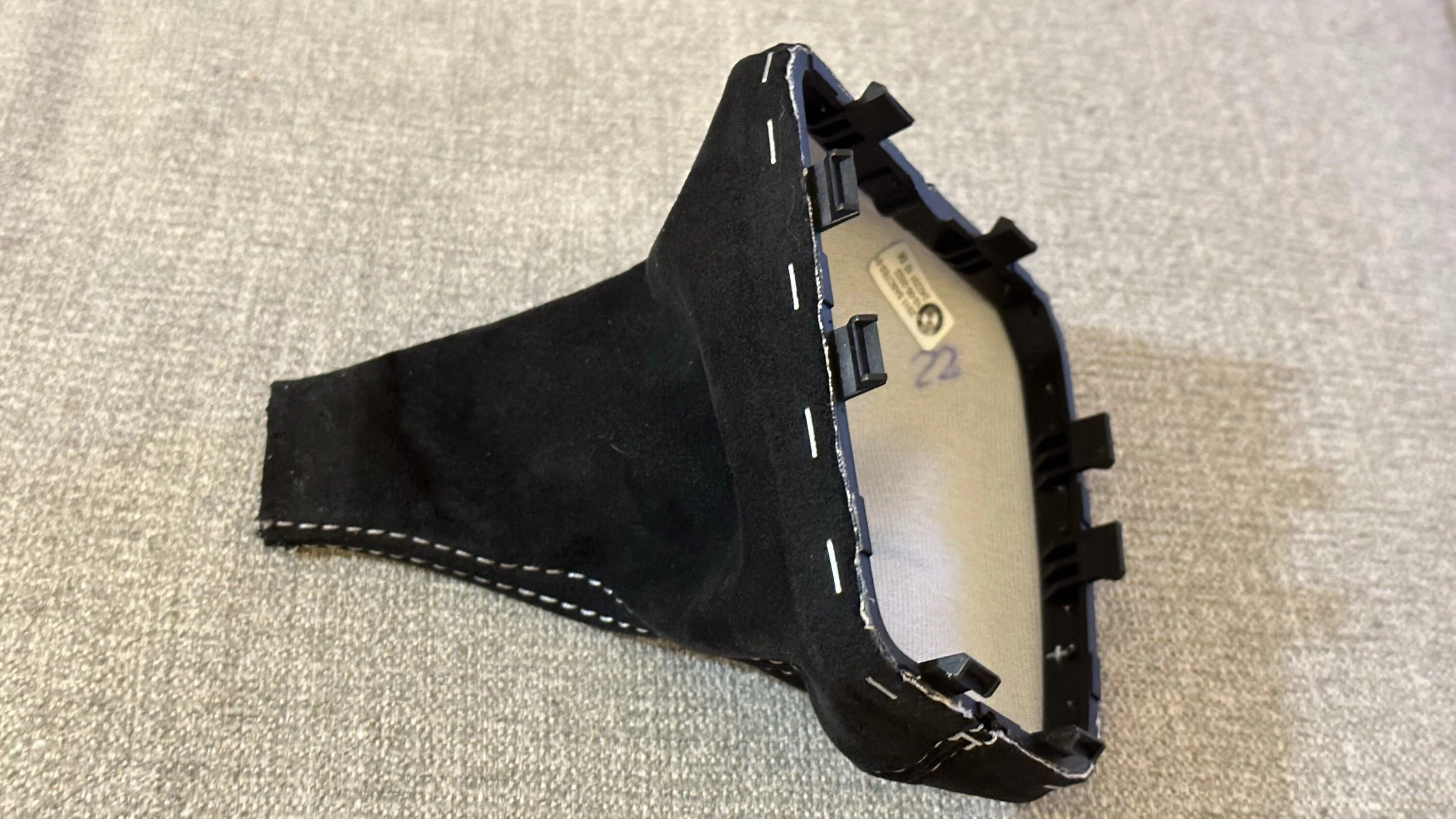

If you ever find the plastic bezel for the boot sold by itself please share. I'm gonna be trying to make a mold out of mine to cast a few spares out of epoxy and maybe make the piece a bit thicker to add some strength. Just hope I can get the staples out without ruining it.
This? Our cars need the NTA version of the collar.
https://raceseng.com/products/shift-boot-collar
or are you talking about the plastic trim ring that’s attached to the leather boot that snaps into the center console?
Yeah the plastic trim. I searched for the PN on the sticker that mine has but no luck. tried to 3D print similar ones but matching the shape has proven to be a pain.

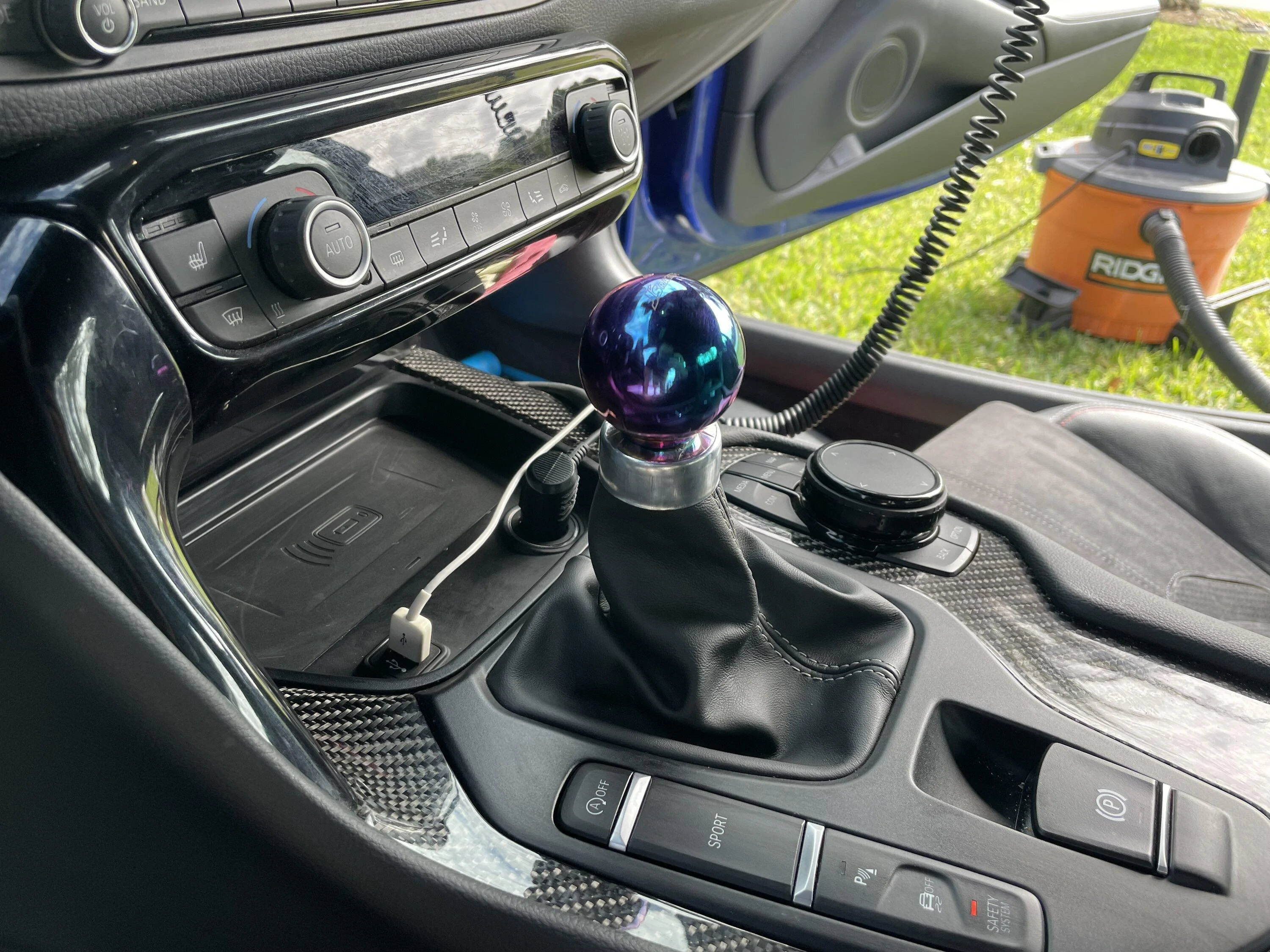

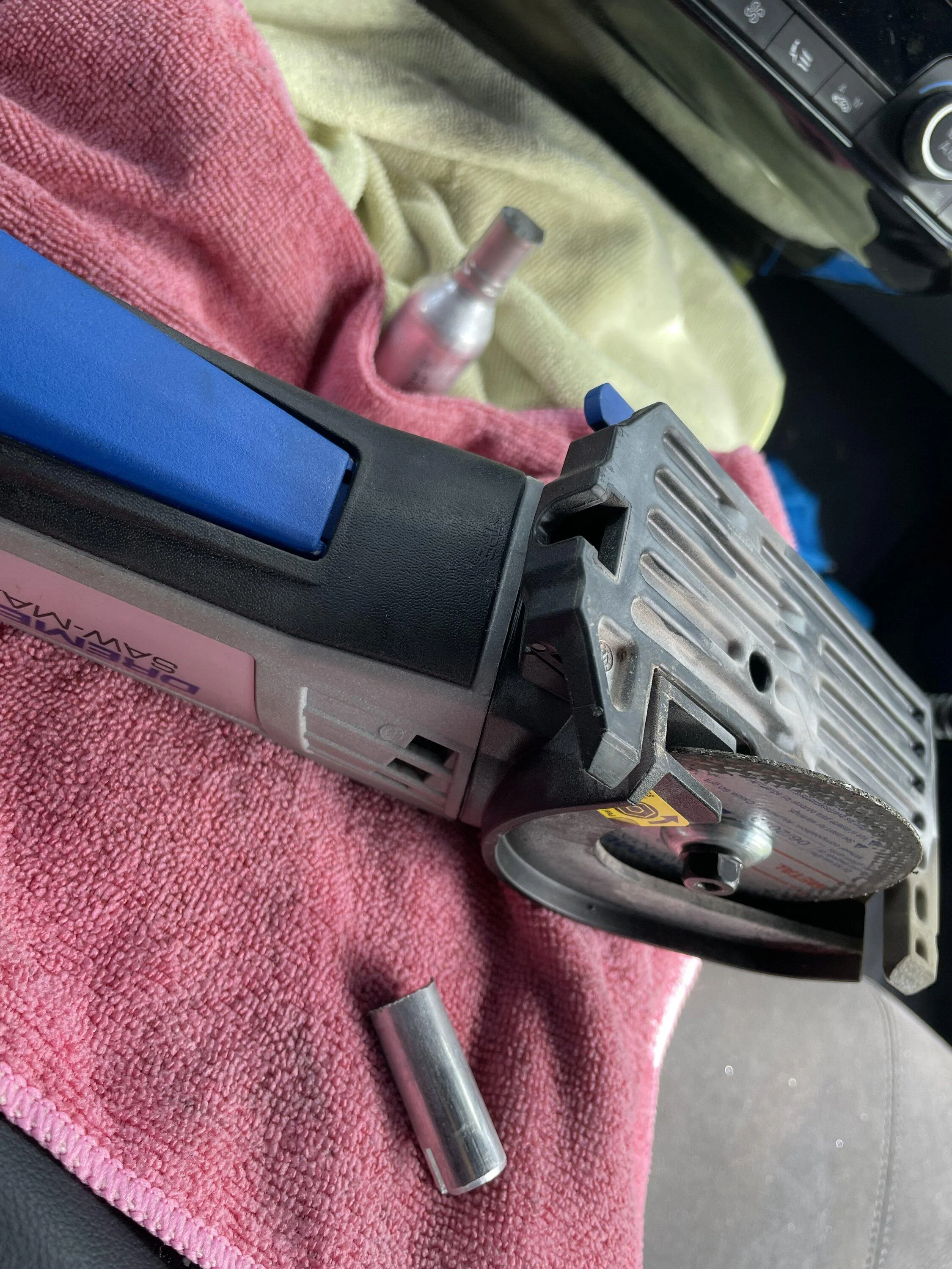

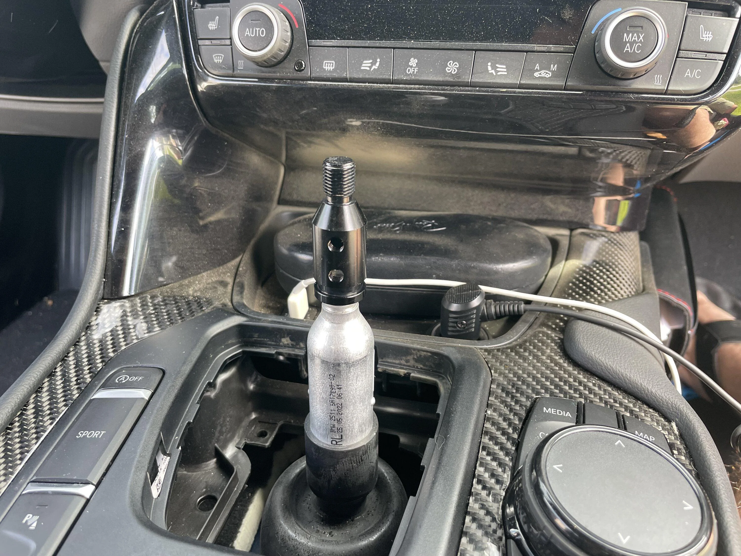

not going to be everyone’s cup of tea….
i am saving to order the Raceseng adapter, shift boot collar and knob. In the meantime, I got bored and prime one dayed a cheap knob and knob adapter got to work. Since I didnt have a boot collar i cut and repurposed a piece i had lying around from my hsk bov kit to use as a collar.
It’ll do for now
It’ll do for now
I think you dun goofed, because what you cut off is where the Raceseng adapter attaches.
It’ll do for now
Uhhhhhhhhhh lol
No goof here. Raceseng makes all sorts of adapters. The NTA one has a screw up top and at the bottom from the pics ive seen. If the ID of the adapter slips over and holds using the bottom screw itll be fine. I cut it purposely to lower the height. Its not lower at the moment because i have that collar on but could go lower with this temp set up without the collar. I have thread locker on so not going to take it apart to show what i mean. Ill post pics when i have my final set up done

Uhhhhhhhhhh lol
sharocks, if you had followed through on your ssk shifter you mentioned like 6 months ago, I wouldnt feel the need to get crafty, lol jk
It’ll do for now
The color looks neat with the all black interior.
The Raceseng NTA should be able to catch all 4 screws without issues with the amount you left on there but I would suggest you keep the piece that was cut. The NTA threads for the knob may collapse a bit if that is left hollow so you can just put it back to add some strength back in there.

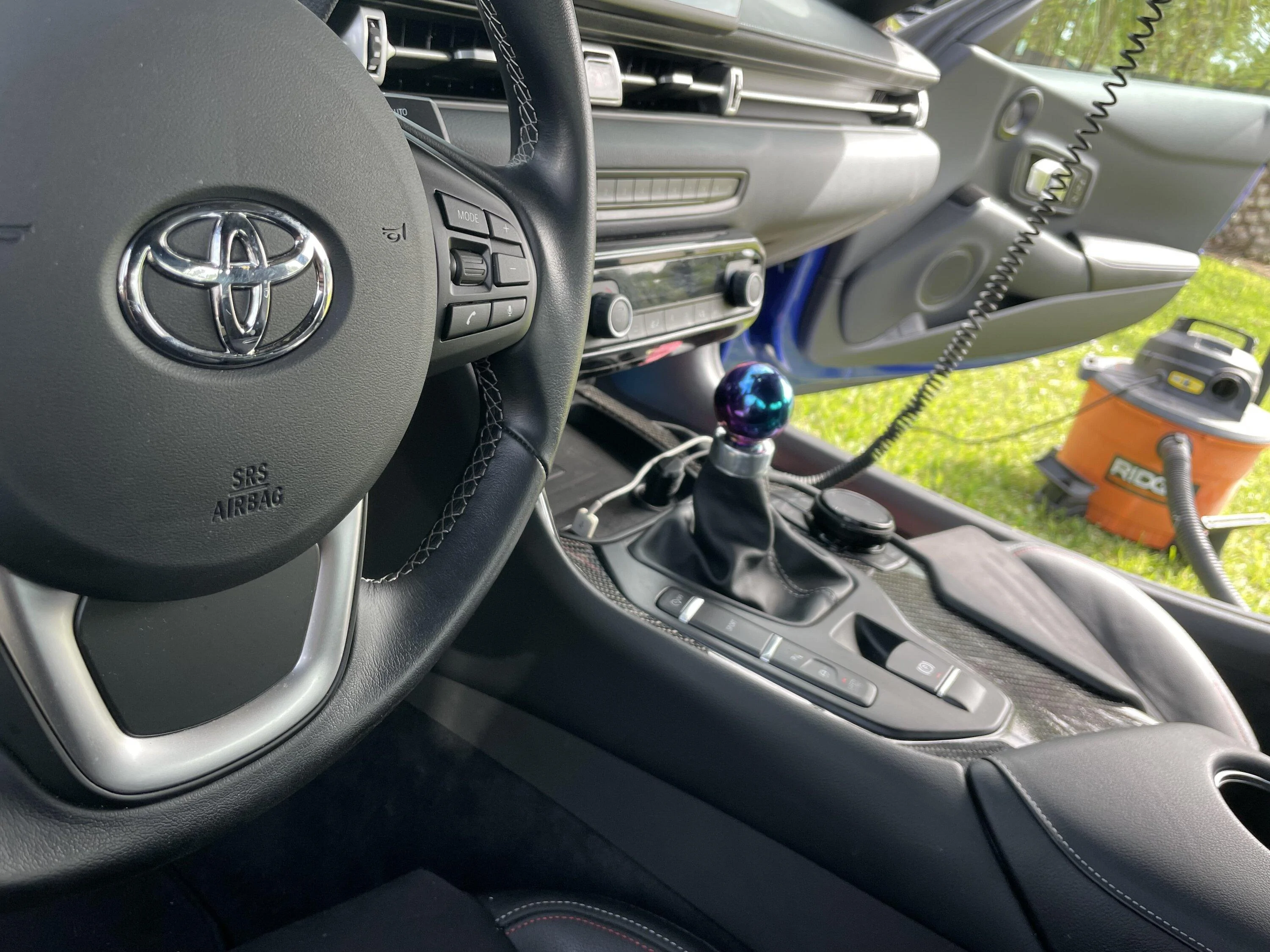

Might be my favorite mod yet
Woah you’re the first person I’ve seen that has RAISED the height of the knob! Interesting! Not my style but if it works for you, that’s cool!
Yeah I wasn't too sure at first but wanted to give it a try. After a few days feels completely normal and I dig it! Also really easy to just take the extender off lol
