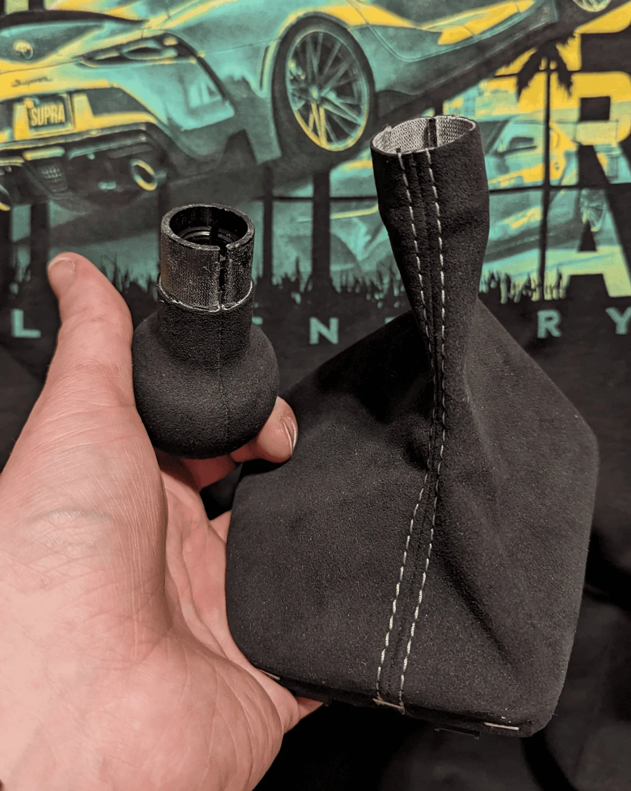

For those of you that did this modification, how do you get the boot out? From your pictures, it looks like 2 tabs on each side but do you just pull the boot out of the console or do you have to use a trim removal tool? I’m having a hard time taking mine out for some reason. My other cars were easy.
FuzzyRev
RT
Aug 4, 2021
2,063
3,977
Wisconsin
Just pull. It easily pops right out.

You can also just pull up on the boot to unlatch it first. That should help you expose the groove on the knob (under the leather) so that you can pry it open a bit and make it easier to remove. Not sure which direction it's pointing but at that point you can just rotate it to make it more accessible.
@FuzzyRev85 posted a neat pic that shows the groove.
FuzzyRev
RT
Aug 4, 2021
2,063
3,977
Wisconsin
So glad my advice can help folks out ?.
The grove is facing forwards, towards the dash.

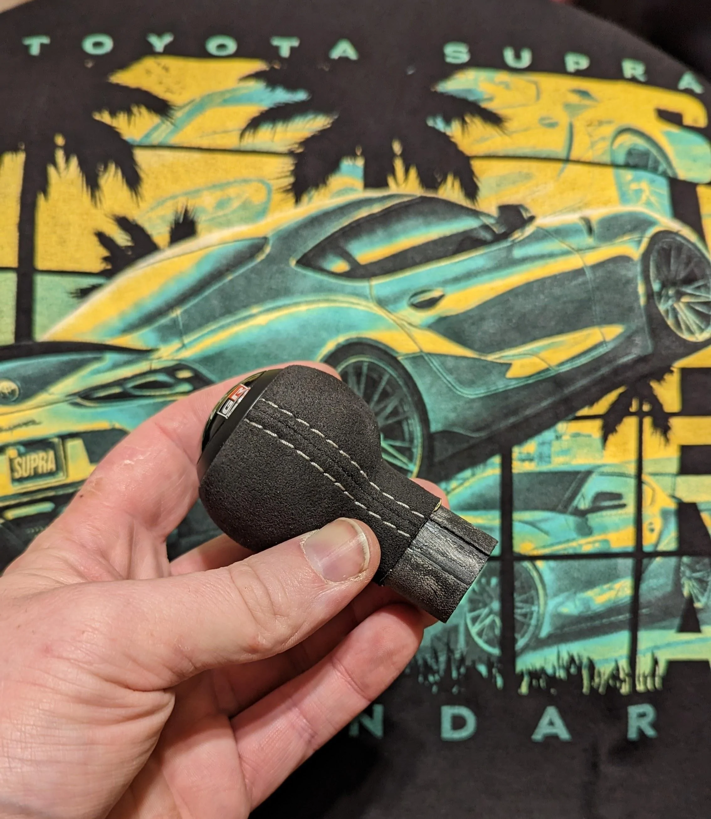

Awesome, thanks guys! Did you do anything with the threads once the material was cut to prevent them from coming out? Like hot glue or anything?
I didn't since it still has factory glue and isn't fraying.
Nope. Just left it with the dried up glue it had from the factory. Since I ended up using a zip tie to attach the boot to the adapter that pretty much kept everything held together. Just try to make a clean cut as best as you can.

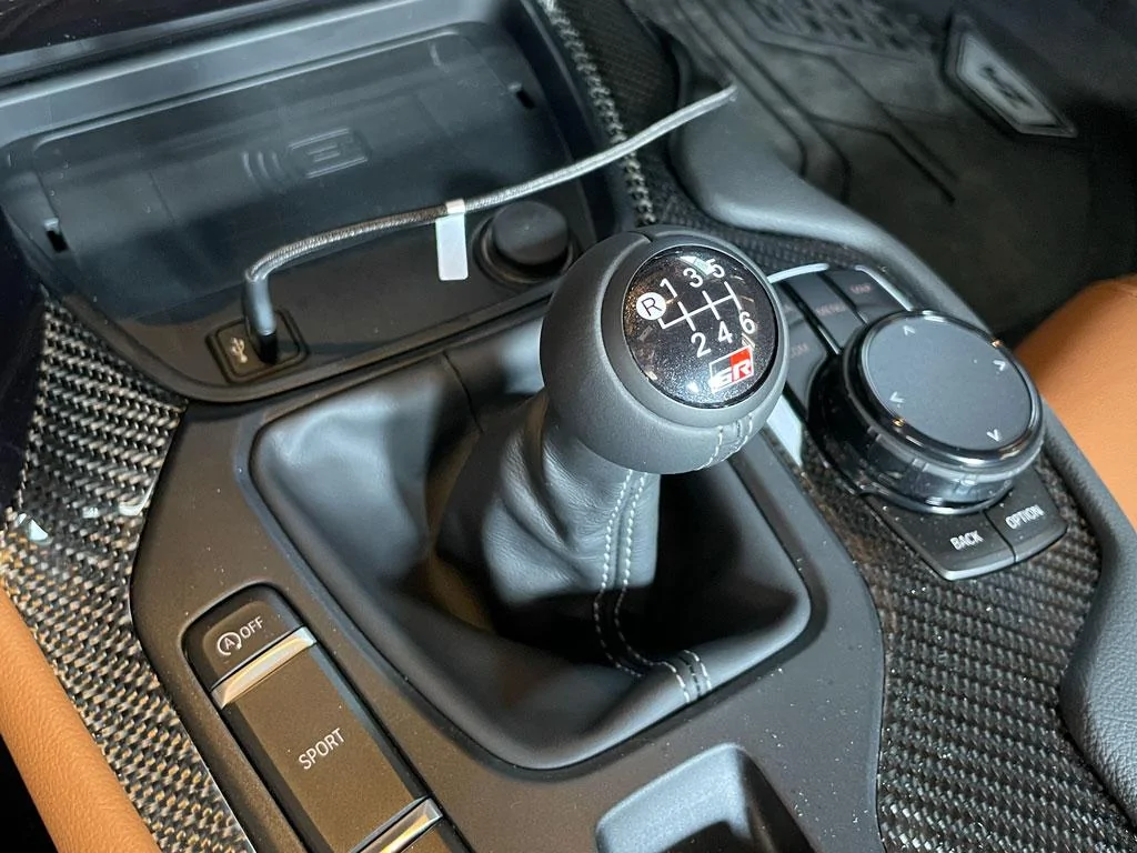

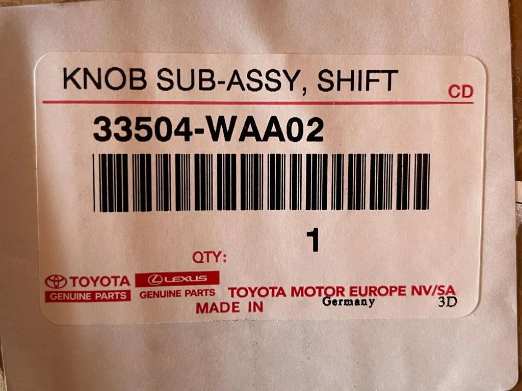

Getting this thread back on track, the part number for the non-alcantara shift knob and boot is 33504-WAA02 - at least according to my local Toyota dealership. It's on backorder. I placed a backorder, we'll see how long it takes.
Finally received my replacement knob/boot yesterday. About a 45 second swap with no tools.
The part number I found was correct for the smooth-leather version (I wanted to get rid of the alcantara one from day one.)

Thank you for the PN.
