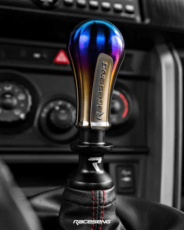

Raceseng has some titanium options and I can at least confirm that those would fit thanks to all of them using the same adapter. They might offer something similar in style to what you specifically are interested in, I'm just not into whole titanium fad and paying twice as much for the same thing.

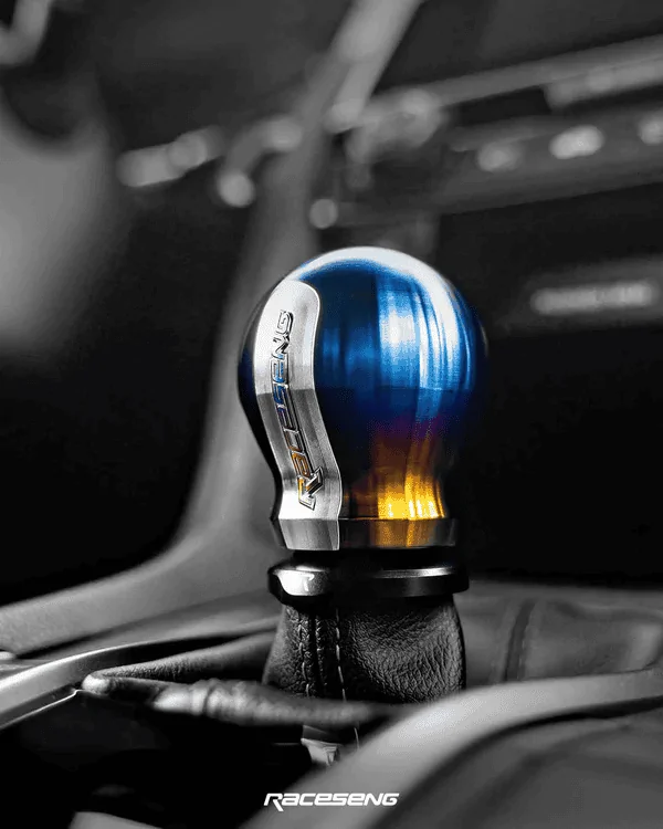

I think that all of the shift knobs that have been posted here are heavier than the stock (200g). My red Nitro is about 317.5g as reference and it definitely smoothed shifts from 2-3 a fair bit. The titanium models below have the same weight as mine. These also probably the closest ones to the ARC models I was able find online.

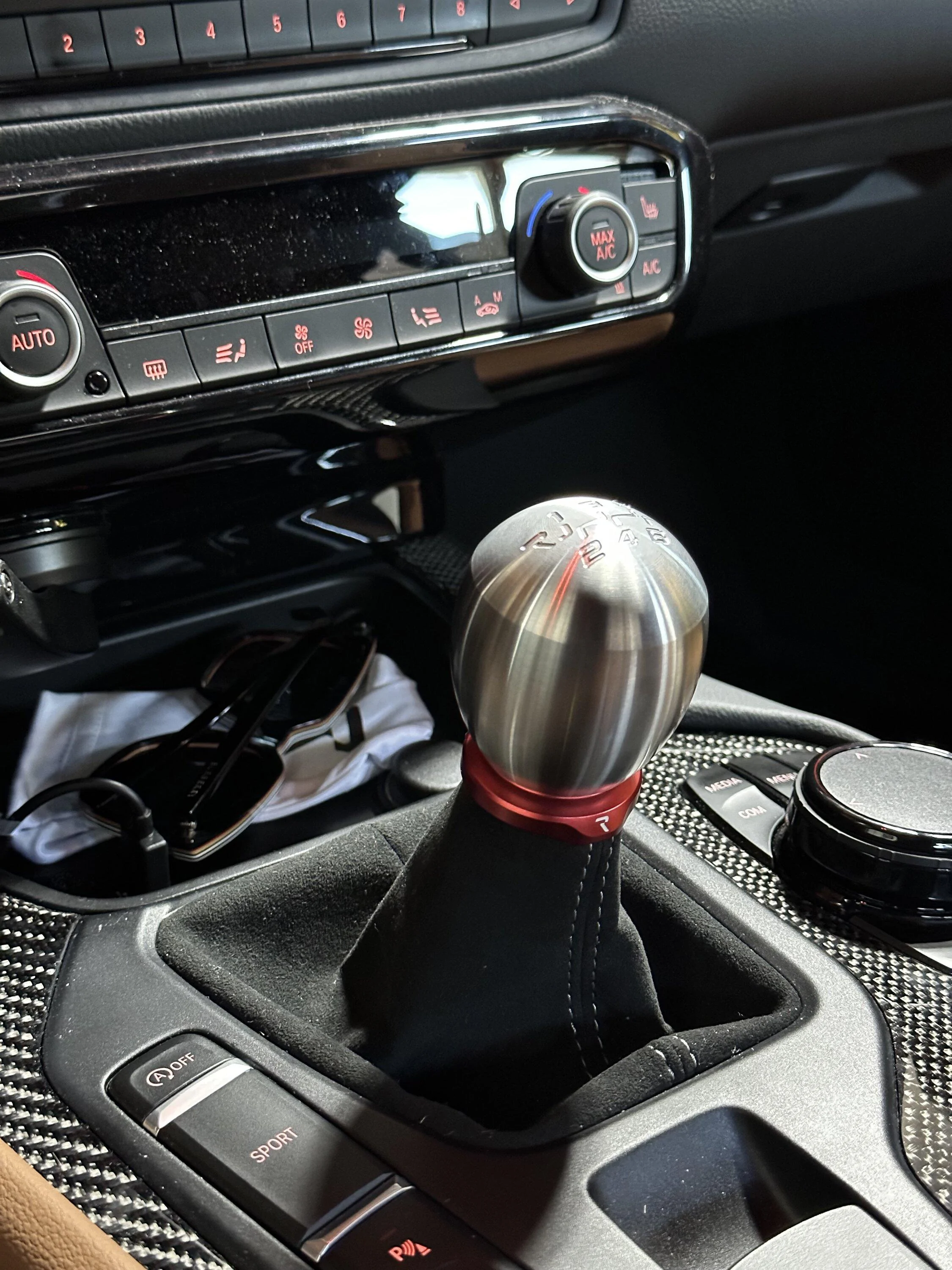

Hi all,

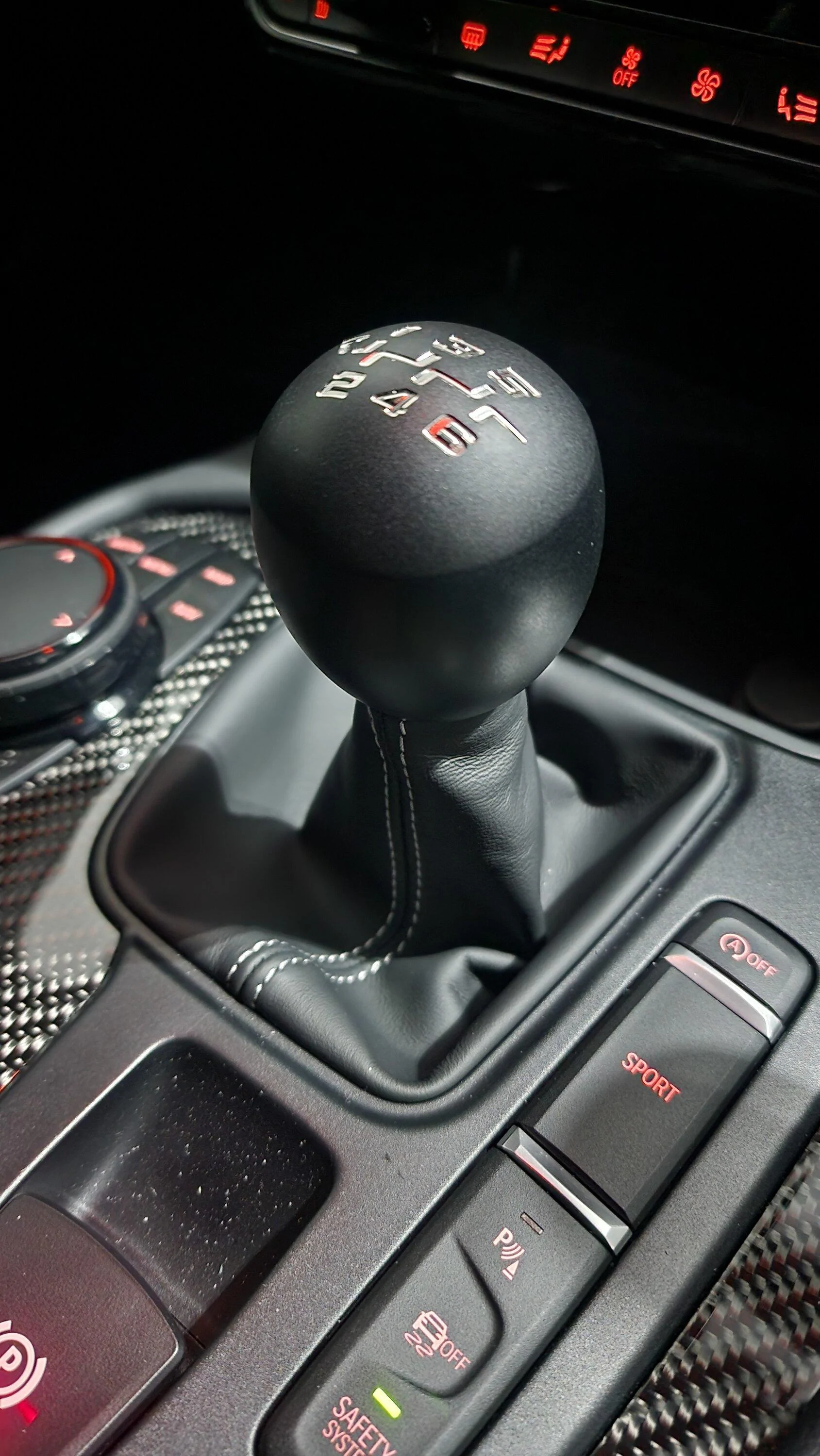

Just wanted to say thanks to everyone on this thread, I was confident enough to complete the shift swap over and the cutting of the stock shift boot. Lucky I read where to cut.
I went down the Raceseng path and I absolutely love the feel and the look of the shift knob.

Looks great! That pic hurt my head a bit until I realized the car must be RHD.

i thought I posted in here guess not, more pics in my build thread

I should have got that collar at the same time, now the item and the shipping cost is more than the item ahahha

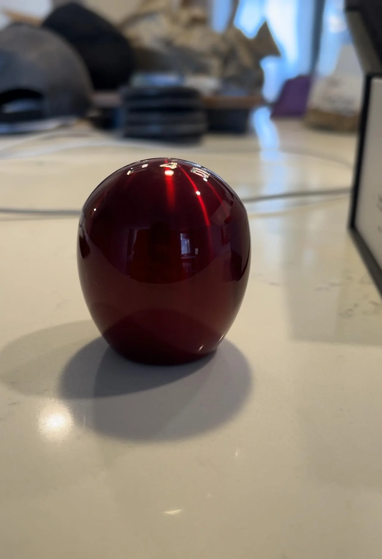

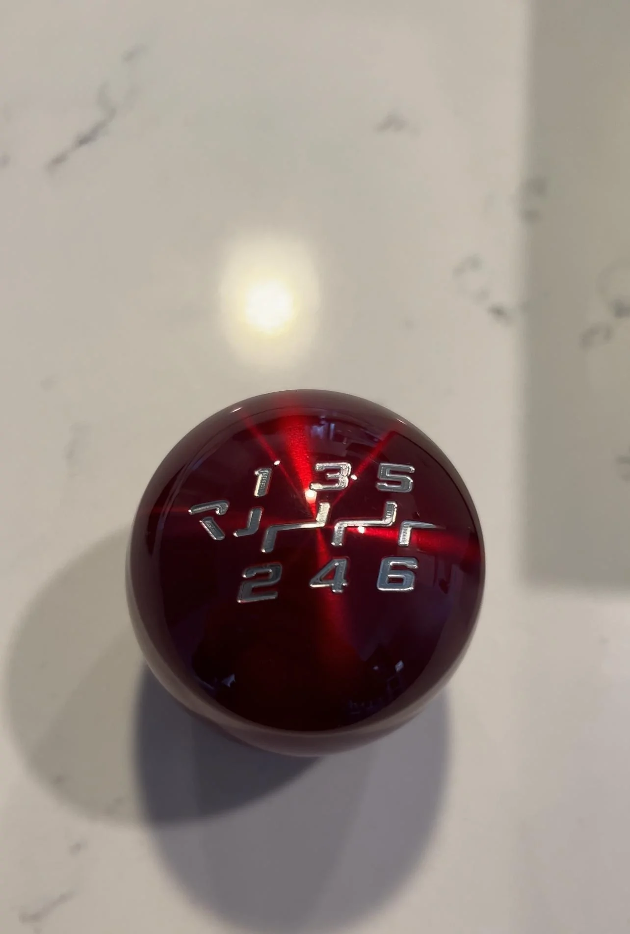

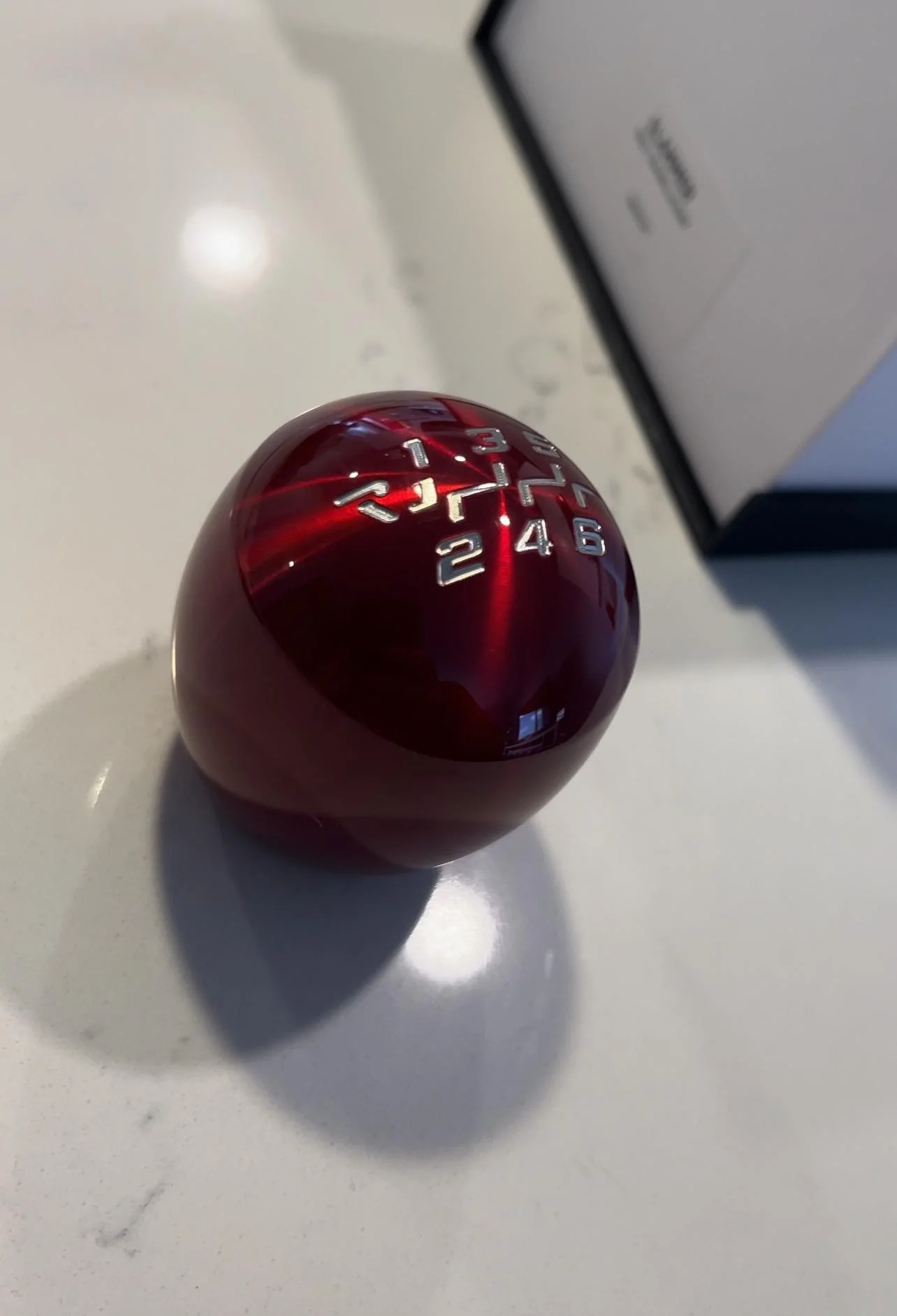

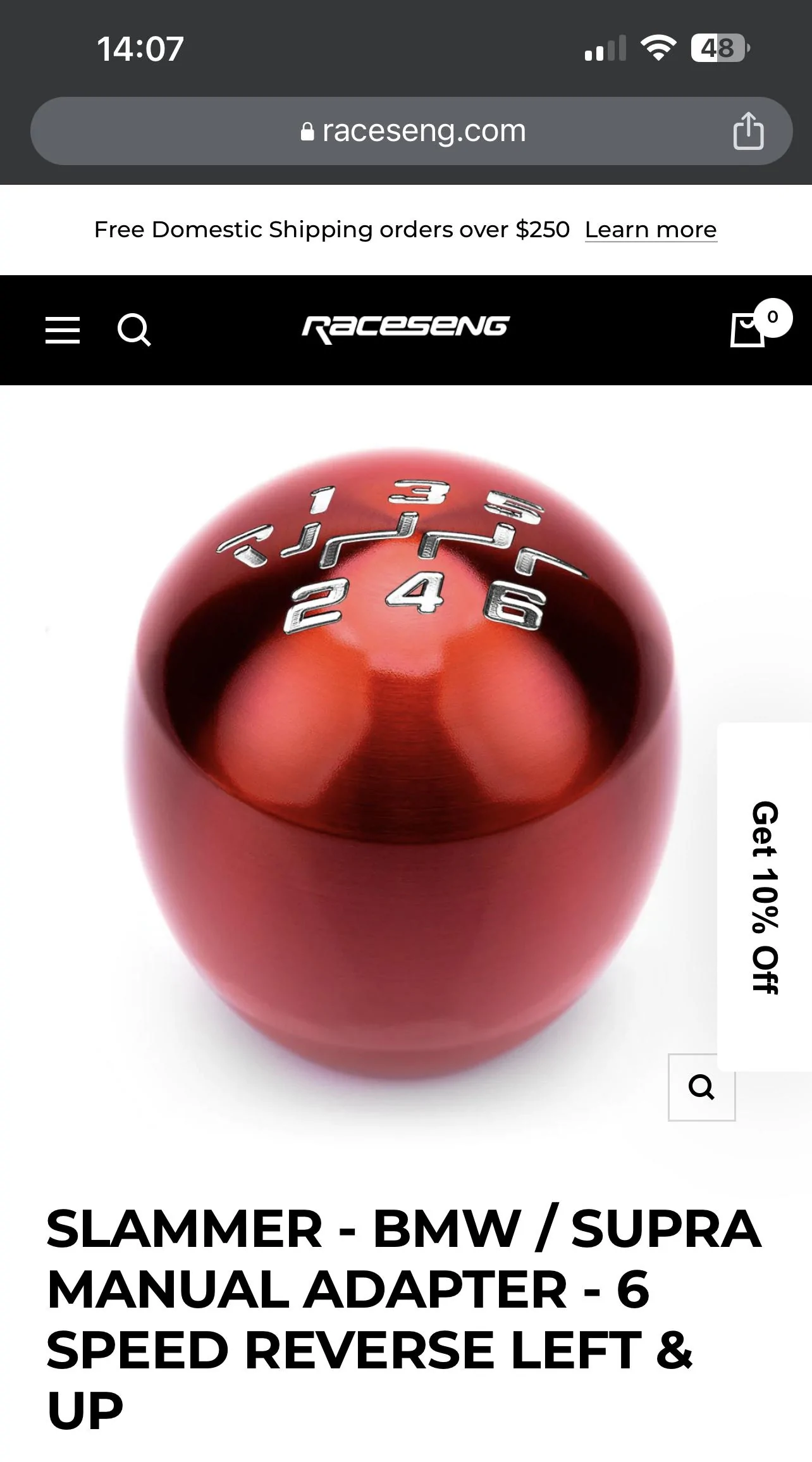

I don’t even have the car yet as it is getting delivered today to a dealership out of state that I’ll have to travel to next week to pick up, but…I already got this crown jewel in the mail ?? Raceseng Slammer, same as Ryan & Andy but in brushed translucent red—635 grams of 6 speed shifting sweetness (say that 5 times fast ?). And with the black collar as well. As you can see, the red is way more “candy-like” in person than the image on their website represents which I’m a big fan of. And the weight is phenomenal compared to other shift knobs I’ve had in the past.

Congrats! Your shifting experience from day one will be amazing!
? yeah more translucent red!!! You're gonna love it. Not too bright that you can spot it from a mile away but also subtle enough to change things up in the interior. Even with my tan interior it doesn't really look out of place because of all the illumination being red as well.
