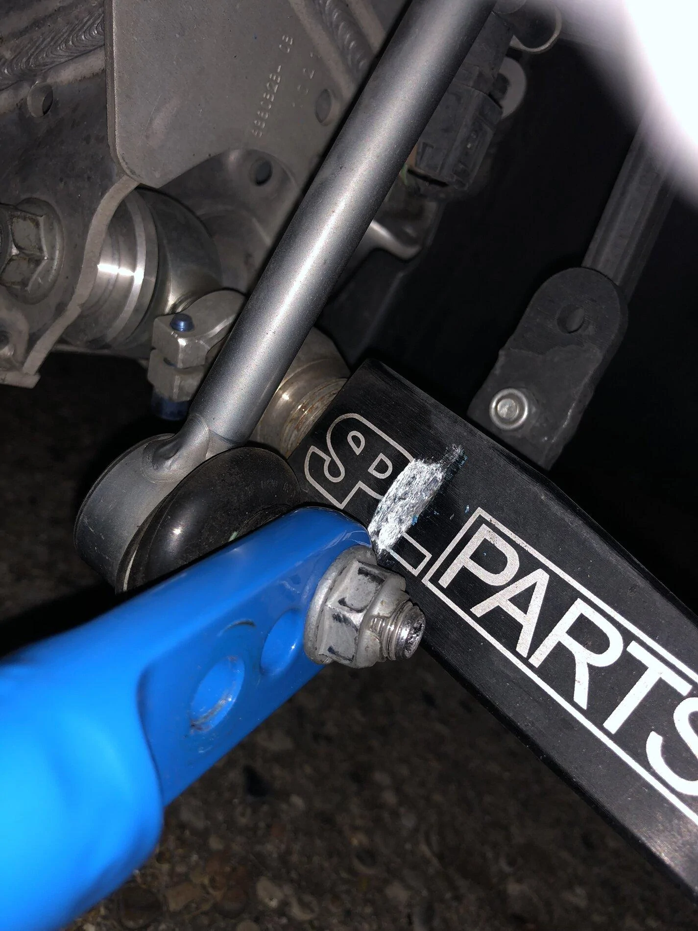

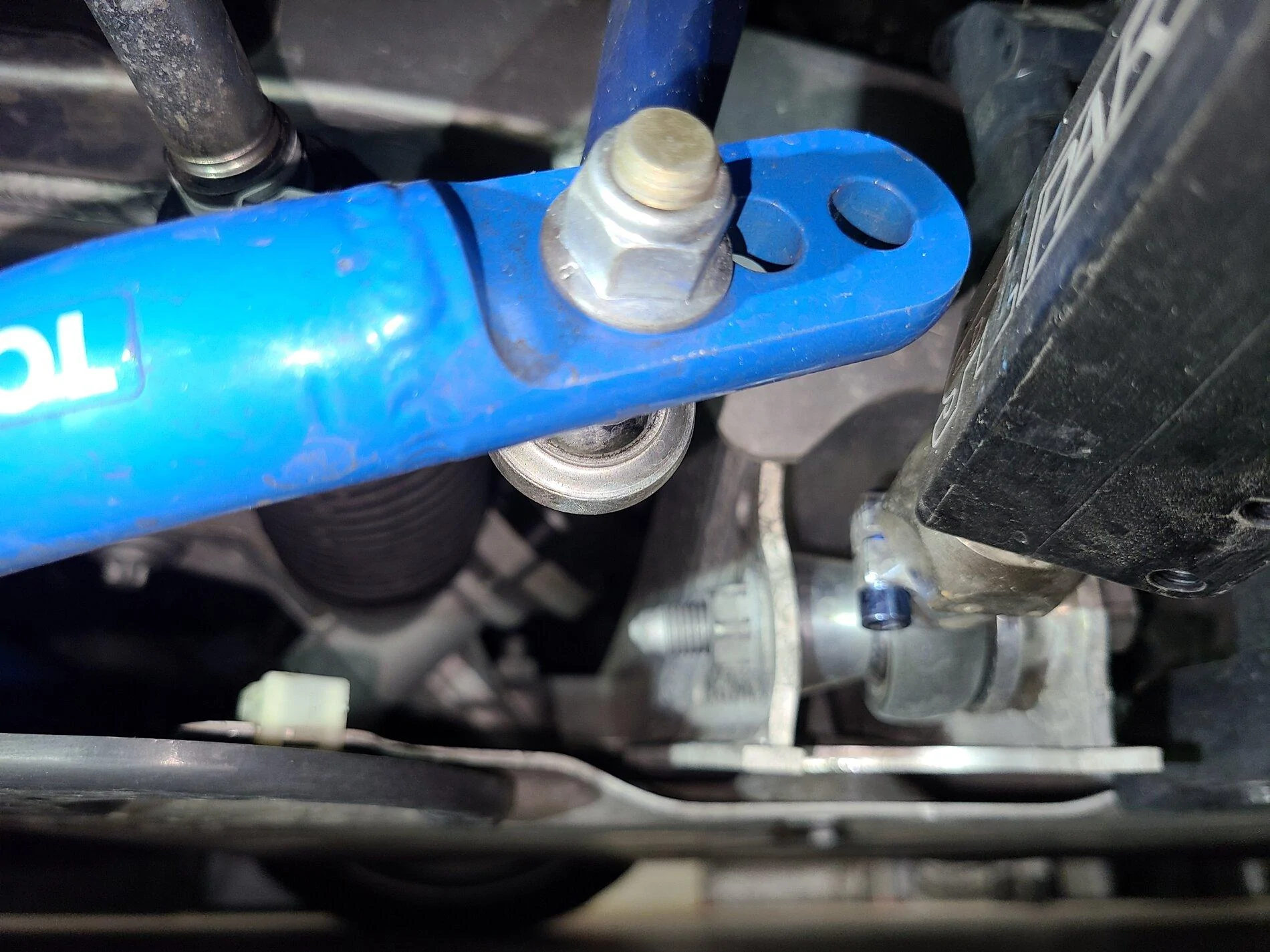

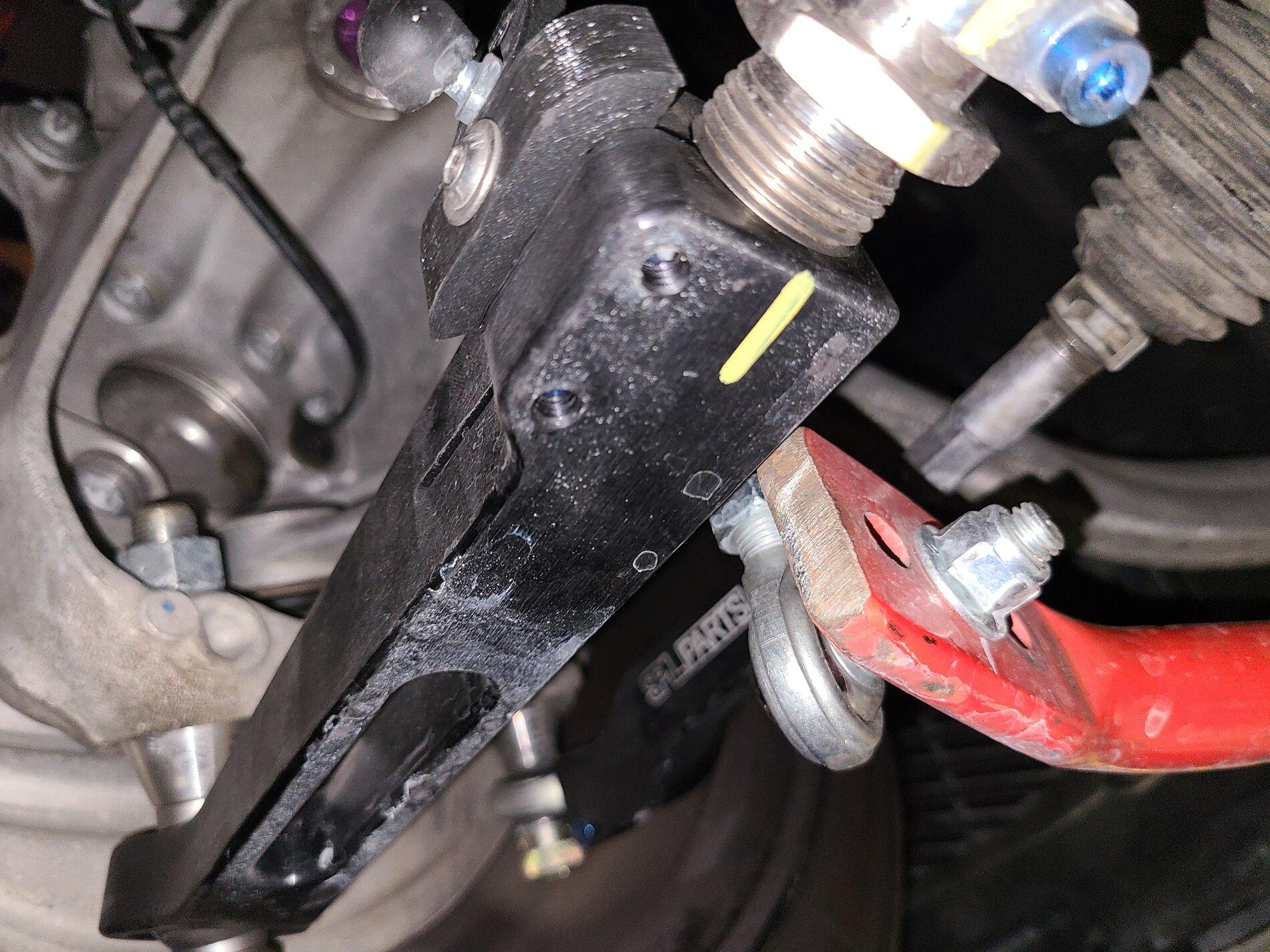

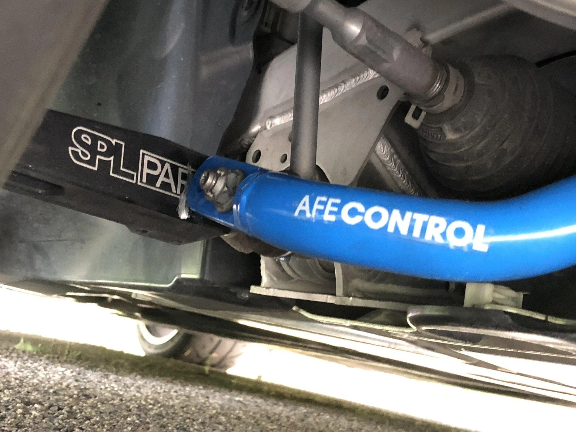

@Msoupe fyi I just installed the aFe front sway bar and it rubs more than the OEM front sway bar. Iā€™ll have to get adjustable end links either way. I could have gone Eibach and saved a few dollars. Probably wouldā€™ve rubbed just as much.
Photos of left and right attached.

Did you mount the sway bar bushings as far forward as possible? I noticed mine slightly contacted the arms until I loosened the bushing brackets, shifted the bar all the way forward, then tightened the bushing brackets. Are you on the soft setting or stiff setting? Your first picture shows stiff and the other shows soft.
My bar is adjusted to the stiffest setting, so the end link is angled forward which rotates the bar slightly up and away from the arm too. I usually keep my front on the stiff setting. My end links are adjusted close to stock length. Adjusting the end links shorter could help if using the soft setting on the bar.

Grinding the edges down on the Eibach sway bar ends seems like the typical solution to clear the SPL arms.

Itā€™s on the stiffest setting (one photo was taken on the softest setting but has since been changed) and you know what, I didnā€™t even think about sliding it all the way forward and then tightening. Iā€™m sure that wouldā€™ve helped.
Not sure if Iā€™ll even want or need to now, as I have already ordered the end links and theyā€™ll be in this week. I have a track day in approximately 8 hours and need to sleep so Iā€™ll have to run with it as it is.
Thanks for the tips!
