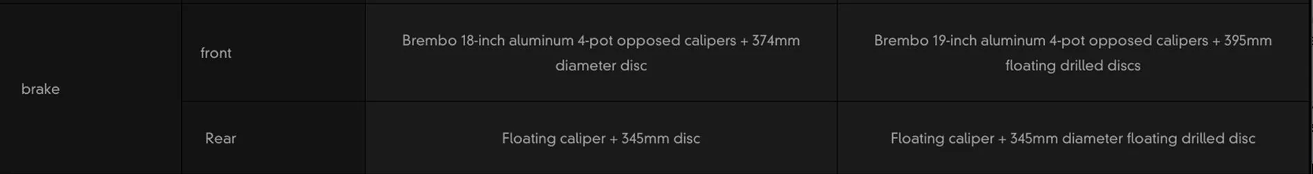

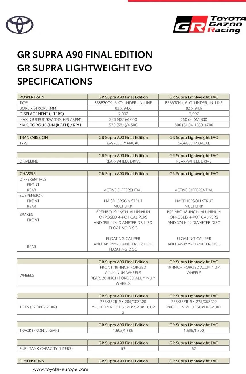

3. ZTK M340i front brakes
M240/M340/M440 get the same brakes as our current supras, 348mm front.
M240/M340/M440 get the 374mm brake upgrade with the ZTK cooling package, which is what the normal update to the supra is getting (non FE)
FE is getting the 395mm brake upgrade, which is the "M performance" kit.
With either brakes, you are basically stuck with 19" or larger wheels. You might be able to find some 18 that fit over the 374mm brakes.
yup! missed that. I think the 395 m performance kit is option to 5 series, perhap we will be able to get 395 from a 5 series but also fitted properly with new abs coding from the new supras, I know it was a concern with brake balance in the other threads that were discussing oem bmw brakes. ZTK calipers don't have as much pad options, maybe m performance 395 calipers have more choices?
All these are parts bin items. You can find the 395mm rotors/calipers on the X5 m40i, X7 m40i, 7 series, M540i, M550i
No coding needed. the pistons themselves aren't much bigger. it's more about the thermal capacity of the larger rotors, brake pads and calipers.

I’m curious to know if the partially upgraded Supra is just the stock 3.0 - for context, in Australia we only get the 3.0, but it comes as a base model and as a premium model - with slight changes to rims, HUD and rims.
has anyone worked out where the partially upgraded version applies to both classes of the 3.0?
interestingly, toyota EU says it will be rolled out across NA, Australia and Europe.
it’s 4 am here and I can’t sleep because I’m so excited.
That’s the EVO edition.
They’re releasing 2 limited edition models.
