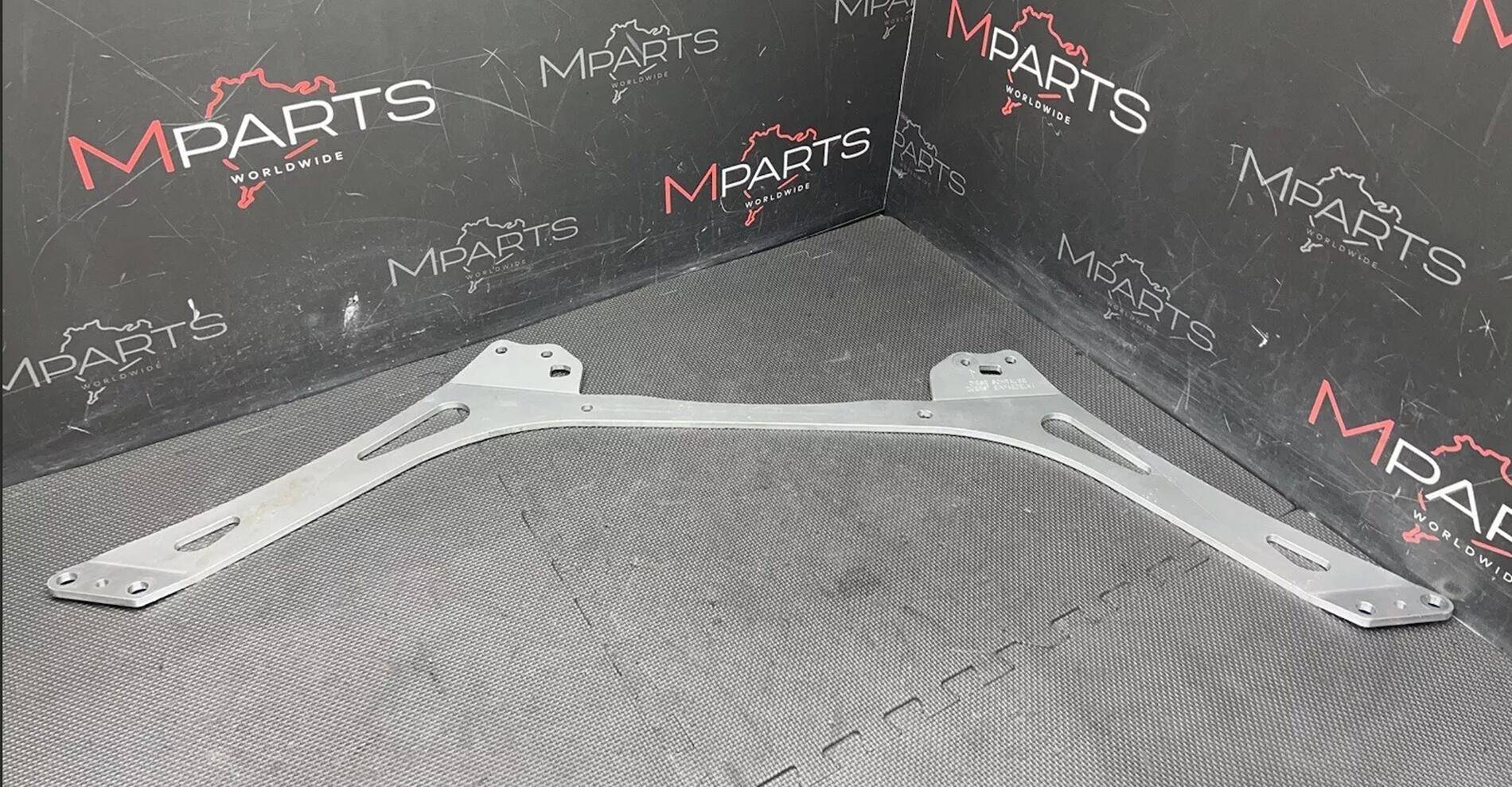

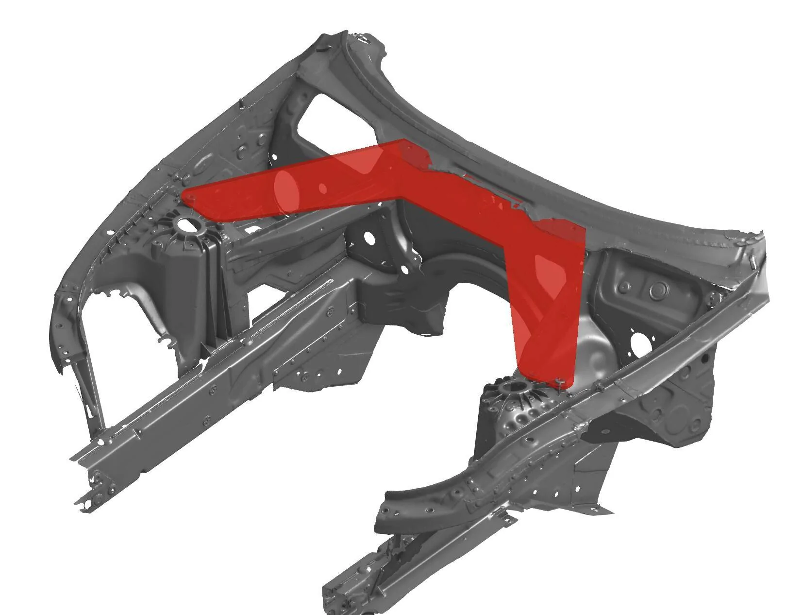

Did you guys see that they replaced this engine brace with a thicker machined piece for more rigidity?
-RJM
seems like I was the only one that noticed during the initial press release that the aftermarket hasn't done dick
upgraded front cowl brace is interesting. as far as I know, no aftermarket pieces exist for those.
-RJM
It might be using the brace that comes on the M cars. A lot of the M340i guys upgrade to it. I always wondered if it fit the Supra.
Part #8075012

Looking really close, the slots on the M one have more rounded corners. So while the M still might fit, they're probably not the same part number
edit, some additional sleuthing, it looks like the supra brace and the g20 braces dont use the same stampings. they probably would have used the same part number if it were possible, I think this is a clue that the holes are different

Yeah, maybe it’s an illusion from the picture but it looks like the center to center at the aft end is different.

yeah, and aside from the missing square hole, the supra bar seems to have a sharper kink right next to the green text
